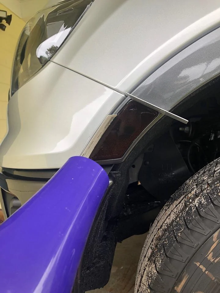

I'm certainly no expert on this but read through this thread and decided to hit Walmart for some 20% tint (priced at just under $10). Traced over the light shape with paper and pencil and transferred that to cardboard to make a stencil - going a little bit wider than the light to allow for slight wrapping. It took a couple tries but I was able to get both on without removing the light - because I'm lazy. I used a credit card to tuck the edges around while applying heat with a hair dryer. I didn't do the best on applying it but it looks great unless you really lean down and inspect it.

Nice!! I think after a few walk-bys you'll probably end up redoing it just for the sake of it because removing the lamp is super easy. :sunglasses:
Agreed. I just got it yesterday and can't stand the orange. I bet it'll last a week or so until I pop 'em off and do it right..:LOL:
