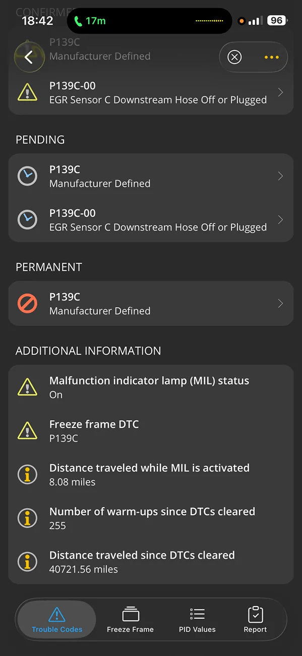

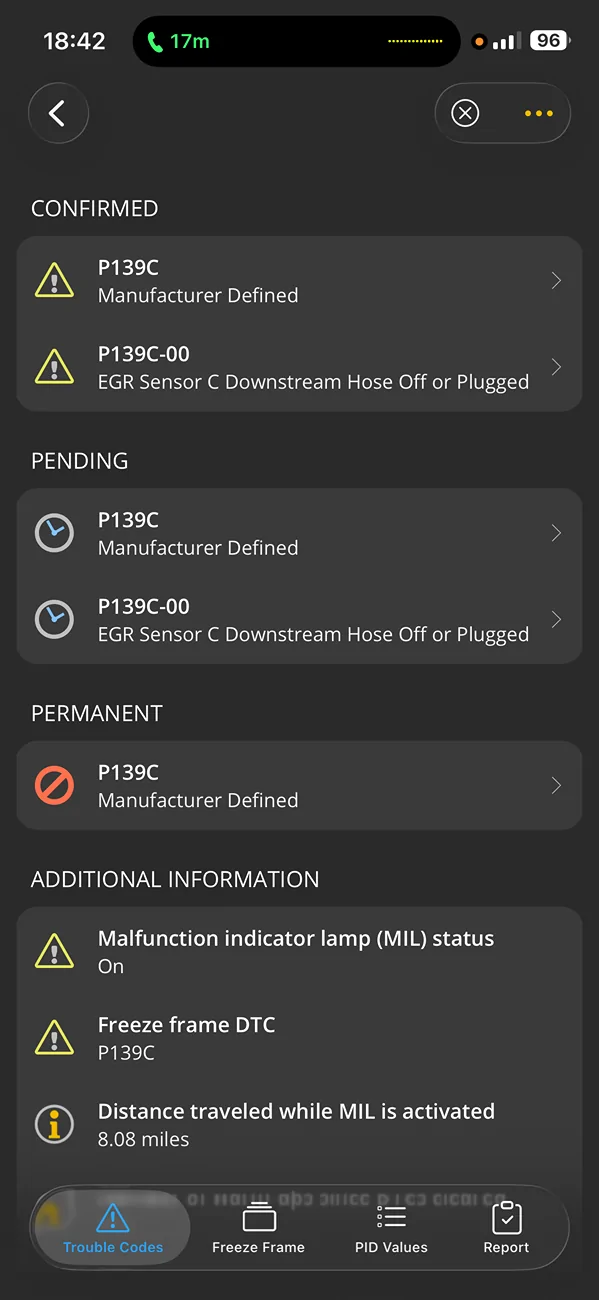

Been having the “bucking and surging “ symptoms last month or so, same as a few years ago.
I figured it was the DPFE part that needs to be replaced (again). This time it threw a CEL on me.
I ran a scan and this is what it showed. Truck runs fine at highway speeds, no power lose. All the same symptoms and complaints we’ve all had related to this part.
Just want to confirm these codes are related to DPFE part.

Yes, P139C is related to the EGR DPFE sensor. It states that a hose is off or plugged to the sensor. Have you checked for that?

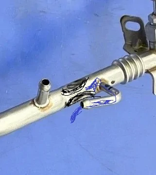

I have dug deep into the whole EGR System, and put together a detailed overview of it - have not had a chance to finalize it - busy with summer projects (Full Kitchen Remodel) but here is a excerpt of my project which is currently @ 80 pages

P139C –Possible Causes
  • DPFE Sensor – internal bias failure (moisture)
  • DPFE Sensor – internal diaphragm damage
  • DPFE Sensor – electrical fault
  • High Pressure Hose / Port – restriction – blockage
  • Low Pressure Hose – leaking
Being you don't have the whole doc yet
Learned Zero = What the PCM sees as (Zero Pressure or No EGR Flow)
and what usually triggers it is (Moisture Build Up) in the EGR Tube itself , creating an offset off pressure readings - that eventually ends up destroying the internal senor
Its seeing a pressure imbalance - here, and the blue represents the moisture backup that makes its way to the DPFE sensor itself.
The (Black) lines in the tube represent the internal orifice inside the tube
Sorry I do not have the full document quite ready yet , i kina dropped the ball on it when my old laptops hard-drive crapped out

And just like that, the CEL went out last night and has been off since then.
I am going to replace the part either way.
