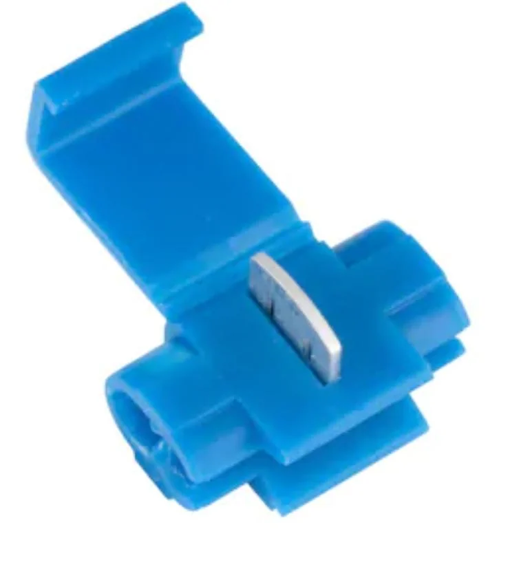

I used 2 of these to tap into the + &- so I didn't have to cut off the oem plug in case I wanted to change back.
That's easy enough. I've got a bunch of those in my shop.................somewhere. :)

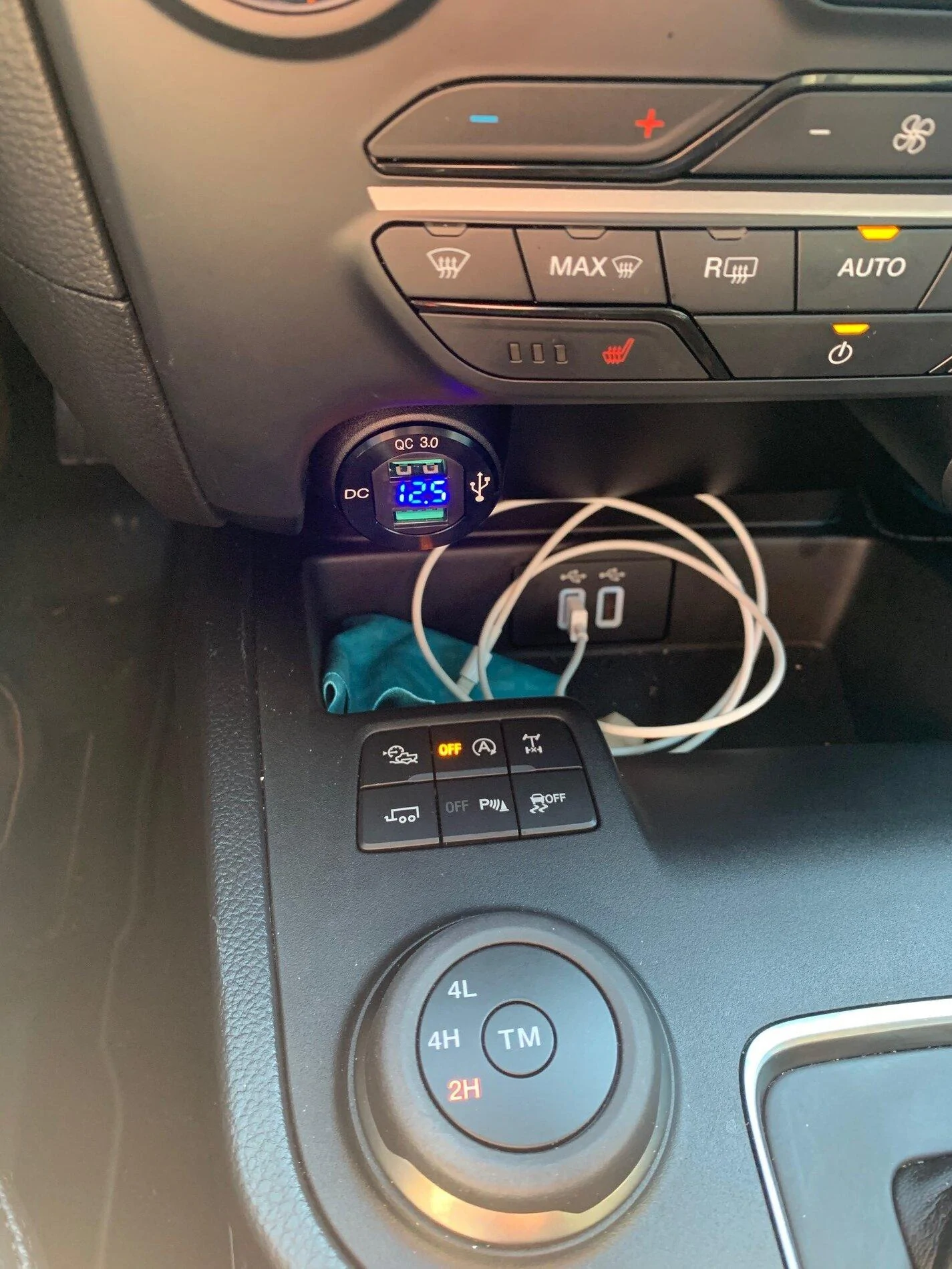

I also just added a dual USB port in place of a 12 volt. I went ahead and soldered the connections so I did not have to use a tap or cut off the factory connector. Tessa taped everything up. Works great.
