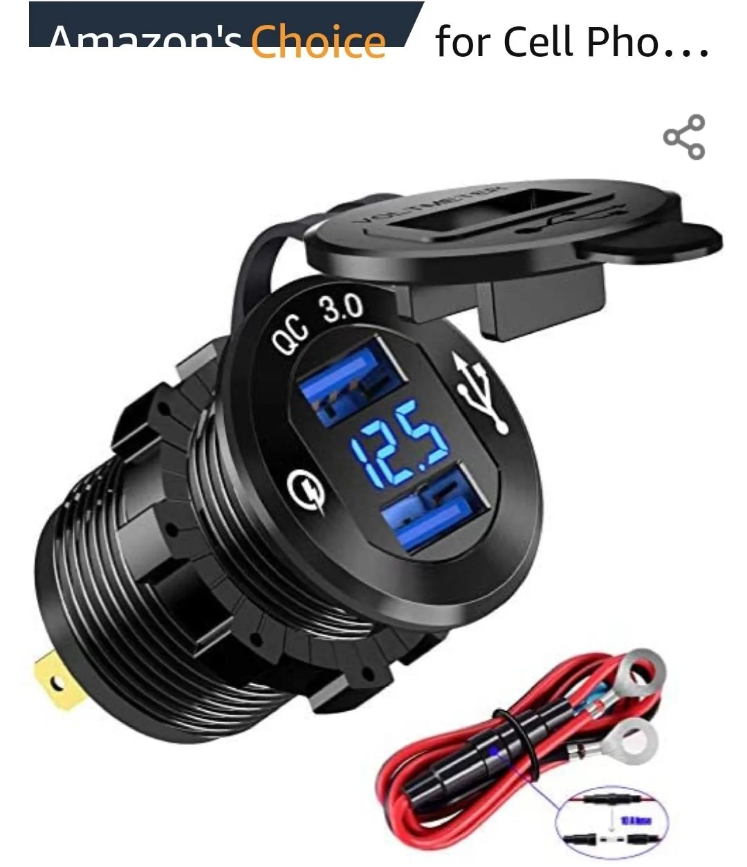

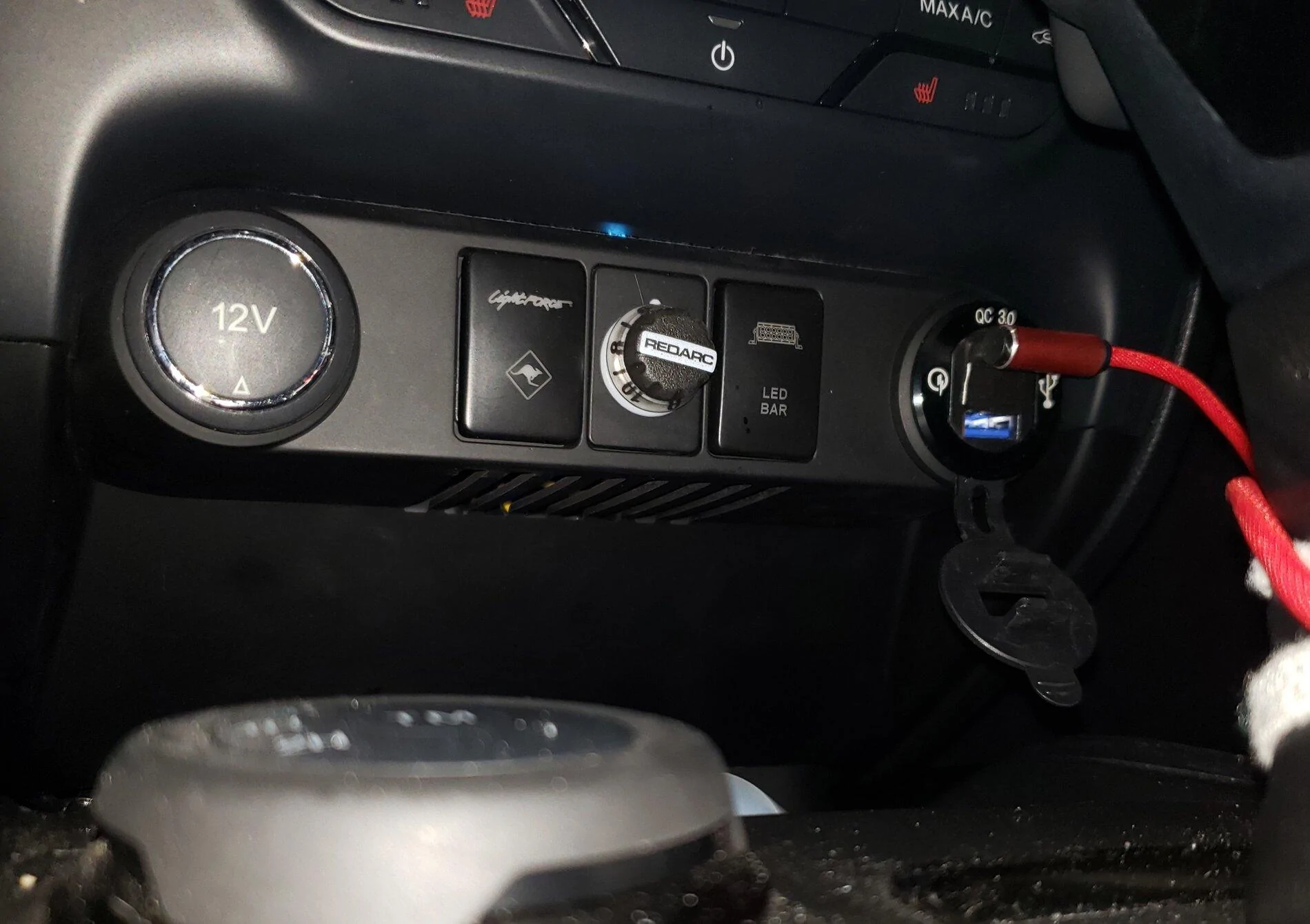

When I replaced the fascia with Lightforce I swapped out one of my 12 volt plug ins with this - https://www.amazon.com/dp/B07FXH5ZZK/ref=cm_sw_r_cp_apa_fabc_XbjeGbWEYD6A8?_encoding=UTF8&psc=1

I just used the plugin adapter like I listed so I don't lose the outlet as well. I see no need to wire in something. (I have the base radio).

Is that a plug, and play thingy there Mike? Or, is there wiring to be run?
I used 2 of these to tap into the + &- so I didn't have to cut off the oem plug in case I wanted to change back.
I would never ever use these things in my truck! Worst invention for wiring ever made. Poor connections and damages original wiring.

Only good for charging, no data connection whatsoever.
Correct, since the op didn't say which he wanted, I merely showed the USB charger I opted for. The USB port on the truck doesn't charge very fast and I don't care for the android app vs sync, there may come a time when it's handy but for now I don't use it.
To each his own, I've not had a problem with them when used. It's taped and isn't in a location to work loose.
Your truck.
