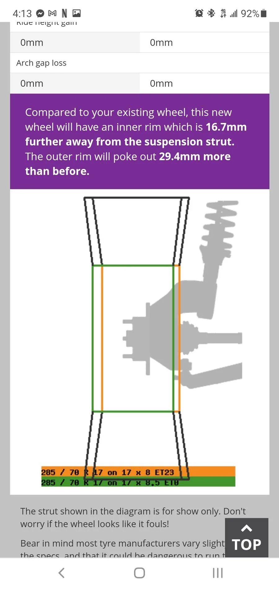

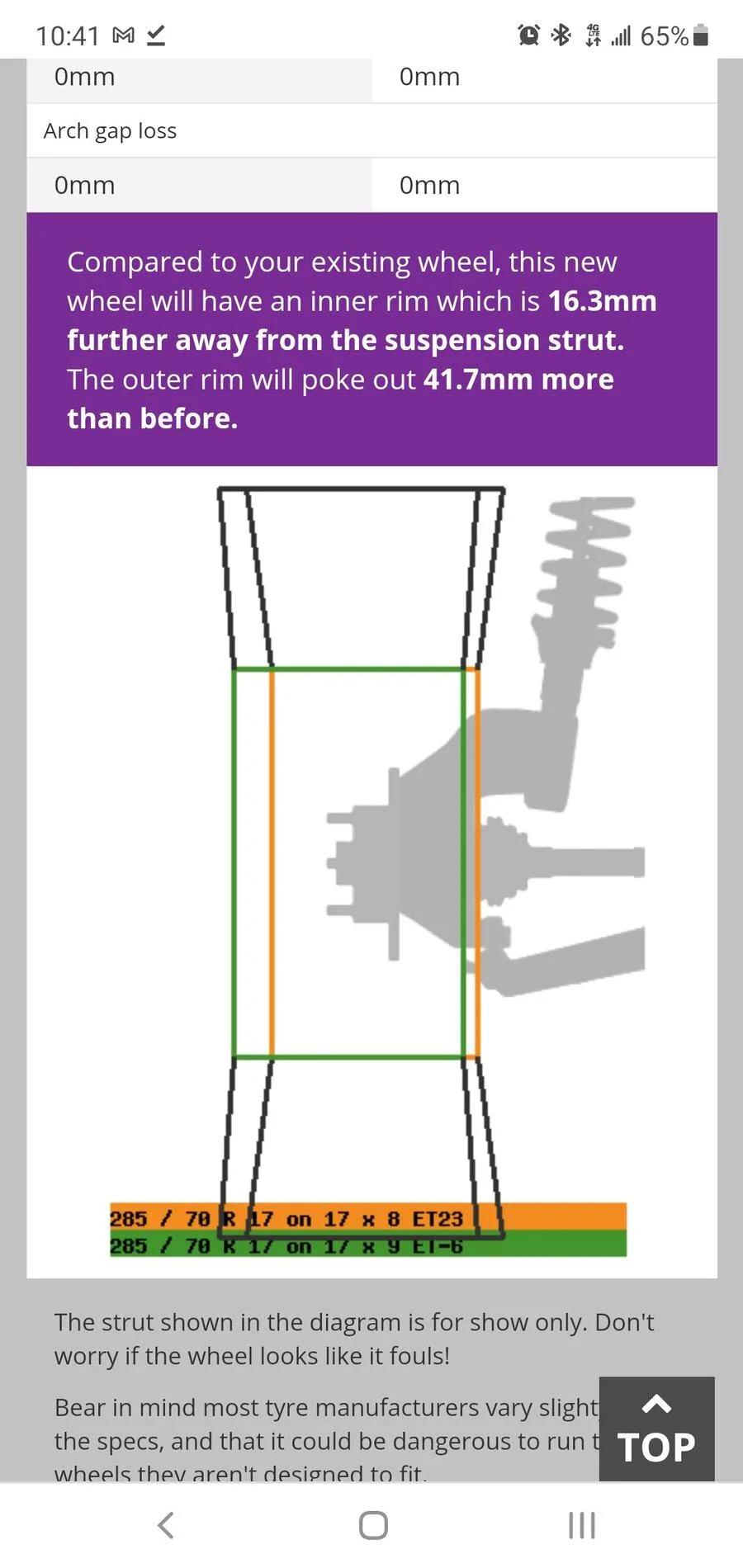

Here is my setup I "want" to buy vs yours. So my setup would stick out less by .46" so about a half inch more inside the wheel wells. ? I think it might not be that bad after all.
Maybe a 265/70/17 or 275/70/17 will tuck in more also?

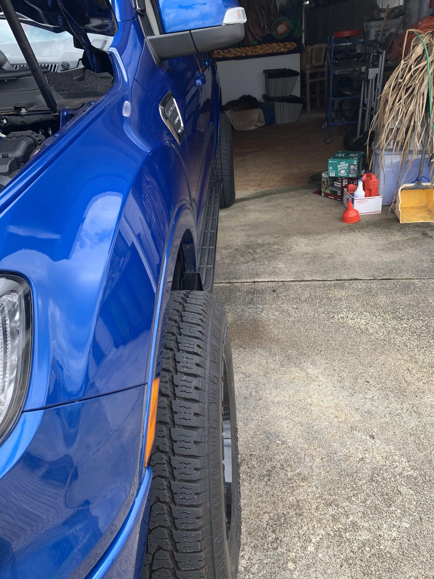

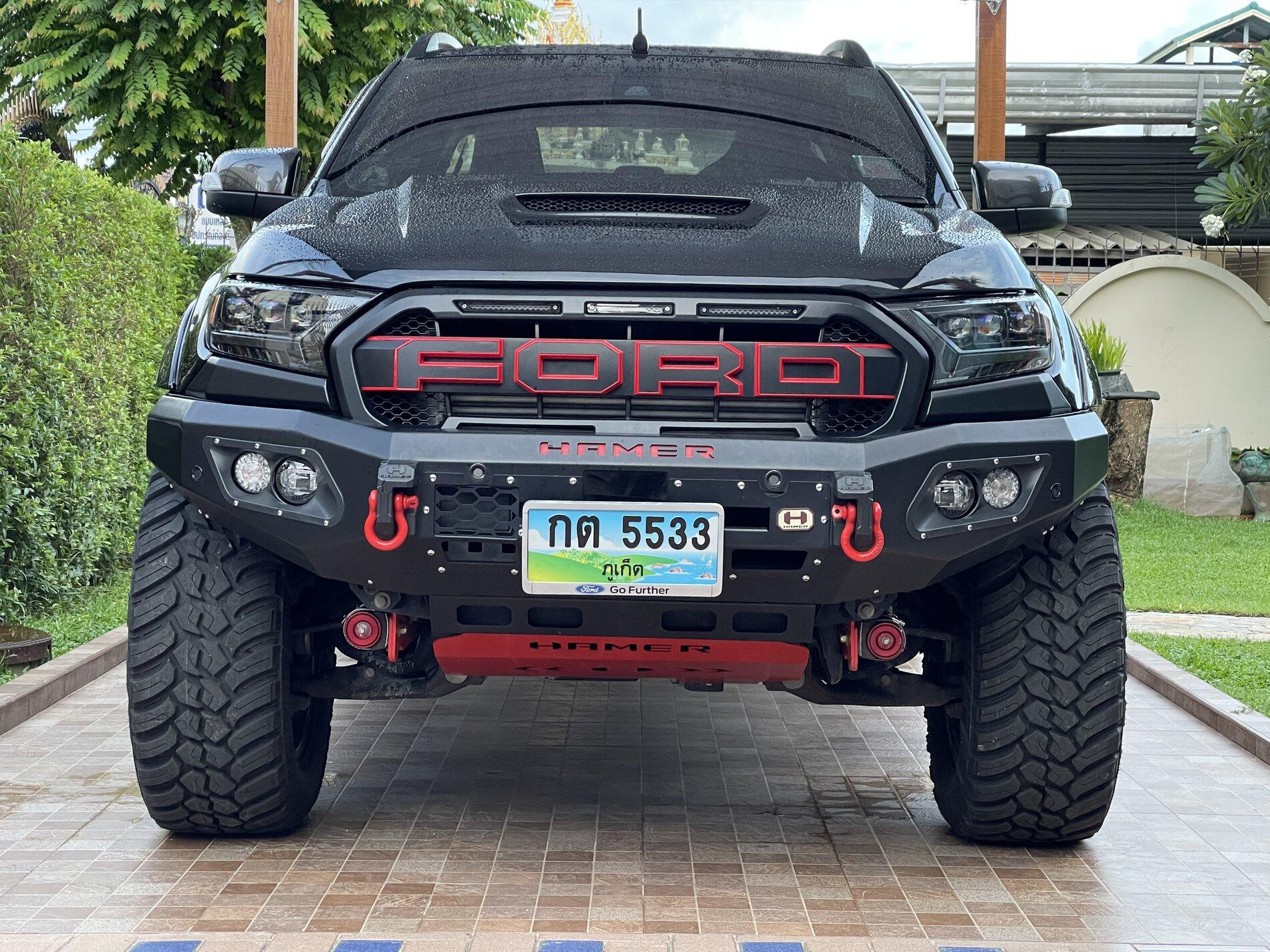

0 offset. I love the look however the turning radius is too large making more clearance issues, and rocks fly everywhere especially if you live on a dirt/gravel road like I do. I am making the switch to +20mm offset soon

Fitment looks good though. Not sticking out too far visually. But you, living on a dirt road, will notice the small things that bug you being at that offset.

Yes its wierd because it looks good from that angle, but sometimes as I approach my truck from a different angle they do stick out too far and it looks like they don't fit right. Im pretty sure crash bars have to be removed completely at this 0 offset. I have aftermarket ones and it rubs at full lock + flex.

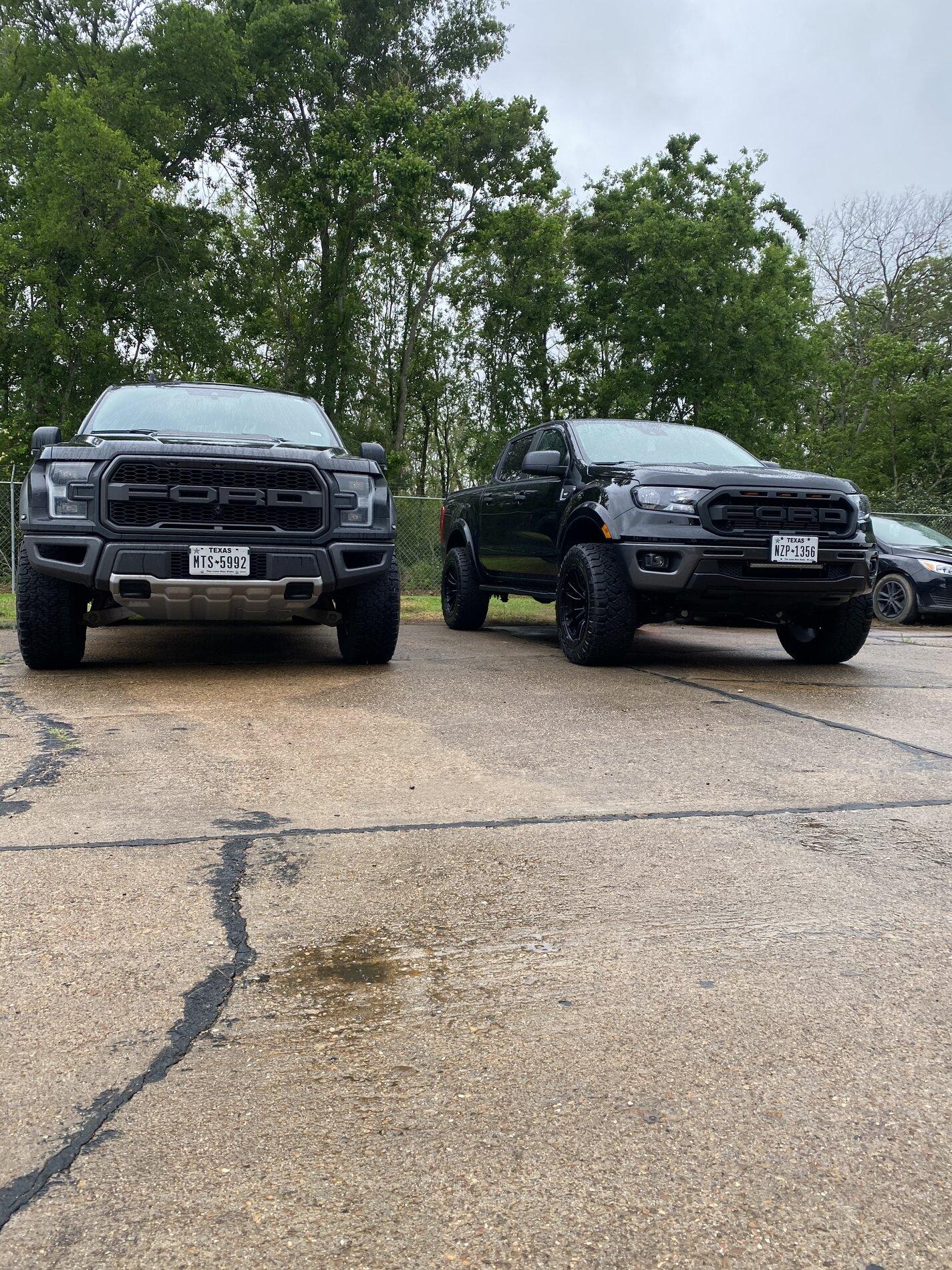

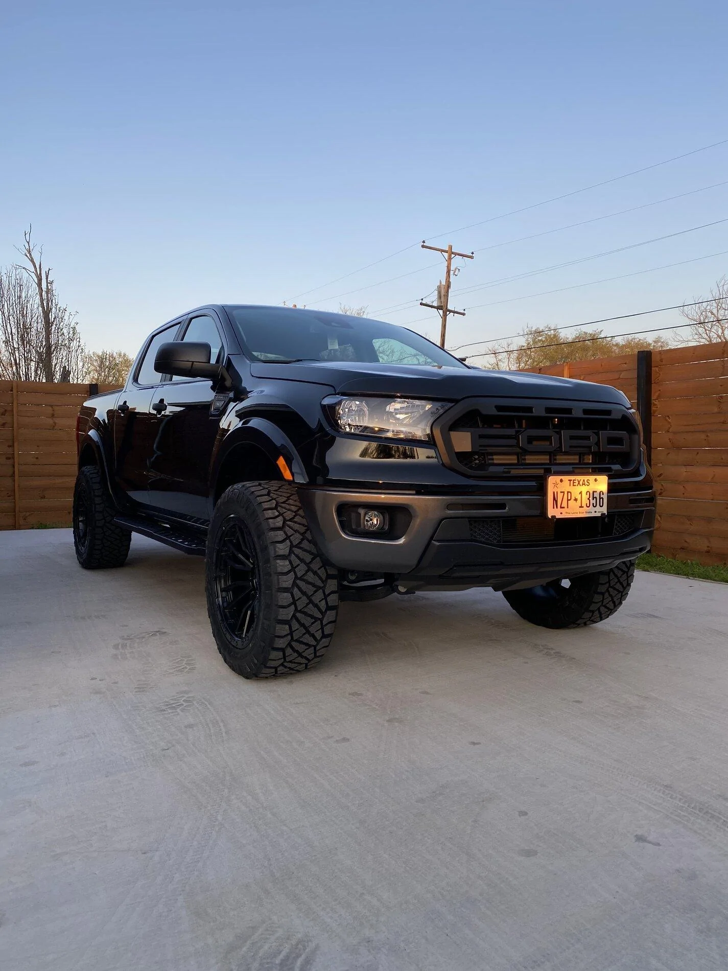

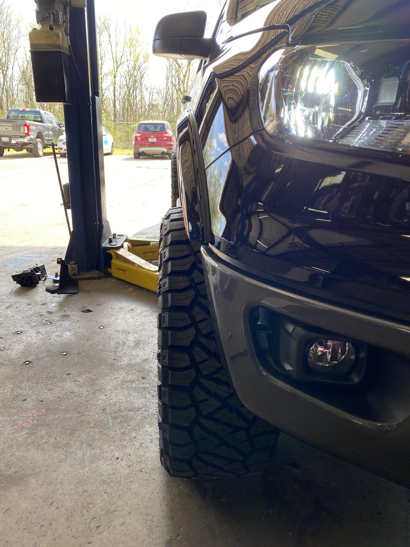

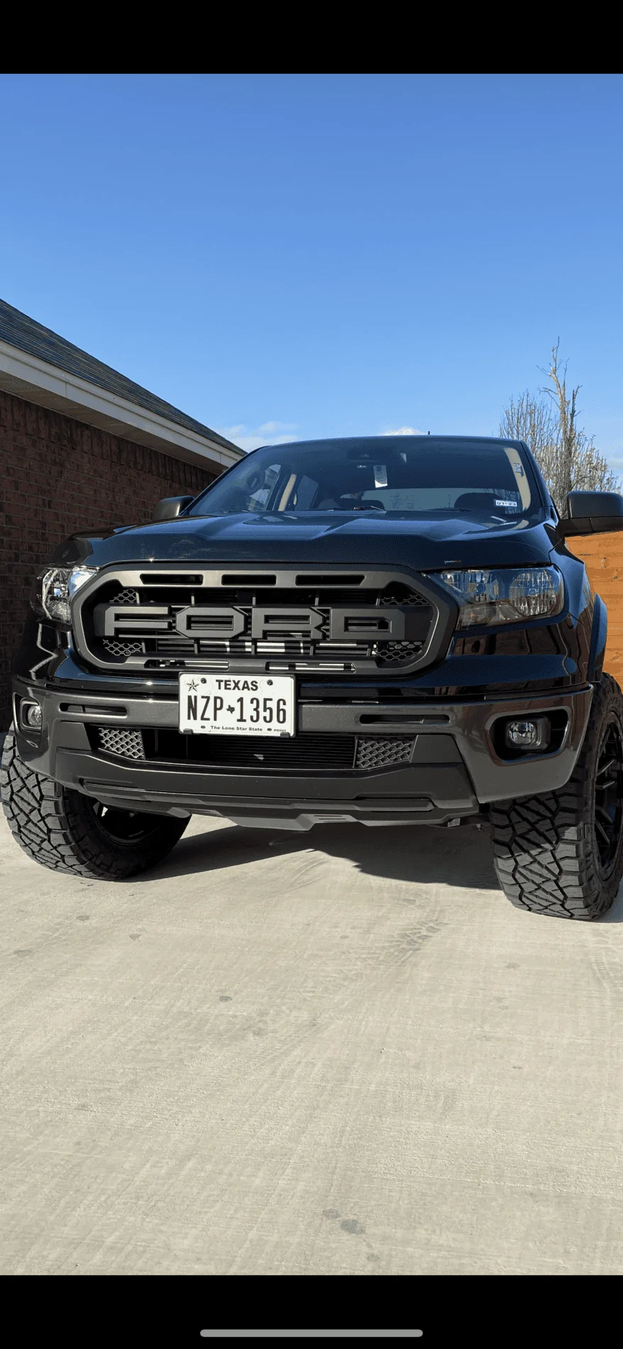

2.5 inch level, 285/55/20, -18 offset
