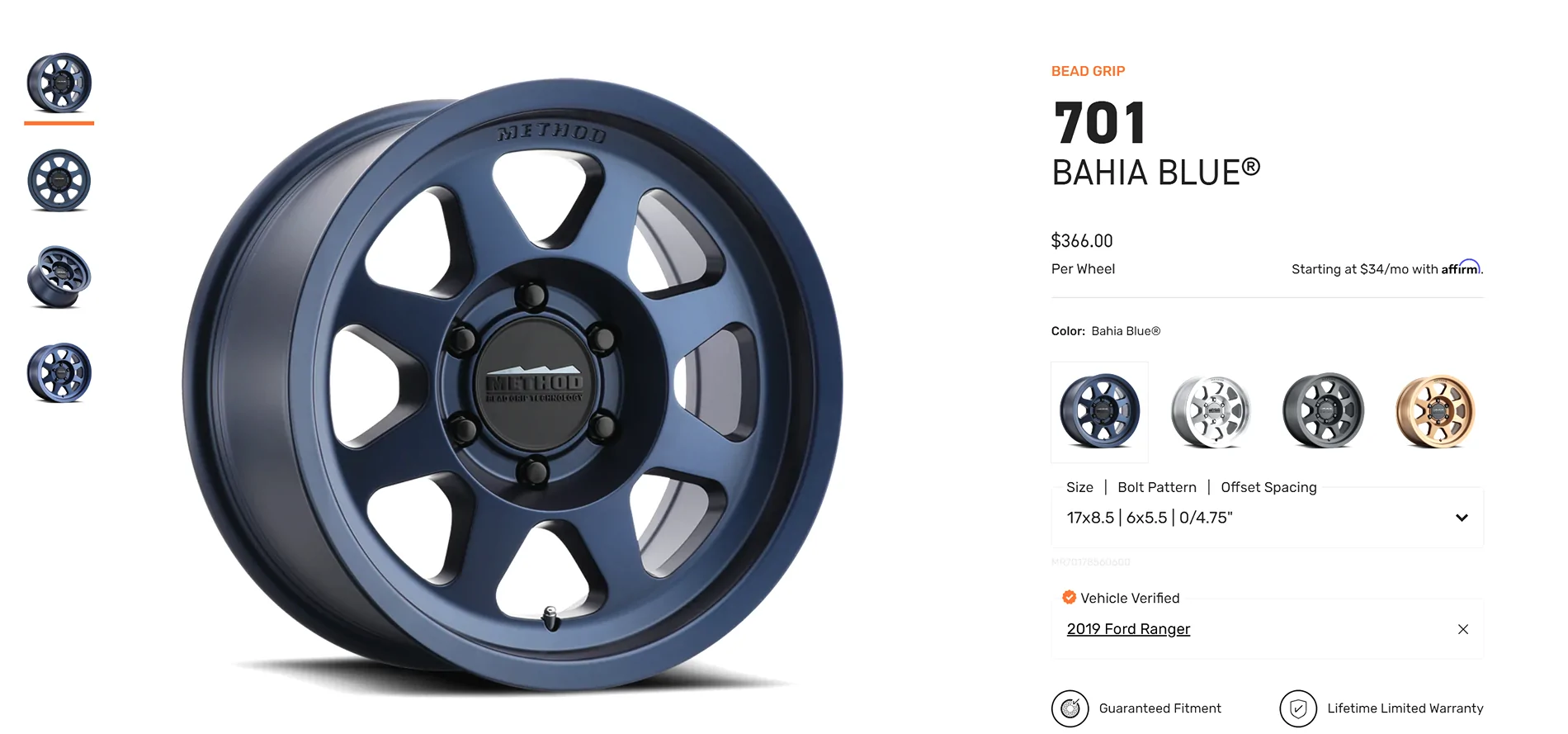

The Method 701 bead grip wheels I want are only 17x9 "-12" offset or 17x8.5 "0" offset (baja blue).

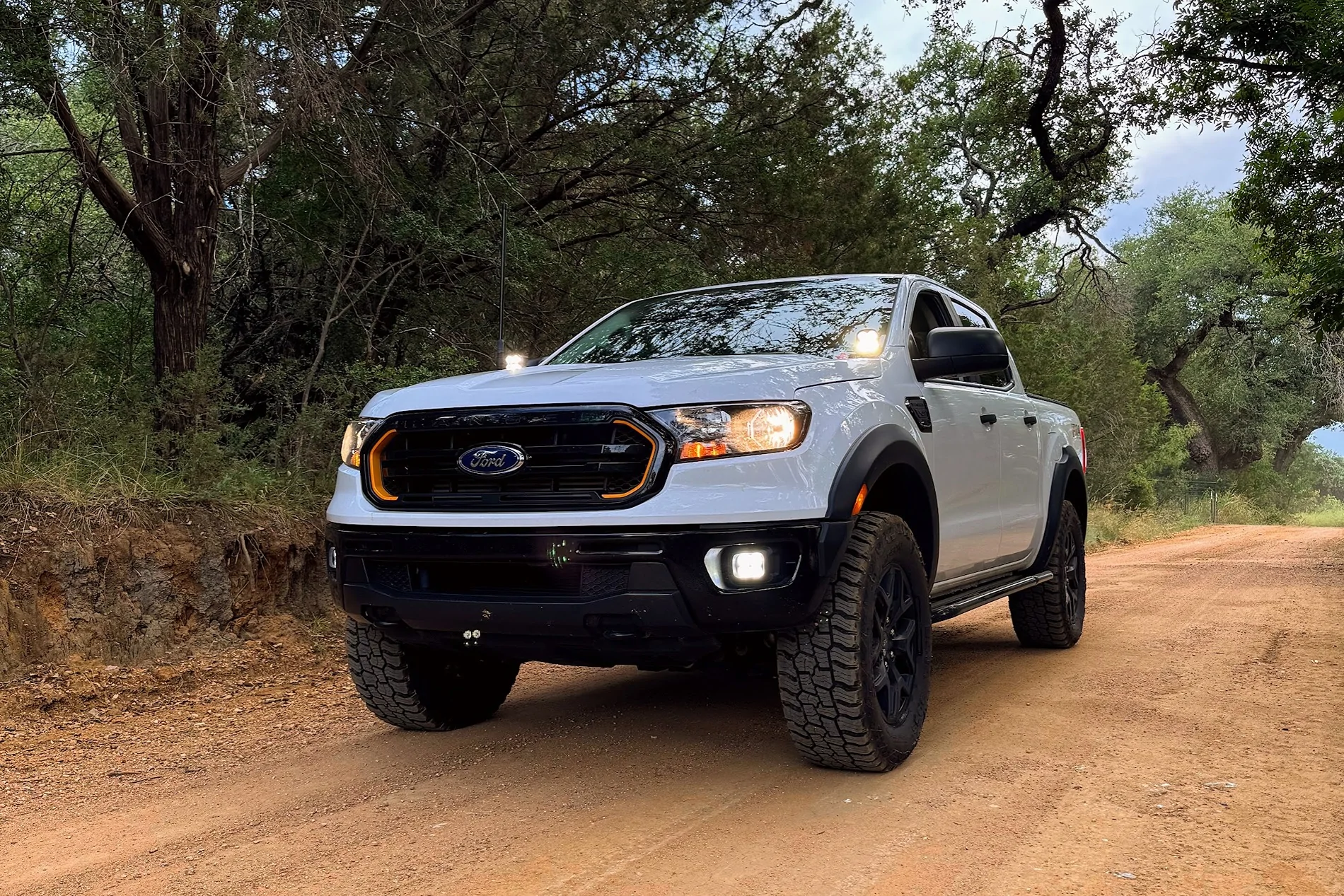

To figure out tire size, you kind of have to work backwards. When considering diameter and width of the tire, the offset of your wheel is really going to determine what you can do. I chose a narrower tire so I could go a size taller with the wheels I have. On my wife’s ranger, I went with wider but shorter tires because I didn’t want to pull the crash bars on her truck.
Hers is leveled with 265/70/17 tires on 17x8.5 +12 offset wheels. Stock crash bars still installed. For that setup, I wouldn’t go any wider or taller because the tires get close to the crash bars at full lock. If you have high clearance bars, or remove them completely, you could probably go a size taller and wider and still be safe. It took months of researching to finally pull the trigger on the wheels I got for her truck and mine.
12mm is a little less than 1/2” so I wouldn’t get hung up on that… My advice would be to pick the wheels you like, then figure out what tire size will fit. The more offset you have, the more you’re going to limit tire width unless you’re willing to swap the bumper and do some modifications to wheel wells.

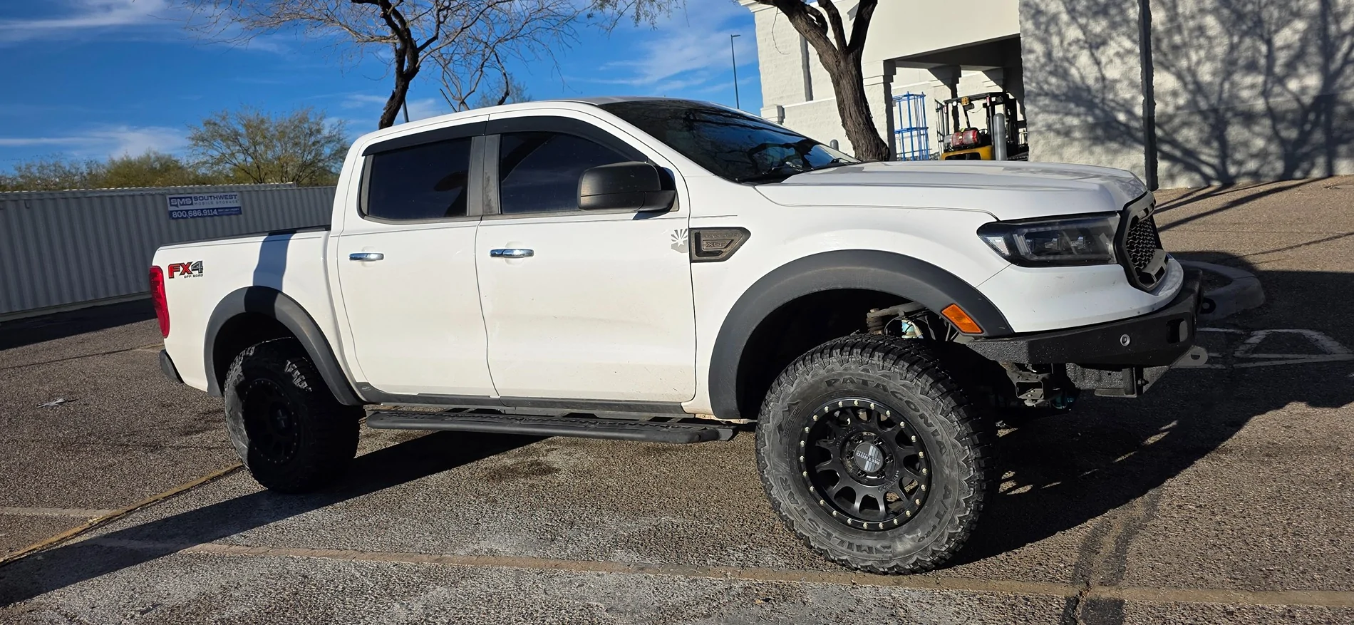

I might just go with 0 offset. I should have the setup to make it work with 285s. If not, nothing a hammer won't fix. It's 25mm more poking out and 0.5in taller tire. I don't see why that won't fit, got tons of room right now.
A +35 offset rim would actually suck in 12mm compared to my OEM rims with spacers. That would look ugly compared to my current offset which is effectively +23mm

I like your truck! Looking at the picture I understand what you are saying though.
