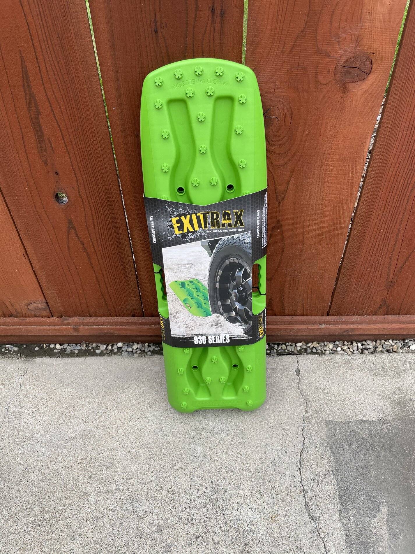

A set of "Hulkan8ors", green extraction boards called Exitrax.
Available in 3 different lengths for what best suits your needs. My BuildRight's are still awaiting shipping...

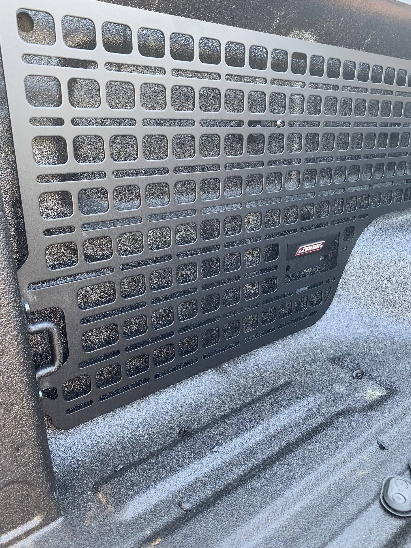

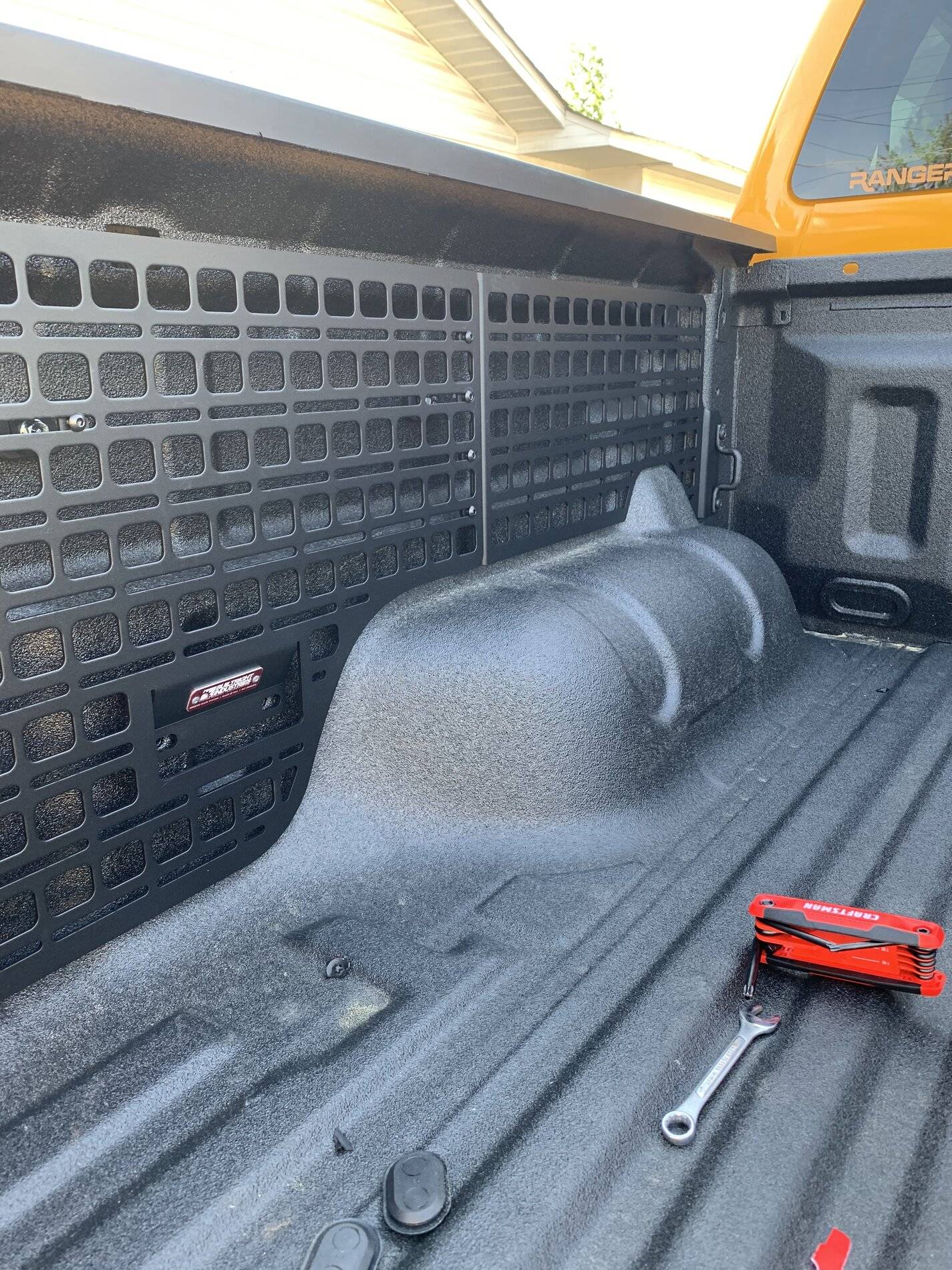

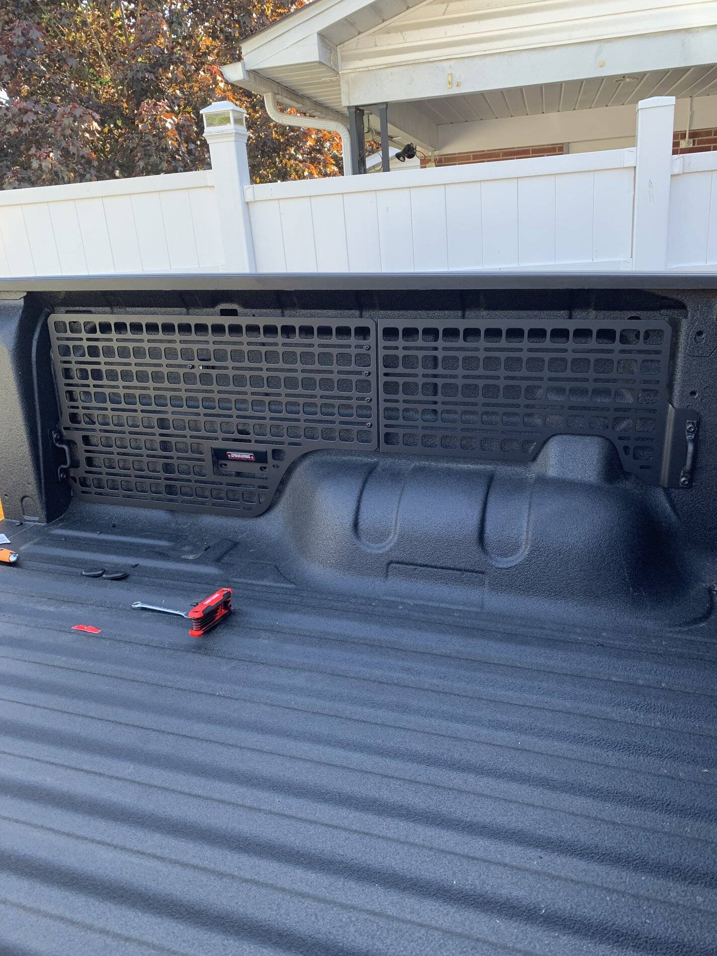

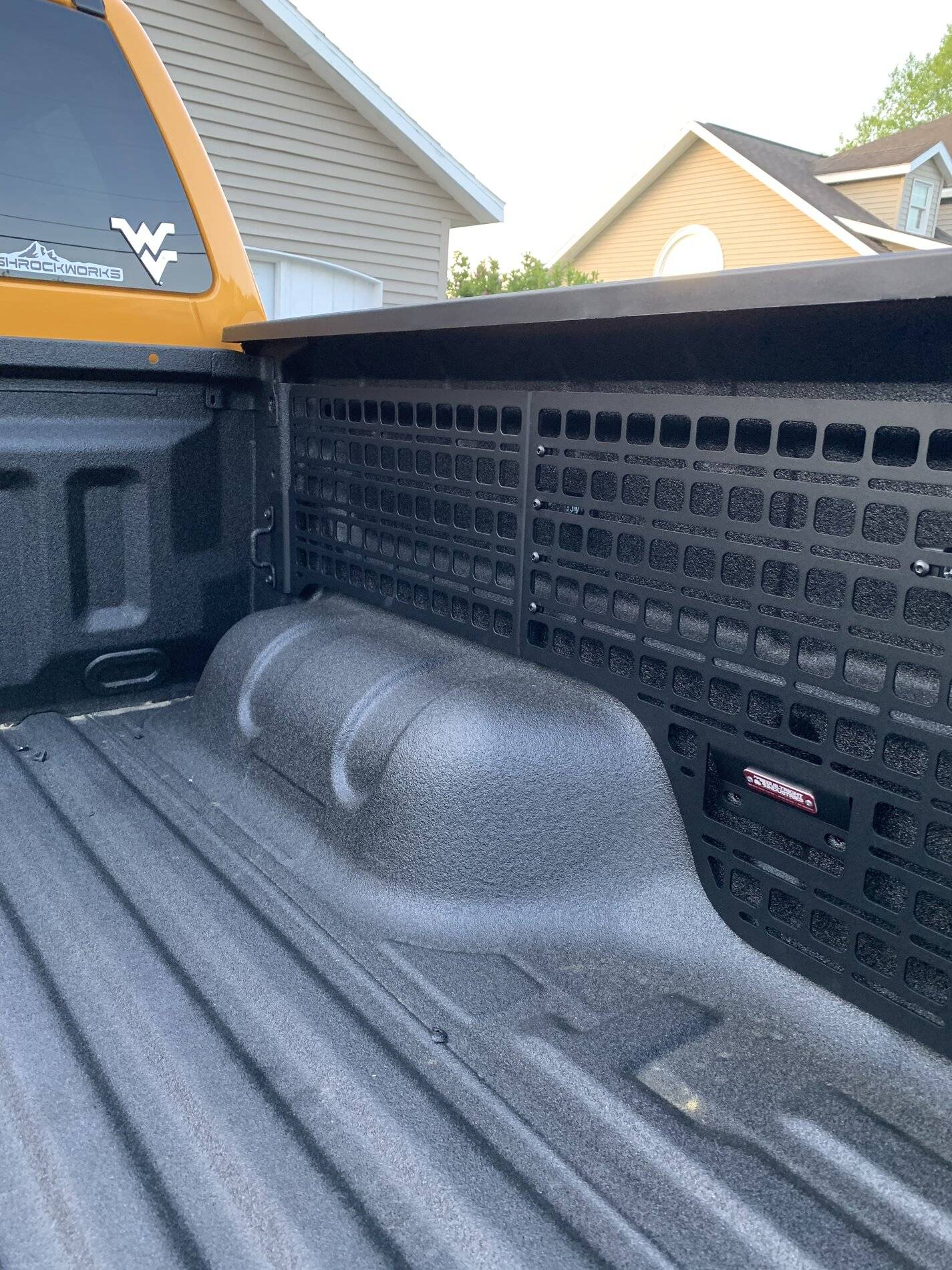

I have a set similar to those, can’t remember the brand name at the moment. The racks do utilize a third set of tied down hooks that my truck didn’t come with. They are horizontal almost halfway back near bottom of the bed. The racks are still sturdy without them, but tomorrow I’m gonna try an order them. I was also missing two lock nuts, so I had to run to the hardware store. You’ll enjoy them!

Went to the dealership today to get a price on the additional tie down hooks. It's right at $95 for two hooks and four screws.
Hook Assembly Pt# 21550A74
Bolt Pt# W505594

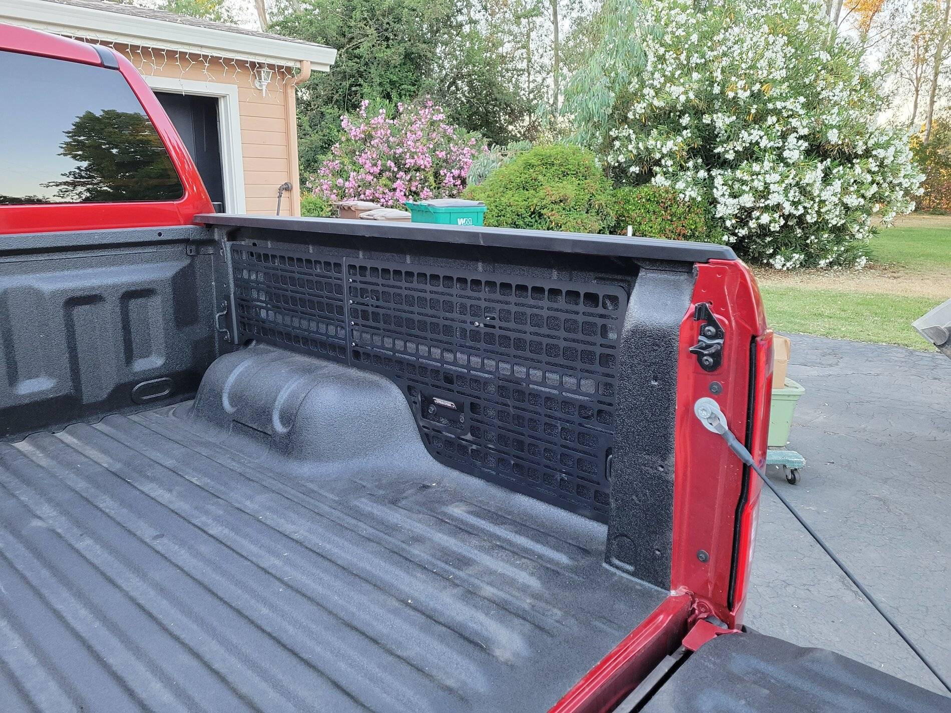

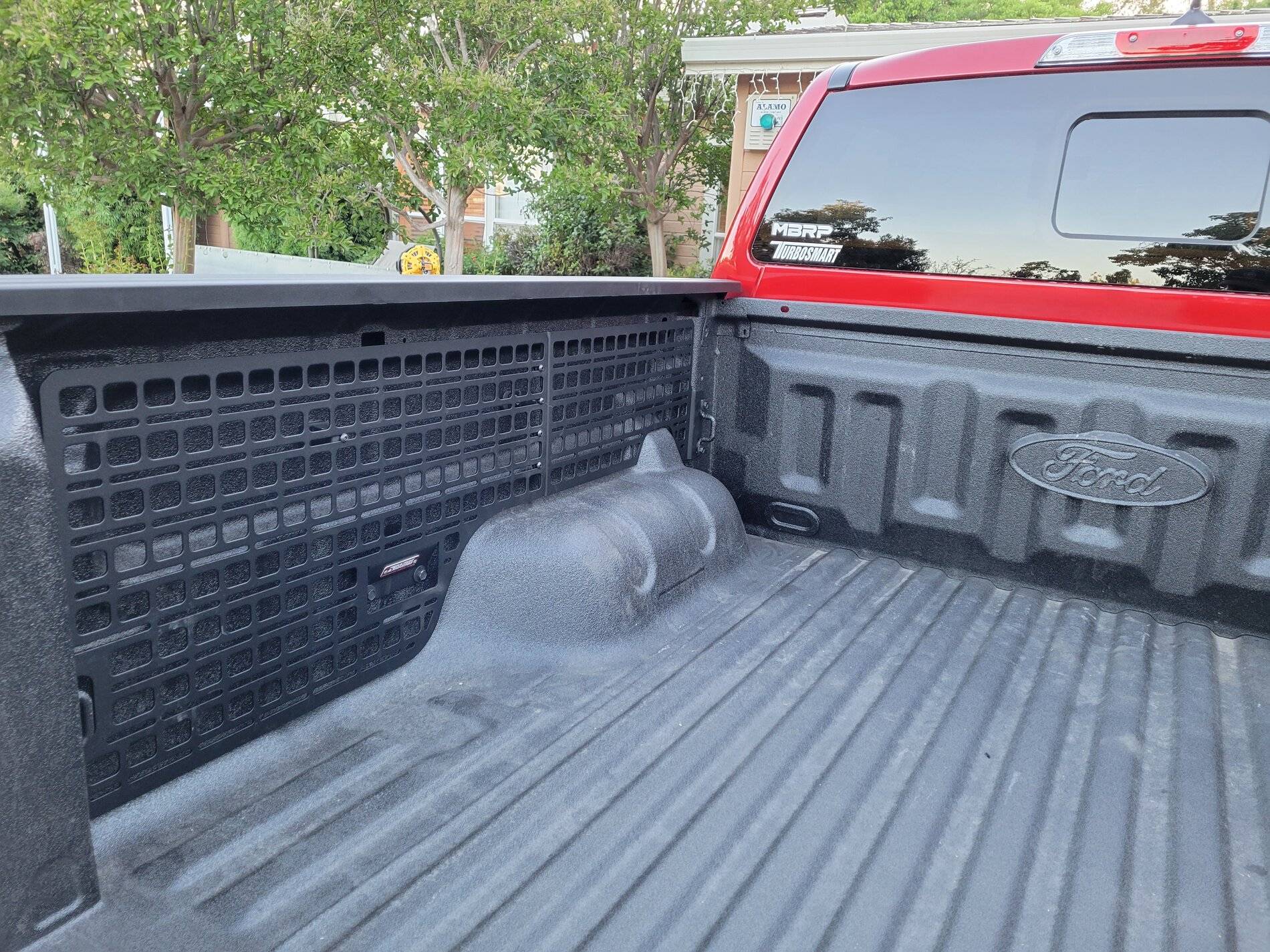

Nice. I just installed mine today.
FYI, the bolts where the builtright logo is are M8-1.25. I used these bolts from Lowe's, along with an impact driver. Didn't have to do anything to remove the spray in liner material. Just drove them straight in.

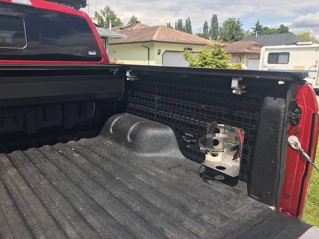

Here is mine still need to mount shovel and axe but propane tank mount is on there.
Which tank mount is that?
