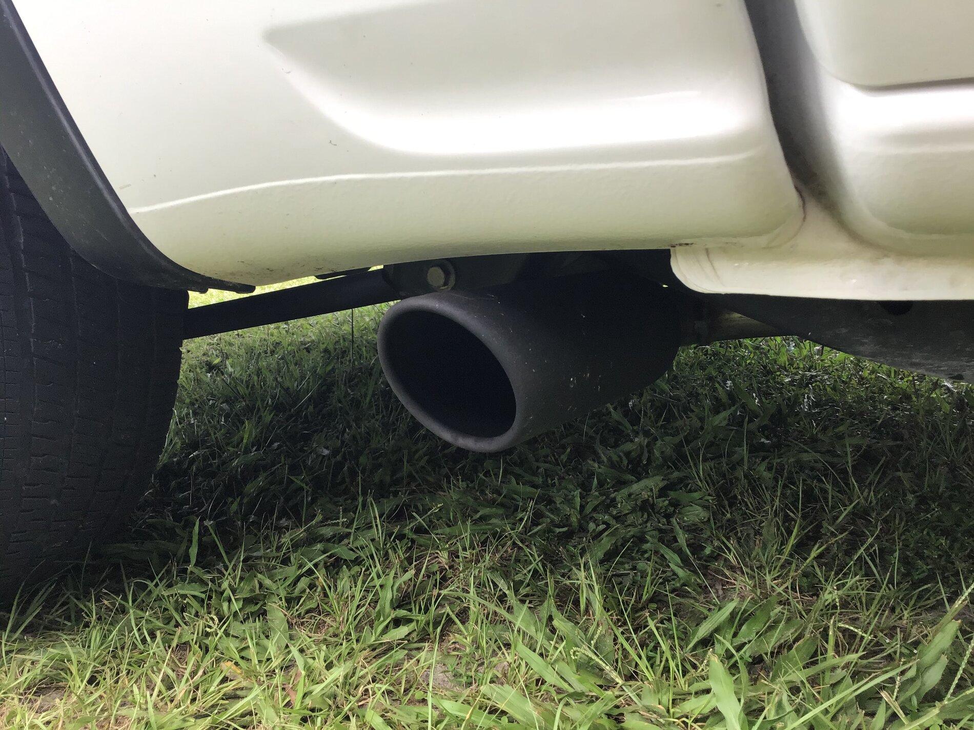

Trying to keep it stock, if you have tried to launch your truck break boosting to say 3500, you will spin through 3 gears. I’m trying to get my power to the ground..I have 388 on the torque right now and doing a lot better with traction right now ...I have tuned the new suspension and the launch is much better but not optimum. I don’t need anymore power right now. I have one more adjustment to do to the suspension that should help. I just would like to do what I can without going to cheater slicks..if that makes any sense...
Regards
Doc
EDIT: I Have muffler and resonator delete and added a fiberglass tonneau to add some weight in the rear.

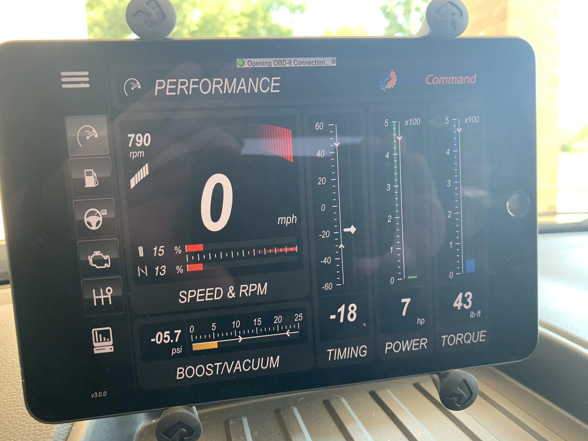

Check out the max horsepower today.
I have the same software. I would consider this for reference only. The dyno pulls I have done really don’t match up well with what this software was telling me. There are a bunch of parameters that need to be set in the Dash Command settings. I set all of the ones I had data on and the Dash Command is pretty far from the dyno sheet.
Dash Command = 335 hp
Dyno pulls = 282 hp
If you want to know what your engine is producing you’ll need to get it on a dyno.

Yeah. But that is crank hp. Not wheel. Where that is useful though is comparing before and after mods.
