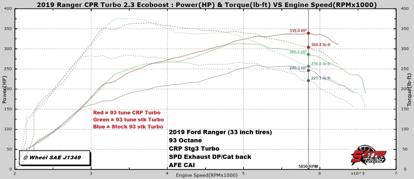

I do have a turbo from CR Performance and I am tuned by 5Star. I am quite happy with it. I am nowhere near $2,500 though. I bought a turbo and sent it to their shop to be worked on. You can get a new turbo from Levittown for about $480, send it to their shop along with $850 and you are set. Then you can probably sell the turbo you take out. I actually bought a turbo out of a wrecked Ranger with very few miles on it for even less. I did replace quite a few of the gaskets and such just because I didn't want to rip the thing apart again in the event of a coolant leak or what not. Regardless, I am quite pleased with it.
Below is the before and after chart that CR Performance has on their website. Some pretty good gains and the low end is not a problem. I do sense a bit more lag, but it is also warmer out this time of year. Plus I swapped the intercooler out, i.e., larger air volume post-turbo. I'll have a better opinion on that once it gets cold again. I am also reading Corky Bell. Makes sense to read up on turbo engineering and science after I have already replaced the turbo.
Anyway and like I said, I am happy with it. While the turbo does take a strong day for a weekend warrior working with his 11 year old son to make the swap, it was much less involved than Baranger's odyssey. I have the AFE intercooler pipes and Turbosmart BOV. That was easy enough. And an intercooler from Levels Performance. With any of the 91 performance, e30, and e50 tunes from 5Star, the power is pretty ridiculous. The only way I can describe it... well only two ways I can describe it are violent and of course fun. The neighbors and my wife also add LOUD to this list. The AFE downpipe and Borla exhaust do like to sing. I pretty much have a race engine now and the only other bolt ons that might be of interest are a larger throttle body (+ a spacer?) and a fuel pump that would allow me to run e85. But I don't see the cost/benefit ratio working out for me as the fuel pump is anywhere from $1,600 to $2,200. I think I'll hold off and build a rally car with my son instead.
