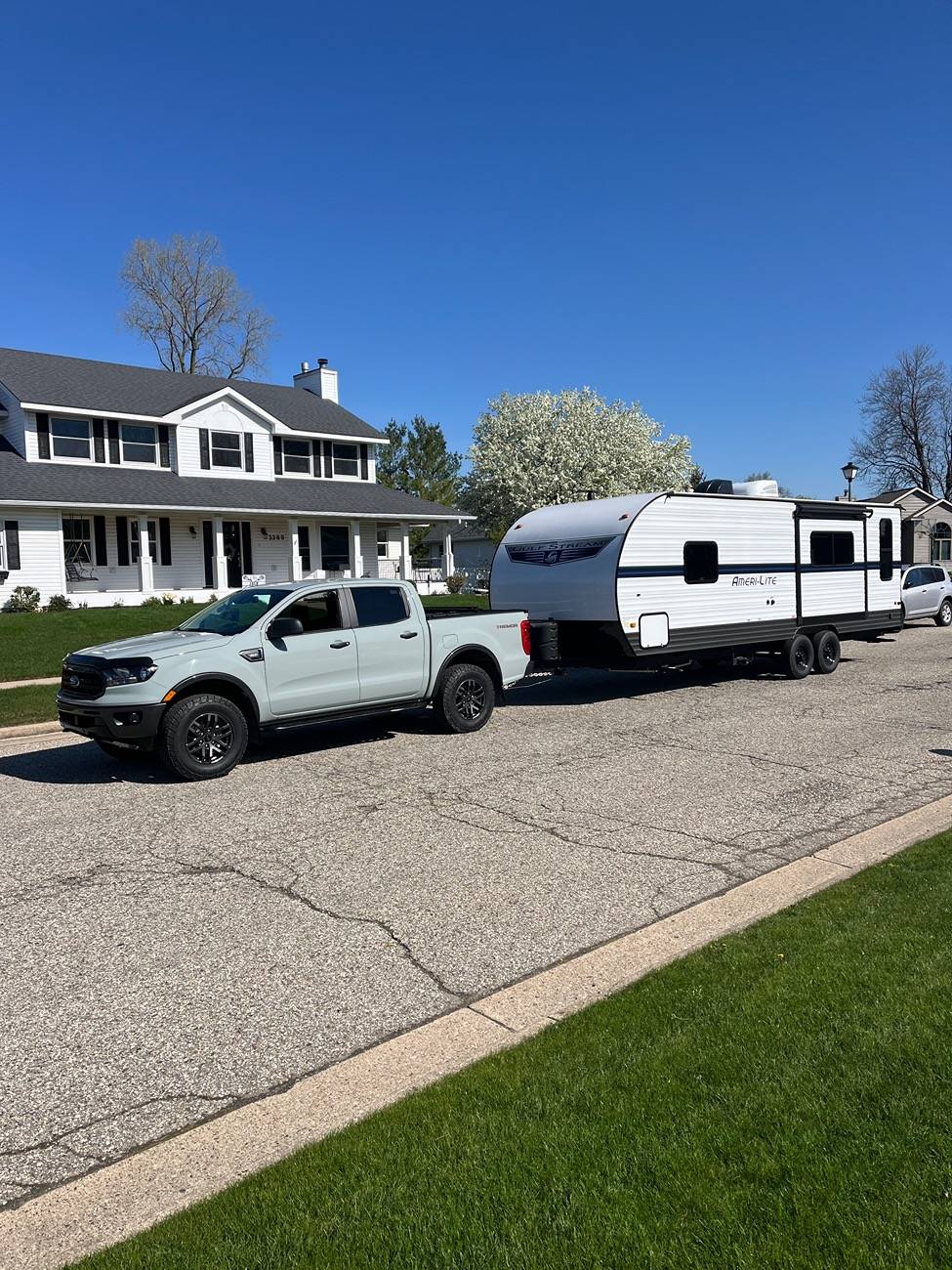

Just an illustration why it sits high in the rear. Rangers ( and Tremors) are rated at 7500 lbs towing capacity. Our rig weighs around 6000 lbs loaded and about 650 lbs tongue weight. So with trailer attached it’s pretty much level. So it’s performing as designed. If it was lowered in the rear or raised in front then it would change the geometry for towing. So the weird look to you is actually a designed function of the truck. Not faulting your perception but trying to explain why it’s the way it is. Oh , and when disconnected from trailer it’s fantastic off road.
