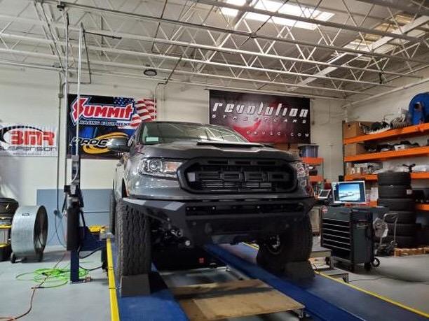

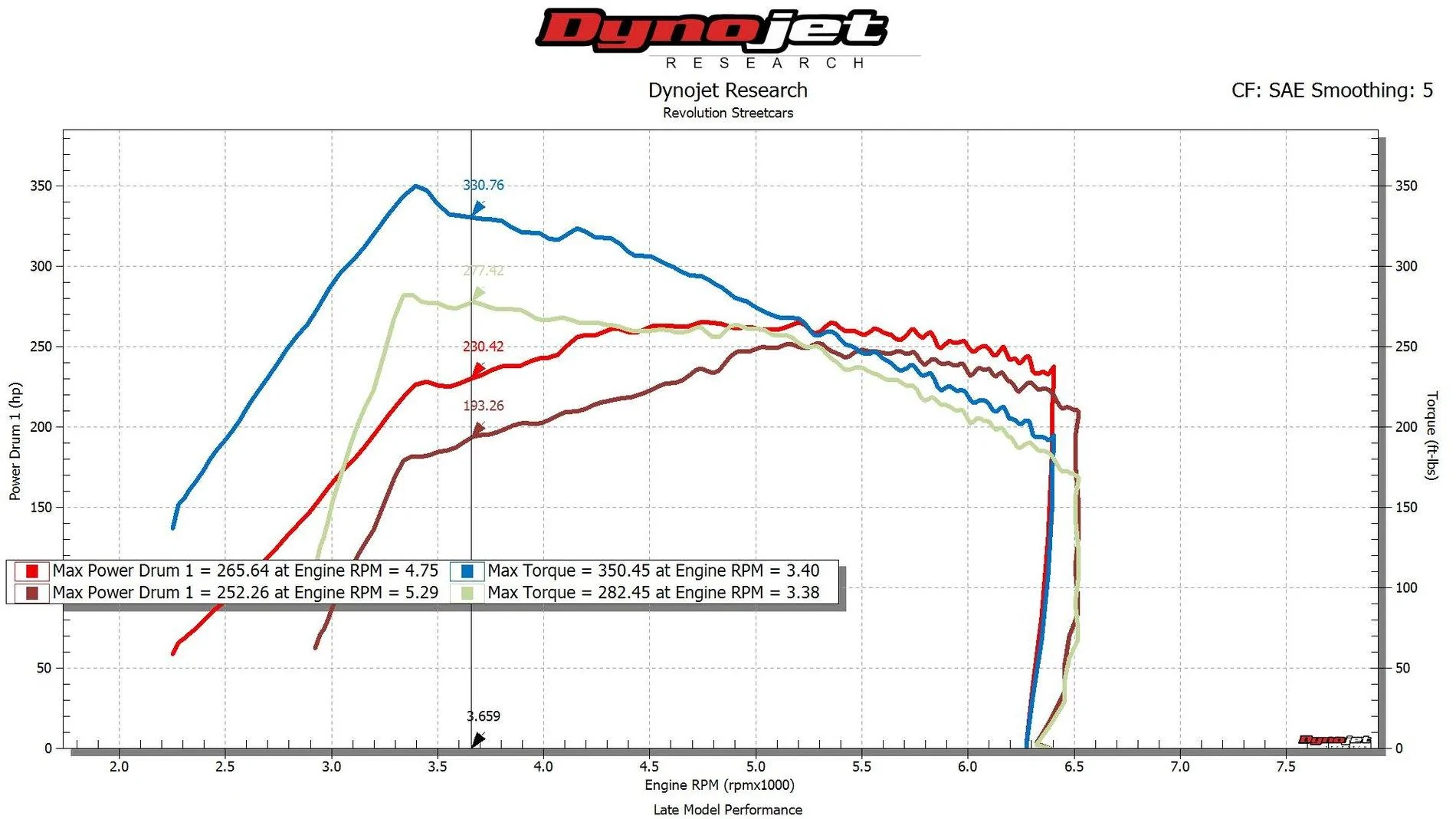

Sorry everyone . We have been away a bit. And not to active on here but have been steadily making progress on the Ranger Platform.
While many are in a race to just make power and knock out tunes . We’re taking time to make sure the tunes we do have the ability to handle extremes like 110+ degree heat with humidity .
So for our first package we will have a tune to work with just the air filter (drop in) and BOV.
In our preliminary session . Went really well we were pleased with the gains . And being able to get 350ft Tq on 91 on a muggy hot summer day is great. While more power can be made we are still lookin into making some tweaks .
Also note we are on 285/70/17s not factory. Tires .
We should have more info soon. And soon going to be doing the tune with down pipe and exhaust .
