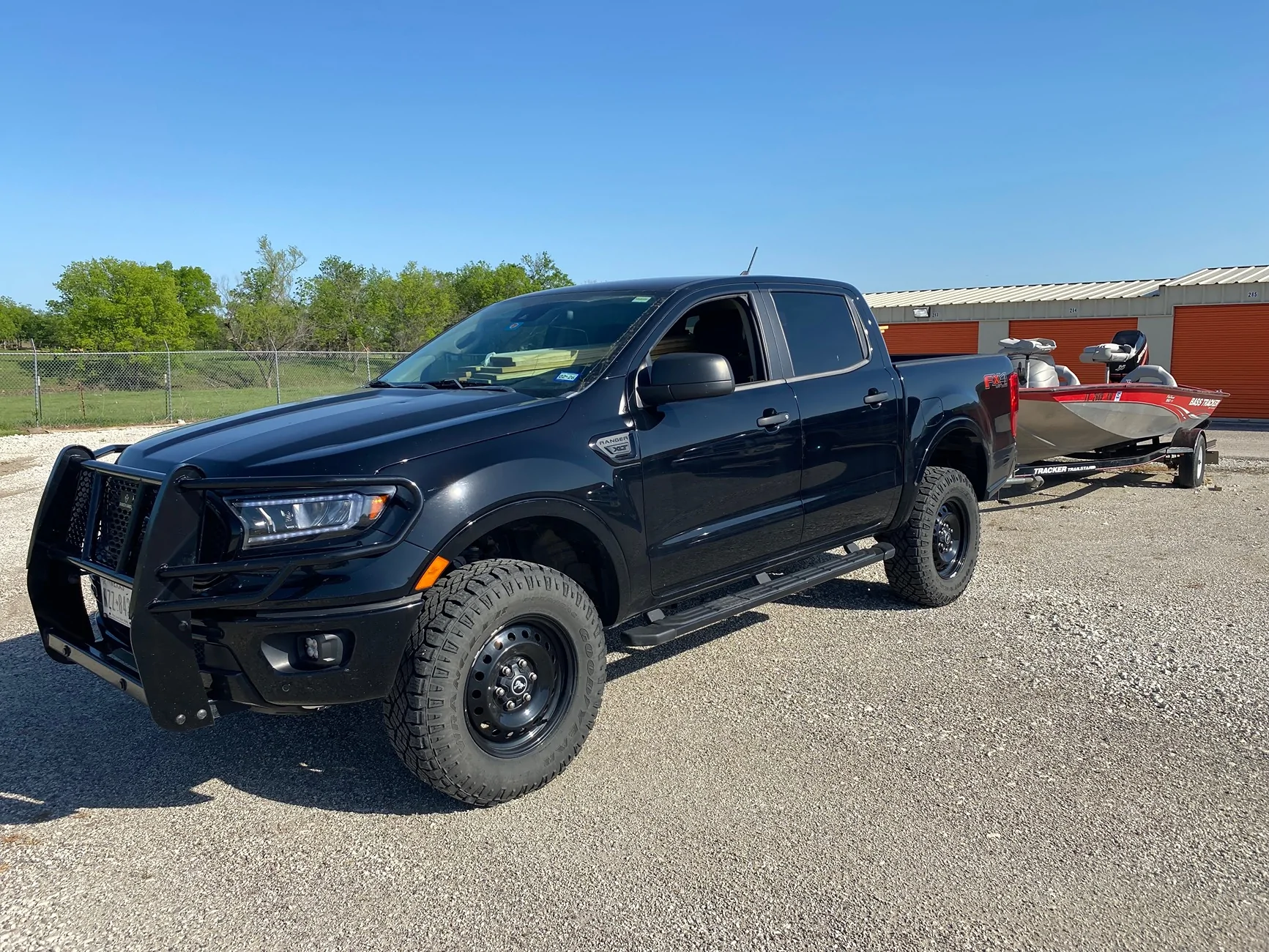

I’m looking into either a GFC or a Project M camper. More of open concept designed bed campers. Drop any pics below if you’re running any sort of bed camper and what mods you’ve done to it or to be able to run it. Here’s my Ranger that it’s going on.
2020. Bilstein 6112s/5160s, 265/75/16s, Bronco takeoffs, and an icon 600lb leaf pack

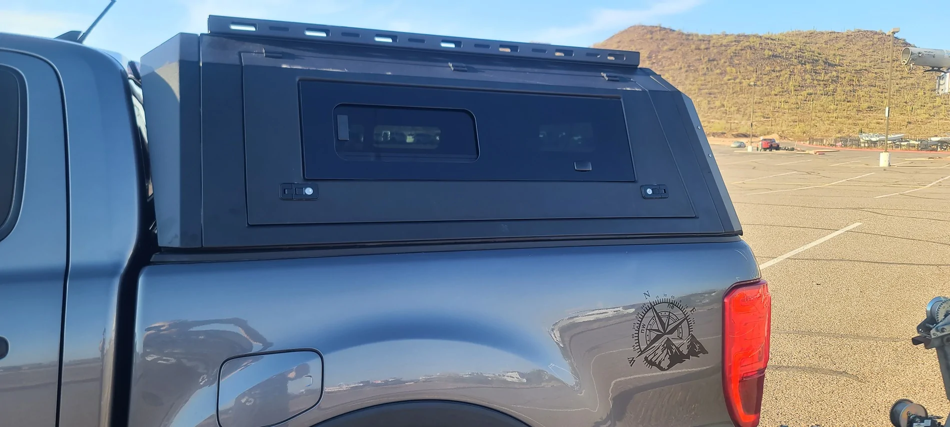

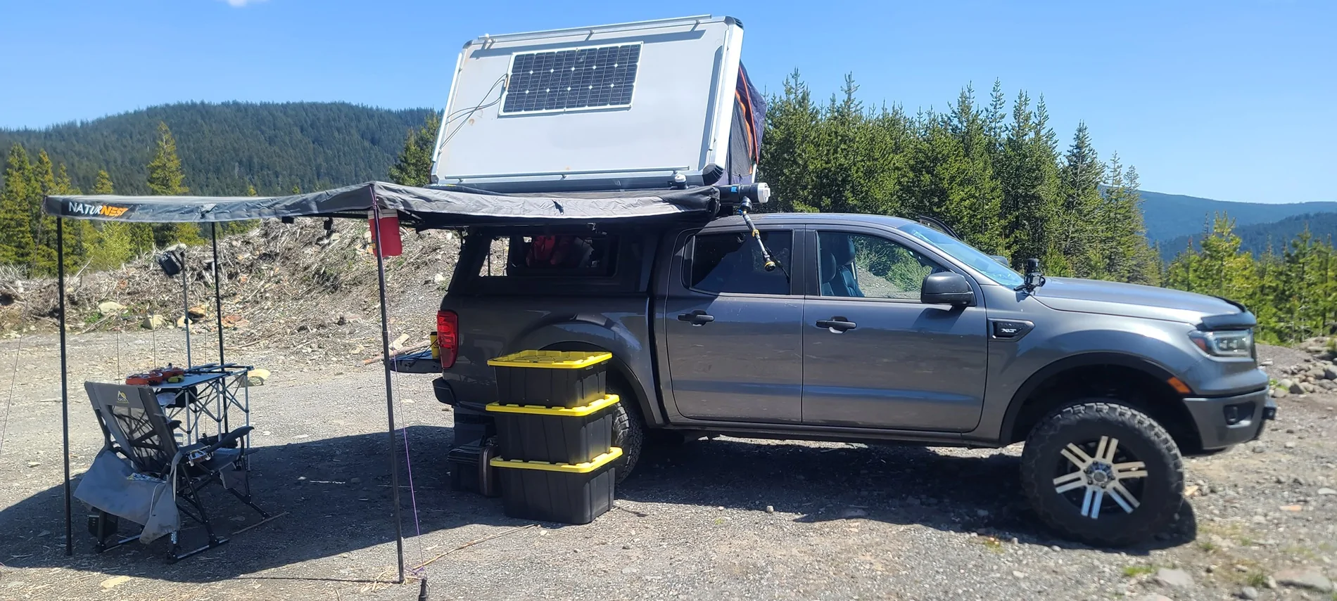

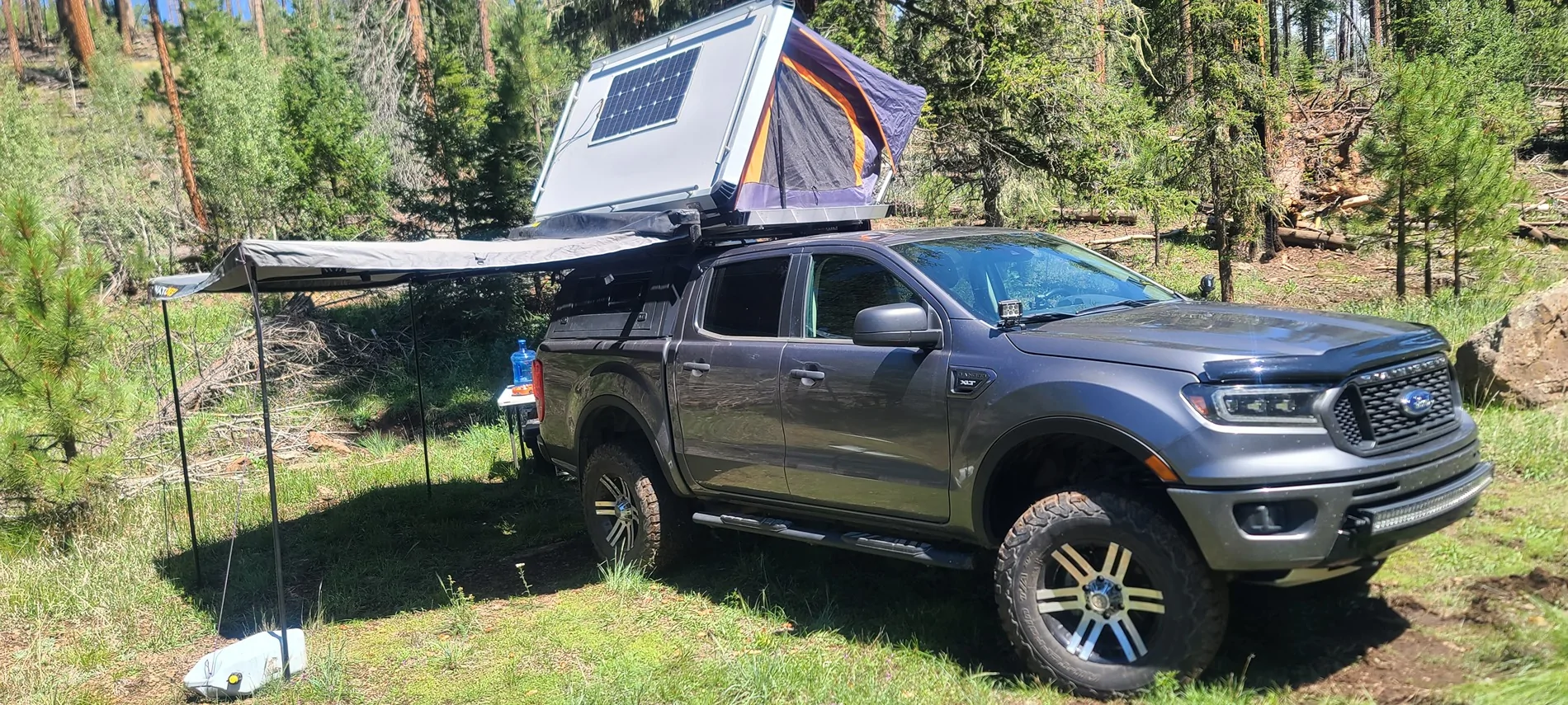

Topper from Alibaba $800 delivered, Offer-up RTT and 270 awning. Solar plugged into the distribution panel in bed.

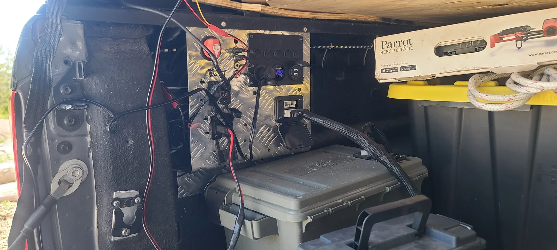

Distribution panel includes solar and the bed power plug under the wheel well. Plug ins for bed lights, topper lights, invertor, winch, usb/power port chargers and misc. stuff. LifePo 100ah battery in box keeps 12v cooler at 12 deg and solar charges.
Topper without the RTT and awning

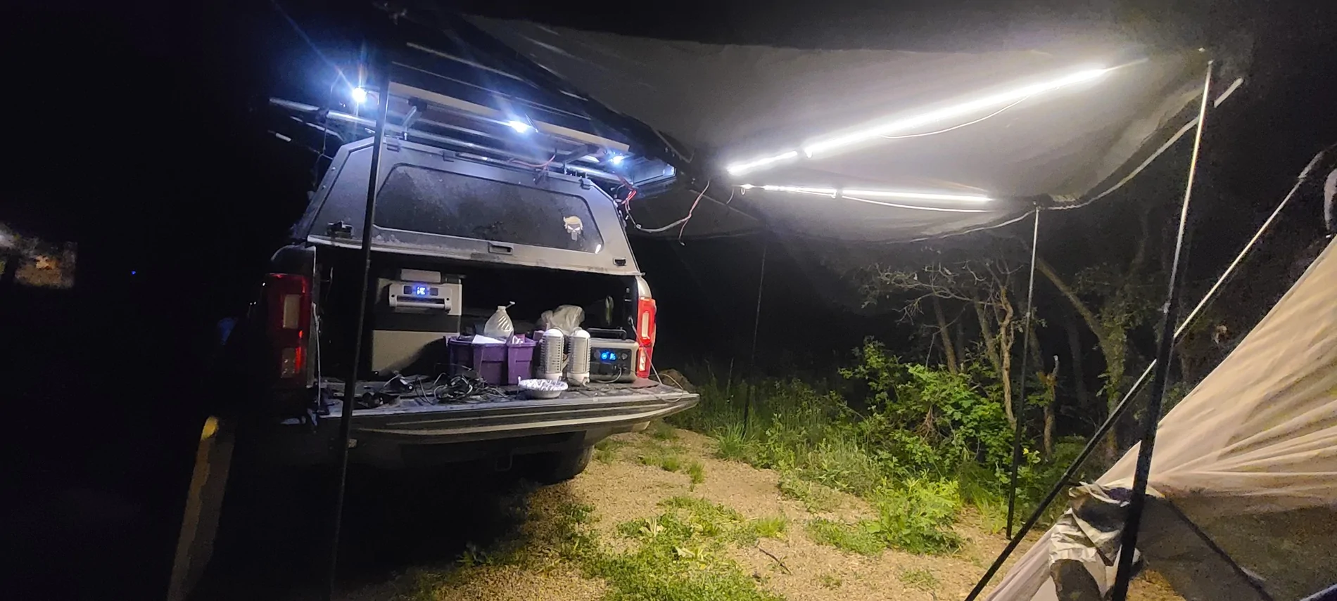

The lights in the awning are awesome - no need for propane lantern. There are lights in the Awning and i added lights to the bottom of the RTT with a switch and plug in to the dist panel.
