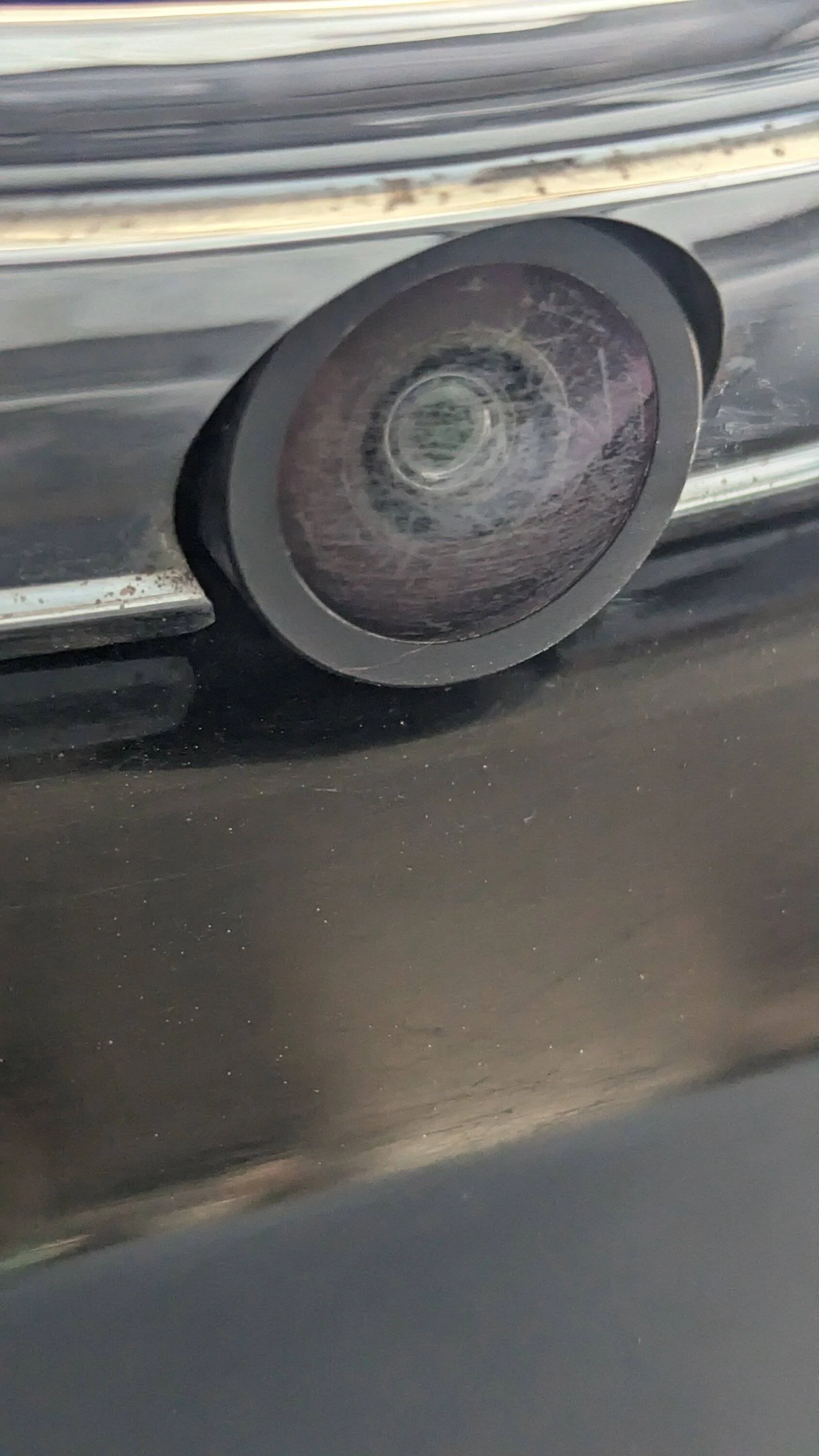

Hello all! The Saga continues. I had a camera overnighted to me for about $60. I put it in and wow clear as day!
One BIG issue. No trajectory or guidelines and the zoom trailer button doesn't work anymore. The setting to enable/disable the lines is also gone from the menu.
Sounds like when replacing hardware you will need a dealer recalibration?
I was worried about that, Hopefully the dealer will do it under warranty.

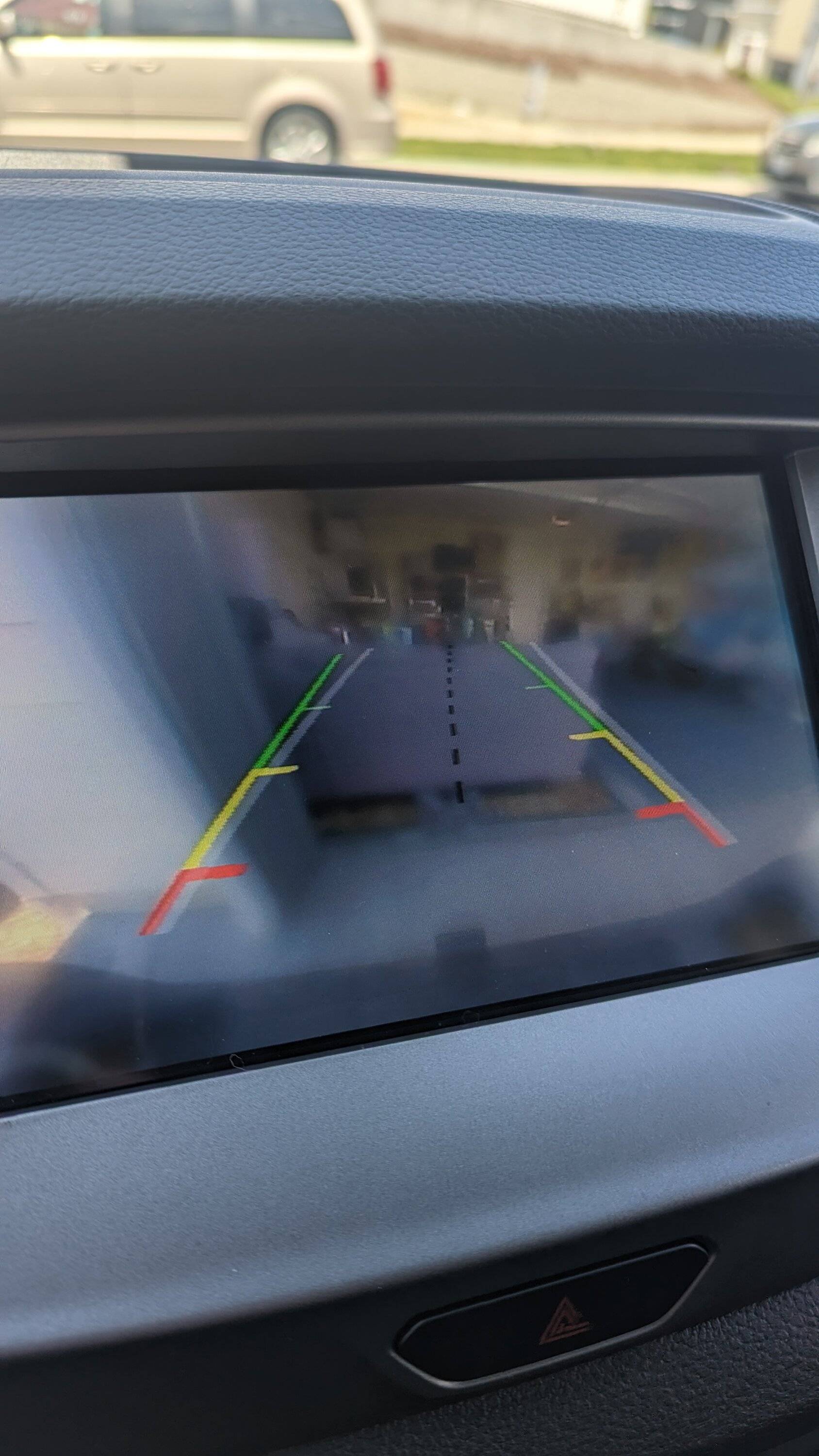

Just wanted to wrap this diatribe up. I downloaded ForScan Lite and paid the $7 license fee. Connected my old Veepeek Bluetooth OBD2 adapter and went into Service mode. Selected Local Interconnect Network New Module Calibration and let it rip. It has you turn off and back on ignition and boom. Lines are back!
Wooo! So total cost was about $70 and saved myself a trip to the dealer and then wasting my time. And go figure my 22k Ford points hit my account this morning lol.
Oh and also I am pitch black in this photo so the quality looks bad, but trust me it is sooooo much better.
