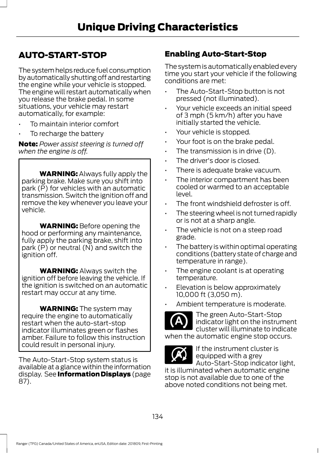

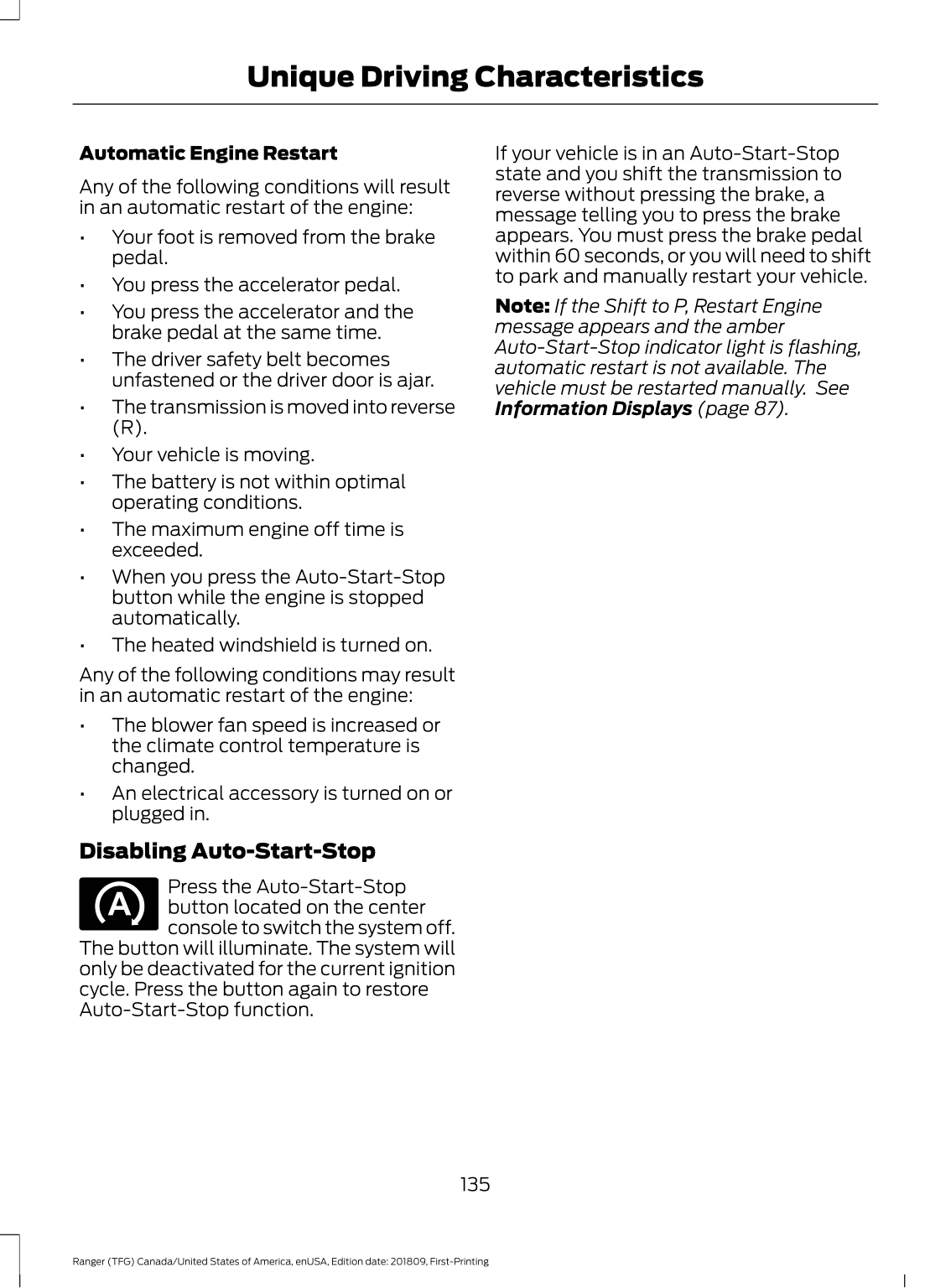

OK, so it worked fine on the way home last night, and it was once again AFK this morning. I'm guessing that it's disabled when the headlights and heated seats are on, but even well after the heated seats are off, the Auto S/S feature is still disabled. I drive 55 miles one way to the office, so it's not short trips. I'd suspect it was due to temperature, but it was in the high 30's here in Detroit, and even made it into the 40's later in the day. Seems that both times I used the remote starter (both seats on full blast, heat on full blast when remote starting) that this has occurred. I'll keep everyone posted.
EDIT: If I just RTFM, I'd guess it's due to the windshield defroster being on. It's snowing and crappy here, so I guess I just ASSumed that it would function under "normal" driving conditions.

Did reading the manual help?
I'll follow up in a few more days but it sounds like this issue is tentatively "solved".

Nope, all HVAC off, still didn't work on the way home today. I'm going to check my battery voltage tomorrow morning before I start it.

It seems to be related to ambient outdoor temps, it worked fine yesterday when outside temps were over 25F.
t4thfavor
Chance
Feb 5, 2019
2,593
2,328
Yeah, even though it hasn't worked since the temperature went south of 30F I'd say it's solved. The solution is that start stop is to get that extra EPA boost, and isn't really practical or reliable anywhere it gets cold :)
