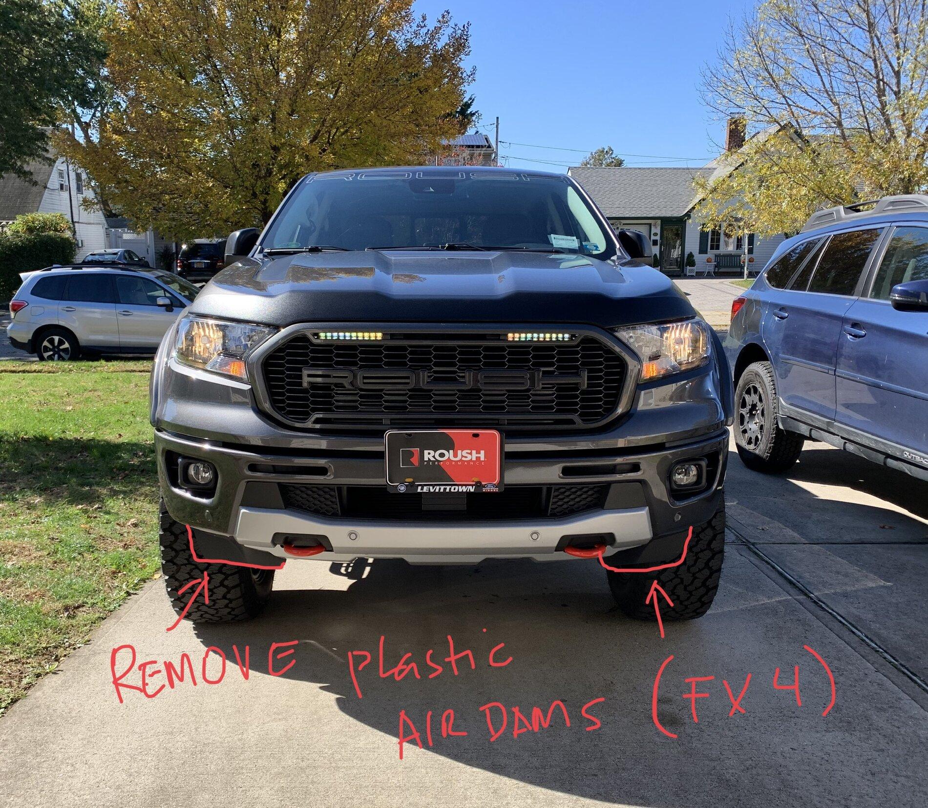

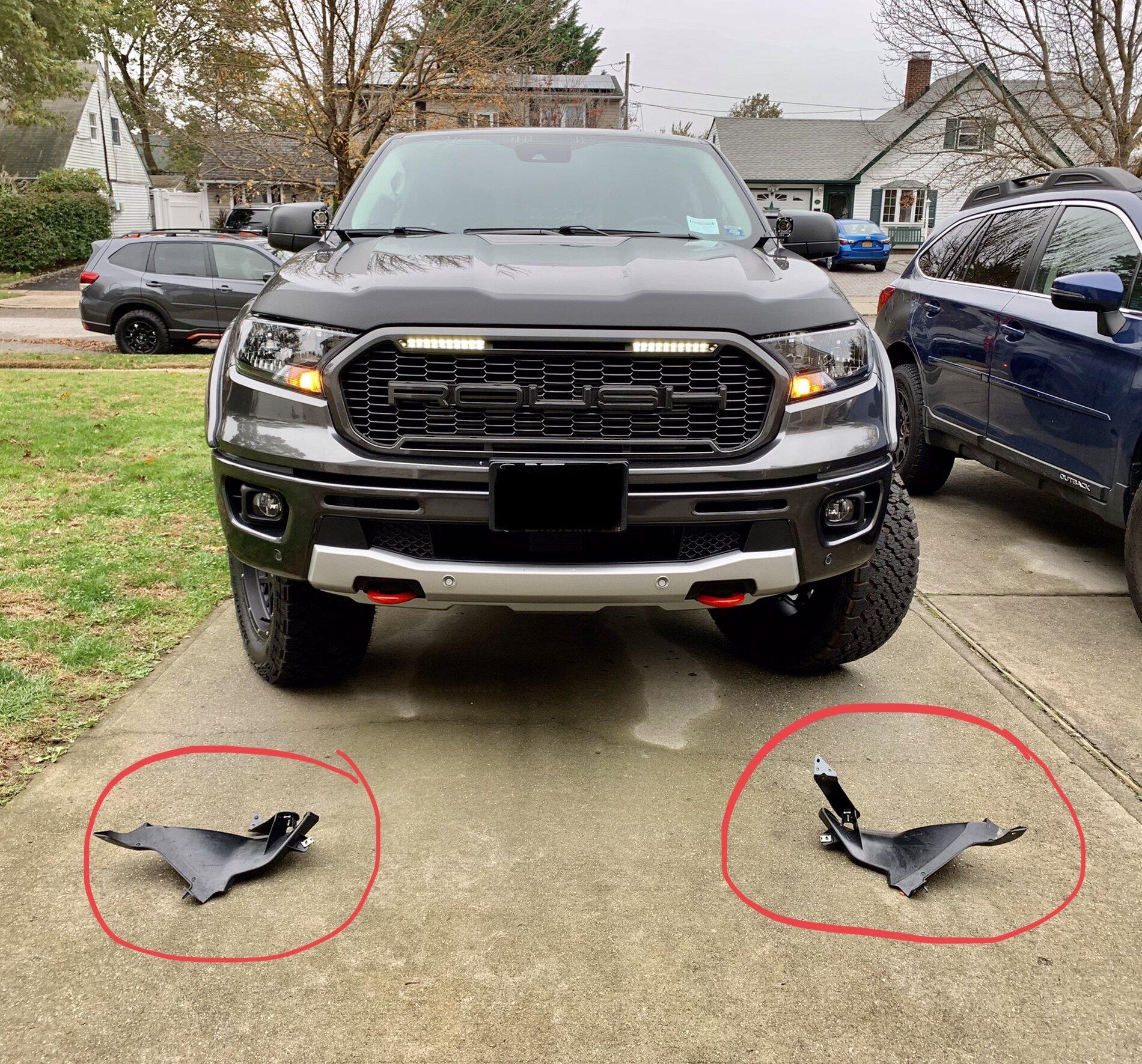

Removing the plastic air dams will help as well as turning the wheels full left/ right, to give you more room.
Reach in from under the bumper and locate the fog harness connector. Disconnect, then turn the fog lamp counter clockwise to remove.
