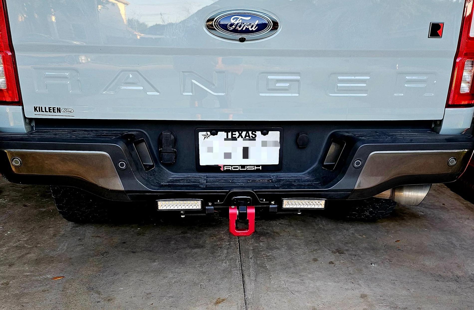

Yes, I have the 4" LED edition on my Ranger... works great... really illuminates the area...

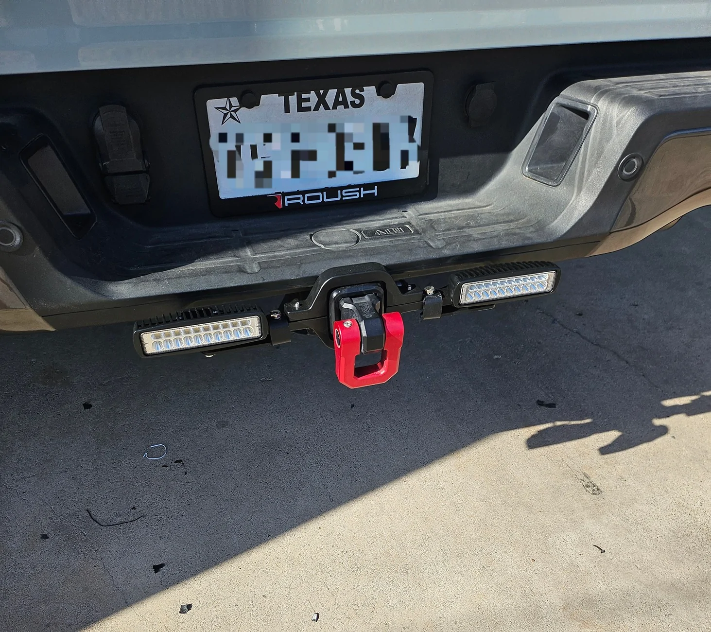

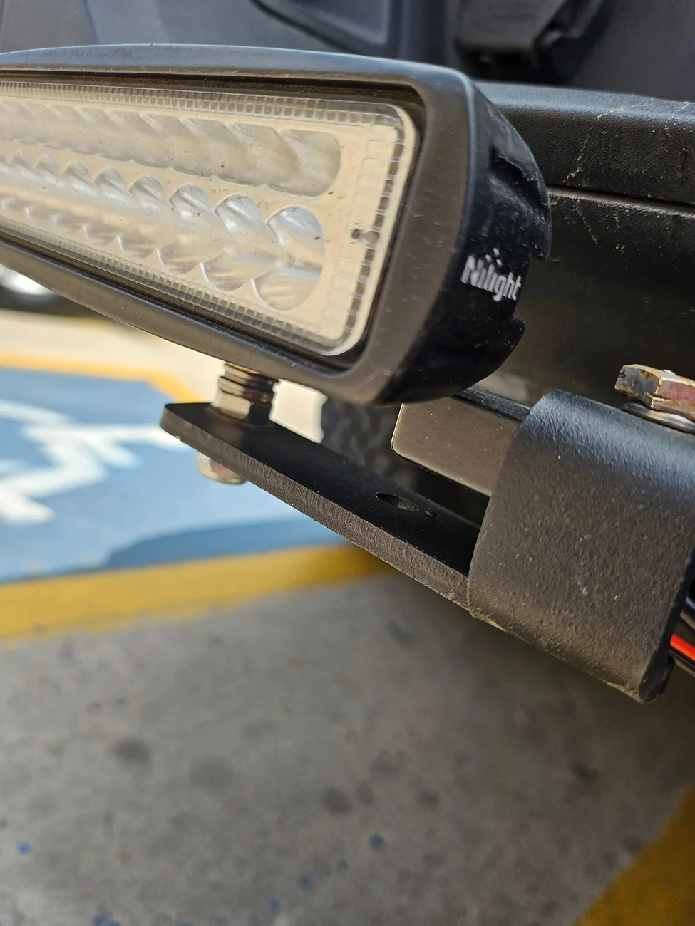

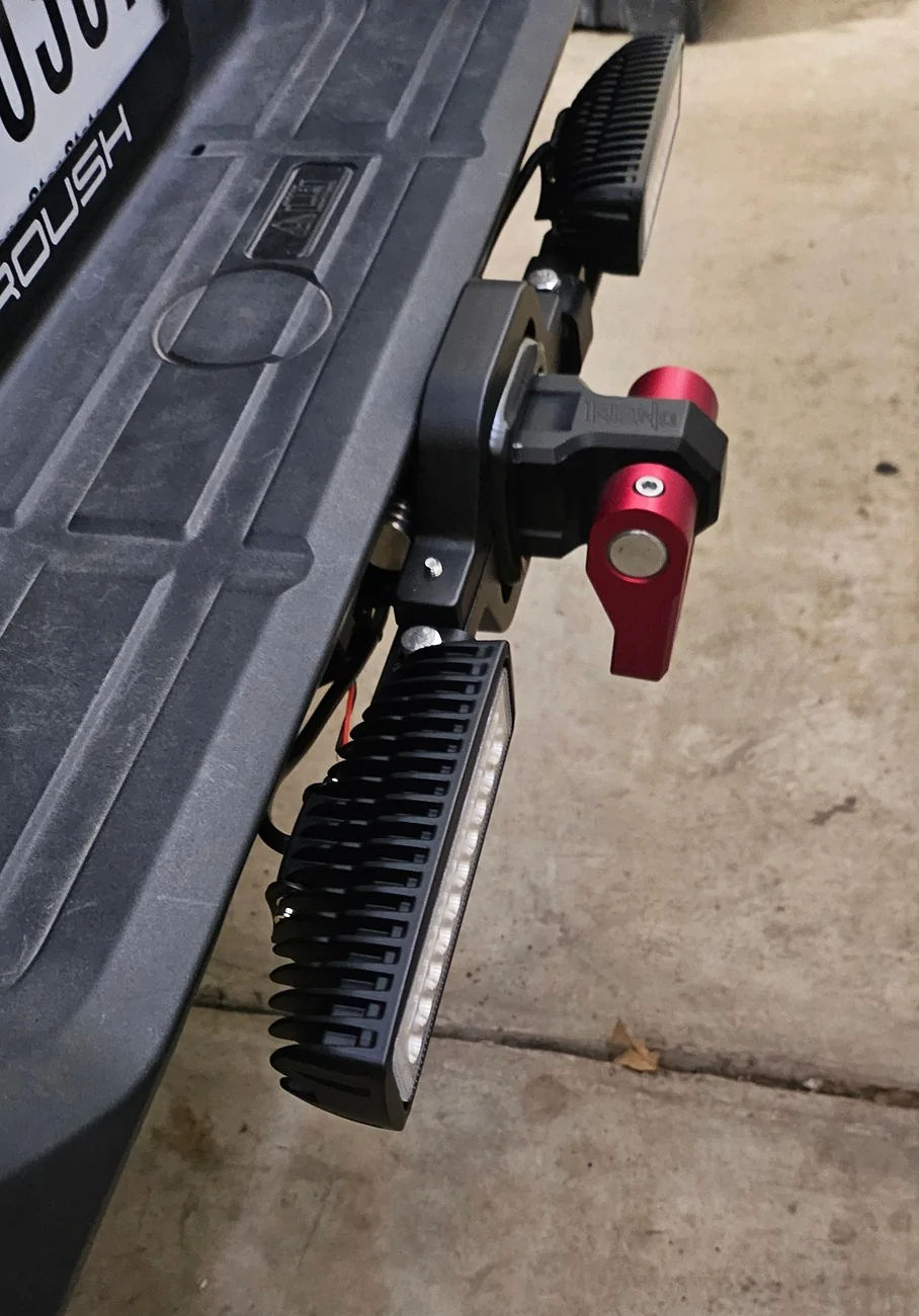

I'm pleased with it. It's powdercoated so, no rusting. It came with cheap hardware. I replaced that with SS right away. I made my own bracket extensions so I could get the exact look I was going for. Then I went off roading with it. I haven't had any issues with it. I went with the Nilight Bracket on Amazon. It had fewer complaints than the other versions of the same thing. I still have the Nilight 60w LEDs laying around somewhere. I might put them on my lawn mower. I found cheap lights on Amazon that had the look I wanted. I tried to do this as cheaply as possible so it wouldn't hurt too bad if the whole setup sucked. Surprisingly, it doesn't suck. Everything cost less than $50 (lights & bracket).

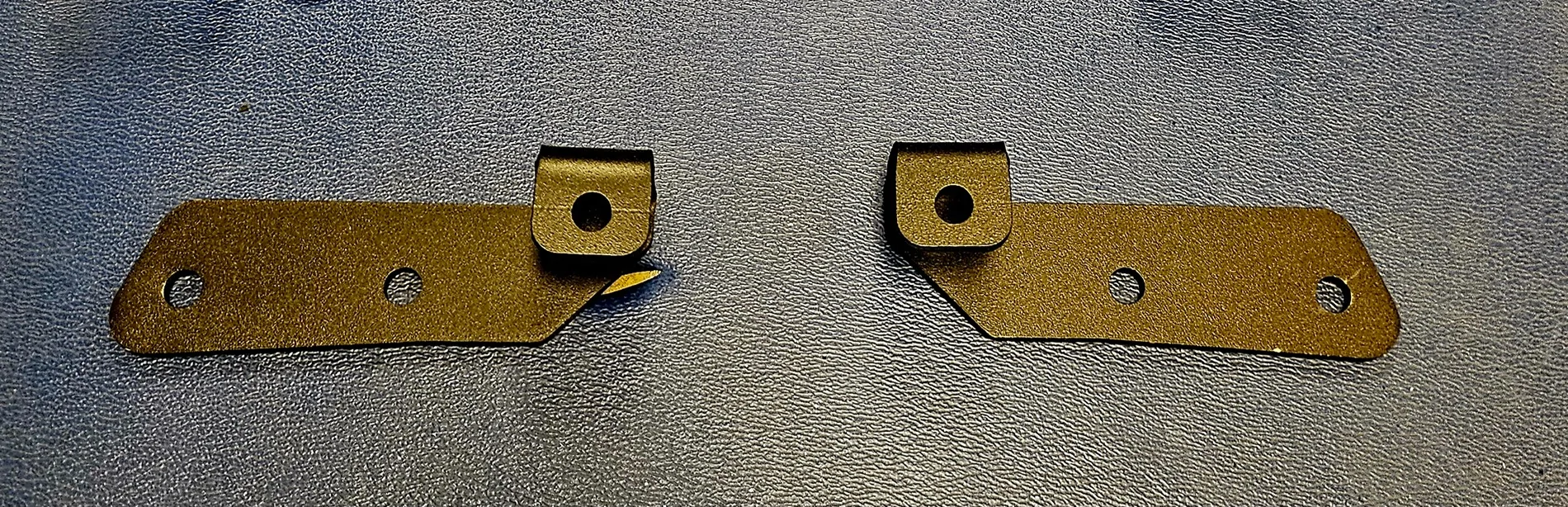

I like that. Not only does it spread the lights further apart, but you were able to use slimmer lights as well. :like:

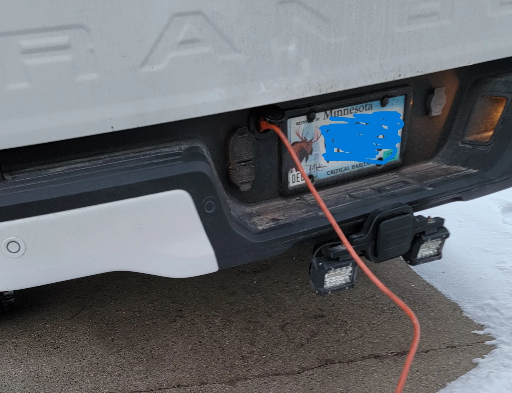

Is your truck a hybrid? Its plugged in!!
LOL... no... have a 2 amp battery tender installed
, mostly for winter, as the Ranger sits a fair amount. Had the plug installed there as I back in toward the garage. Tender is up by the battery.

I needed a longer bolt attaching the light to the bracket plus a bunch of stainless washers to get it to sit at the right height. And, the longer light pods hit the main bracket so spacers were needed. I was tempted to cut 1/2" off the long ends of the main bracket because it was hitting the back of the pod. I also mounted the main bracket upside down so it was less "noticeable". That forced me to buy thread covers at HomeDepot.
