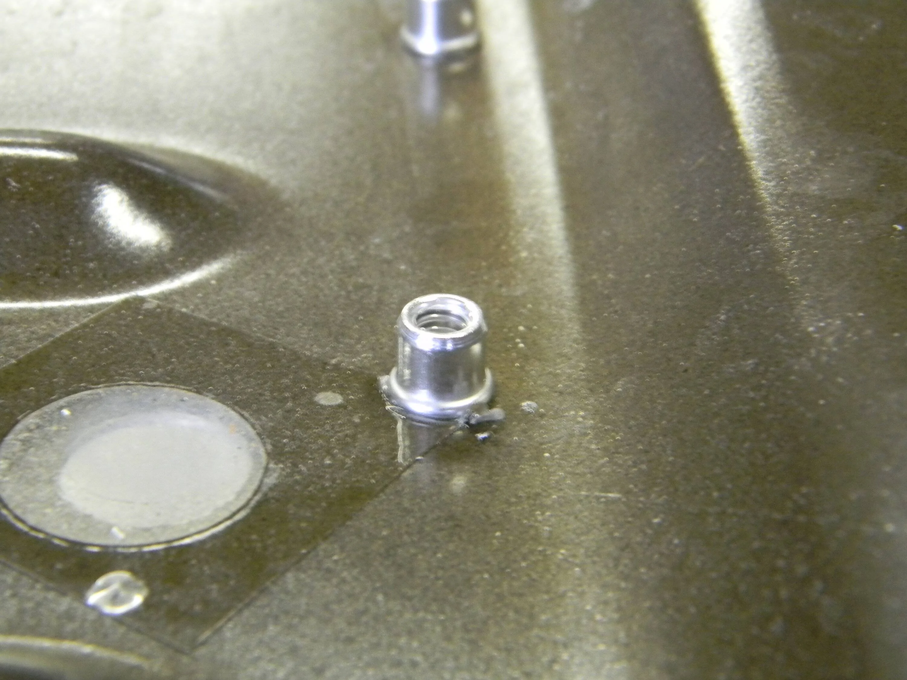

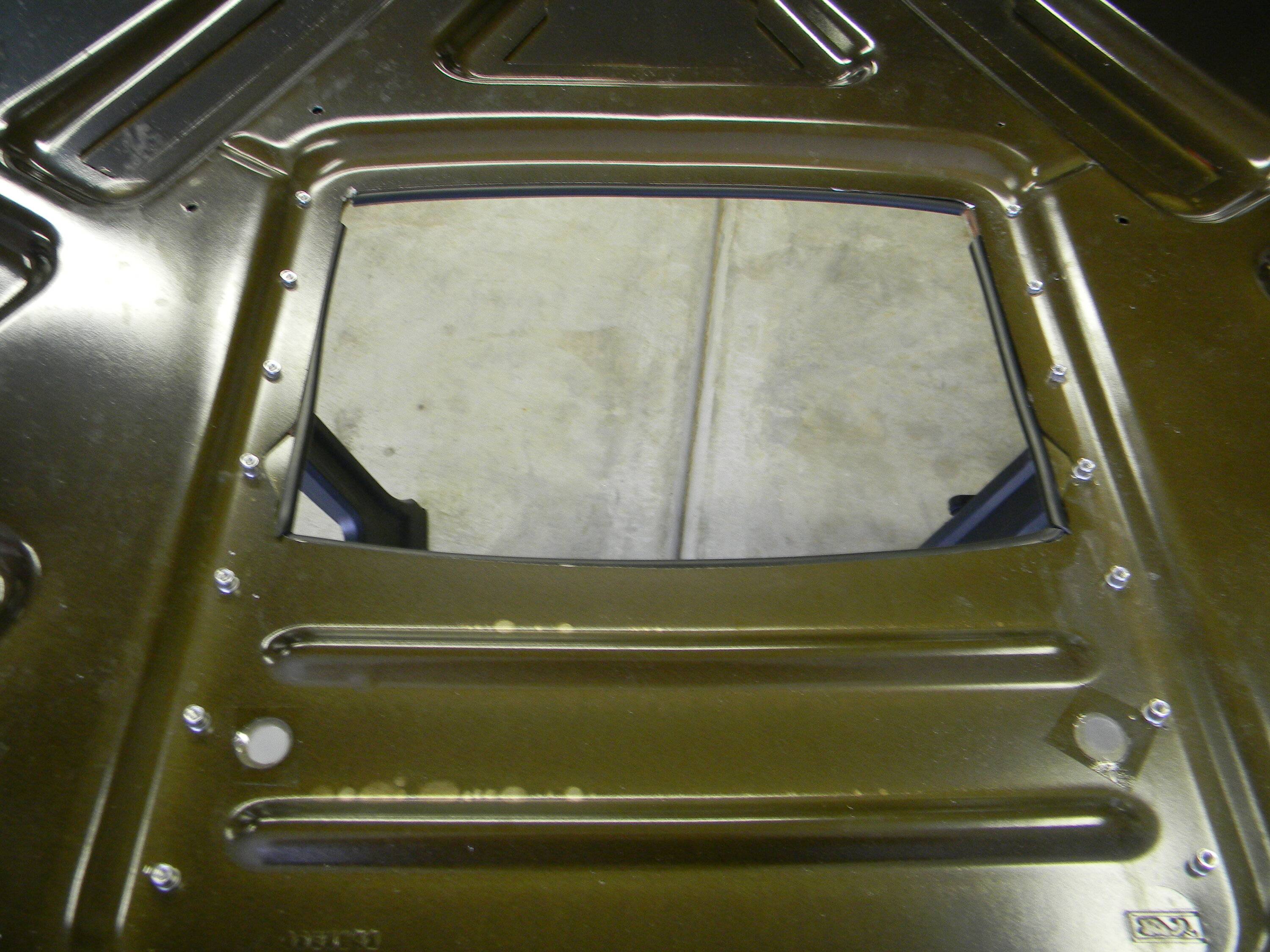

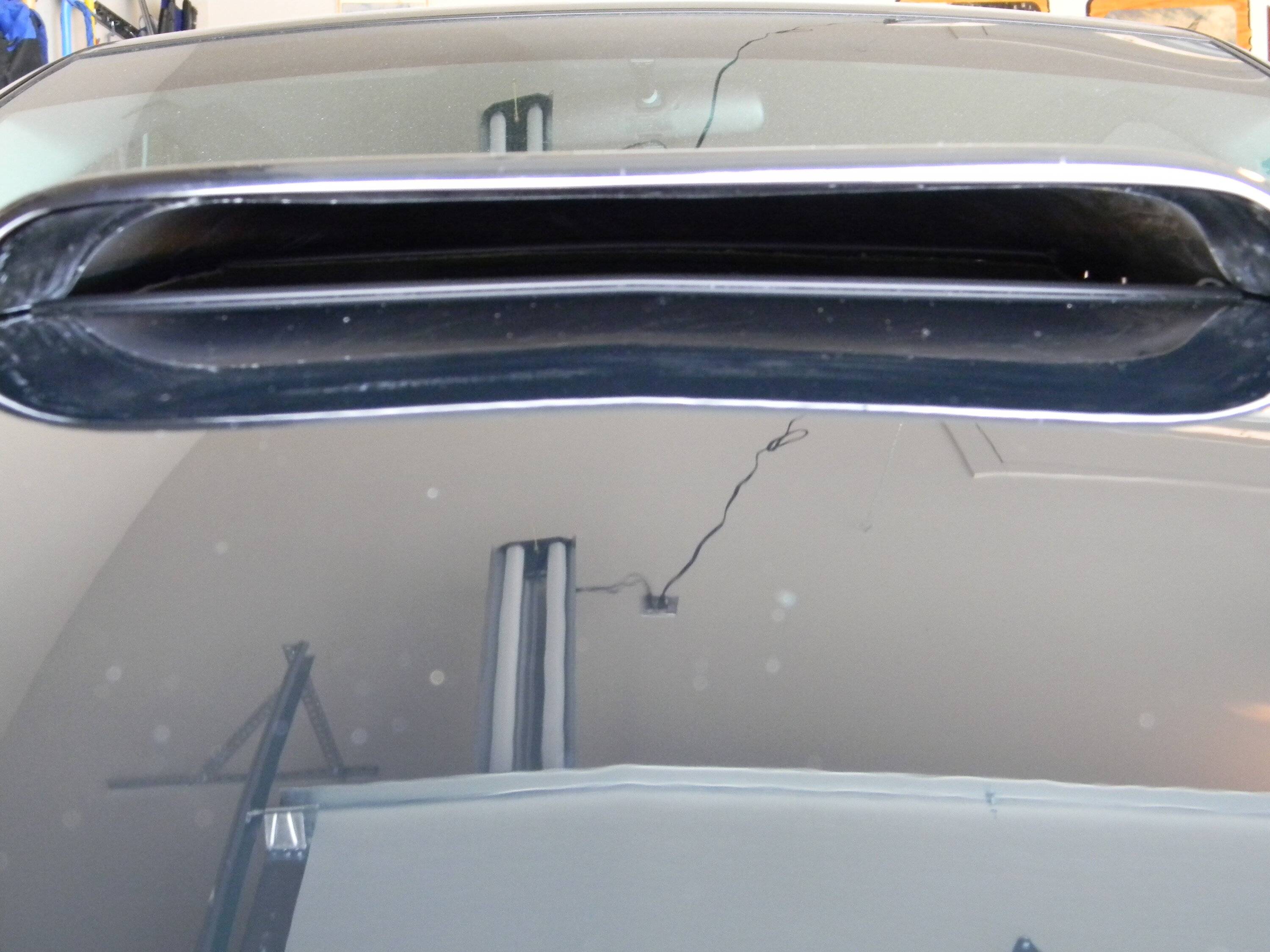

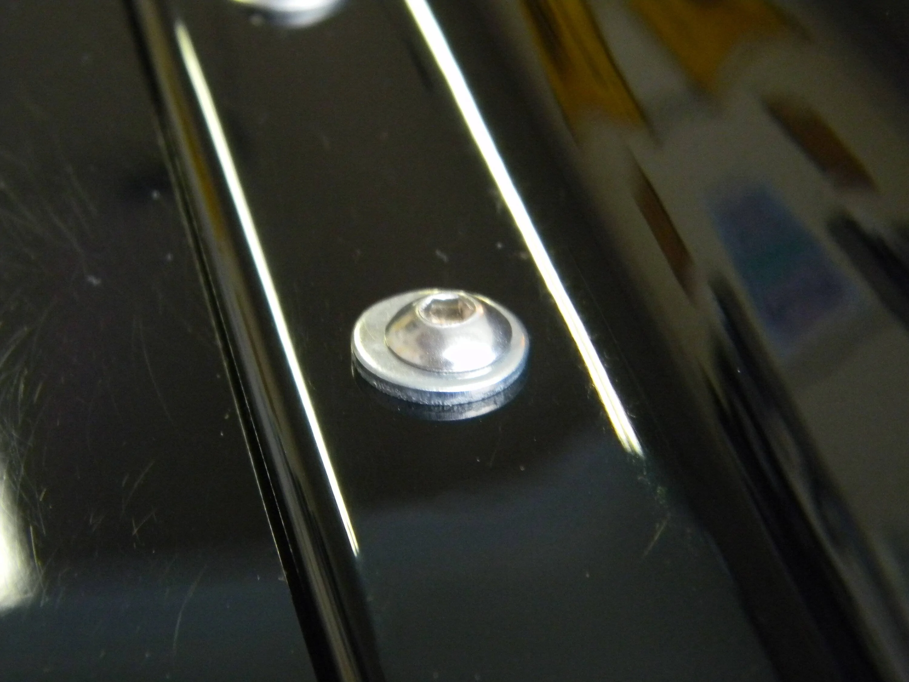

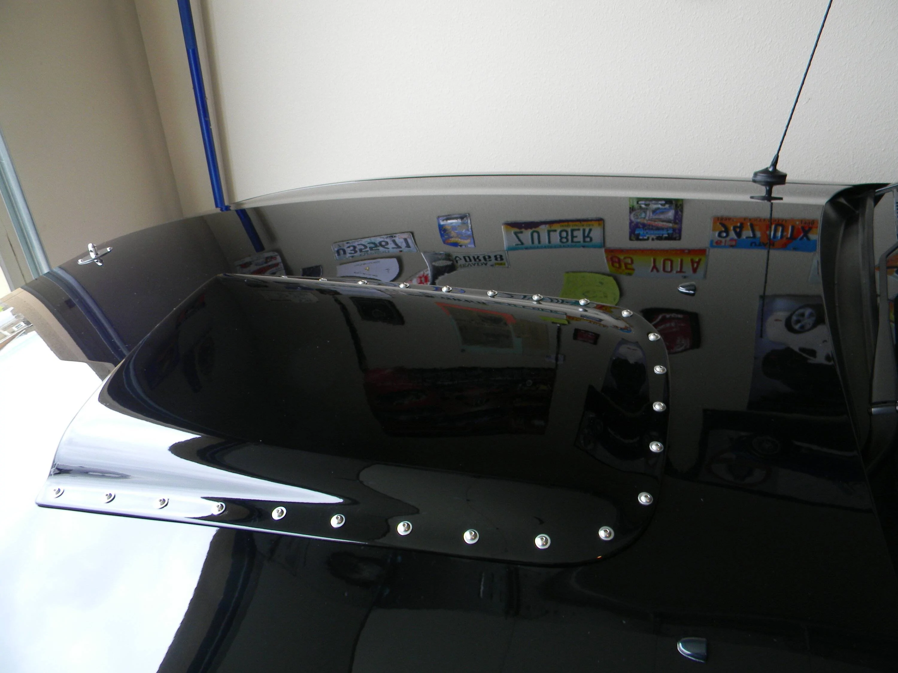

So just to give you a idea. I made my hood scoop on my Shelby functional. It came with a cosmetic hood scoop but I turned it functional which actually helped dramatically on heat release. My hood had the area available to be cut out. I then used blind rivets and then stainless button head allen fasteners to dress it up. It turned out well.

Not on the Ranger. If I did it, I'd look to get louvers in a kit or a scoop. You also have to be careful about not cutting the struts under the sheet-metal skin.

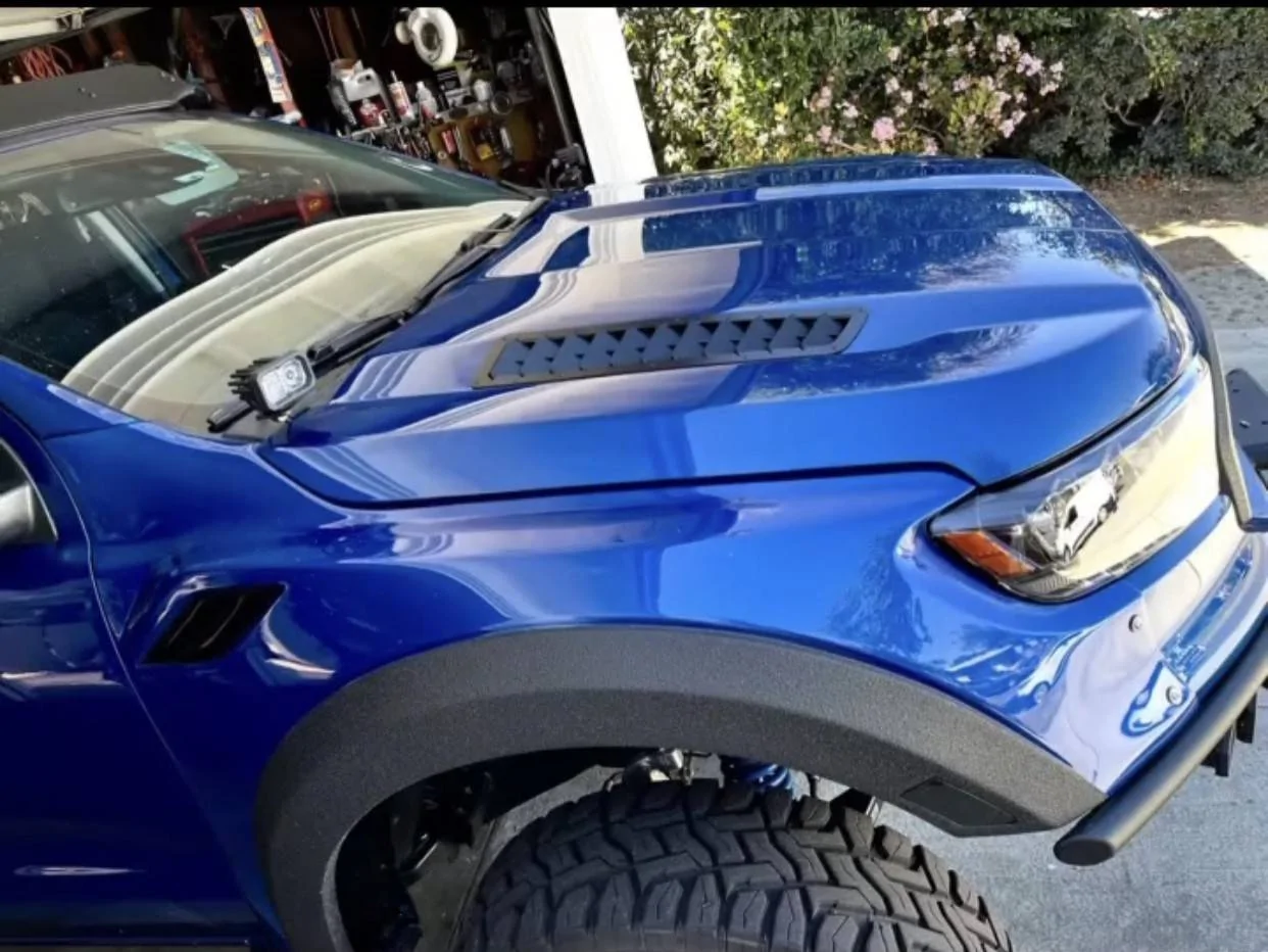

I should clarify they will be louvers aimed at extraction, not intake.
It has been done, but no idea if anyone who is a member here has done it.

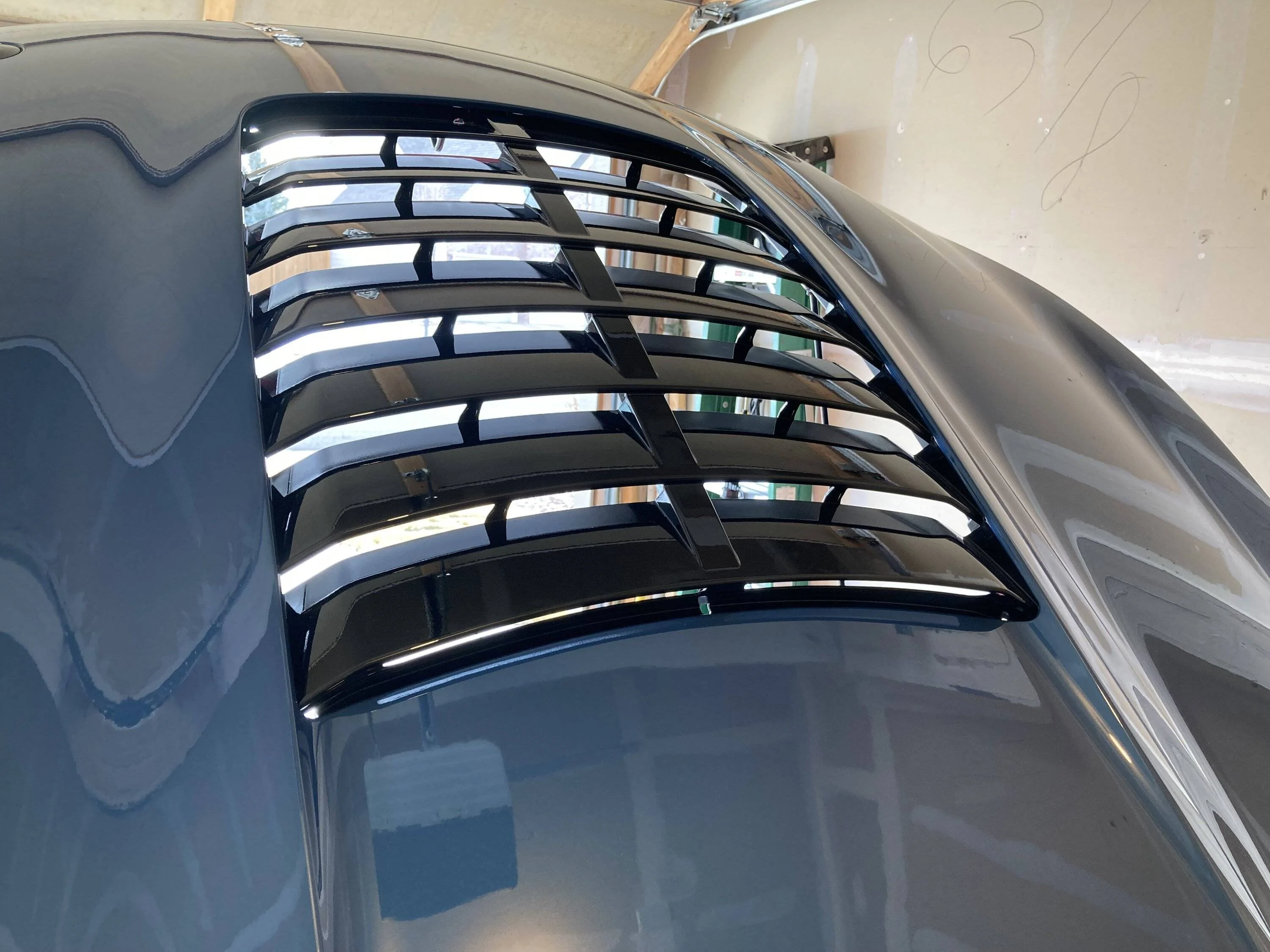

These are what I am looking at getting:
https://trackspecmotorsports.com/ford-ranger-hood-louvers

I like those . We did many such hood modifications when I had my business. Use a couple layers of masking tape on the area that will be cut out and draw out your cut lines perfect. Use a quality jig saw with a fresh blade for each side and just take your time. Cover the bottom plate of the jig saw with masking tape also.
Those look good.
I just wonder about water intrusion since there doesn't seem to be any water guides in the kit.
Maybe unnecessary with the Ranger.
I know some of the hood louvers on Jeeps have the water guides that almost completely cover the bottom of the vent, thus removing a lot of their heat extraction potential ie, the Grand Cherokee 5.9.
The tray is spaced away from the hood so heat can get around them, but they still look like they would block a lot of heat from escaping.
