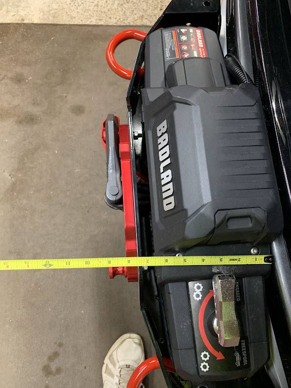

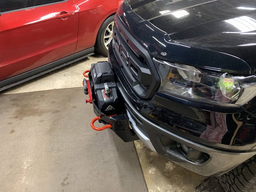

Its a Westin winch tray and a 12,000 lb Badlands winch. Had to modify the skid plate because when you remove the stock tow hooks you lose the mounting point for the front of the plate. I used a Riv nut on each side into the support arm of the tray and then drilled matching holes in the plate, had to trim the plate to fit around the arms as well but that was all easy stuff.
Nice set-up. Thanks for the extra photo's.

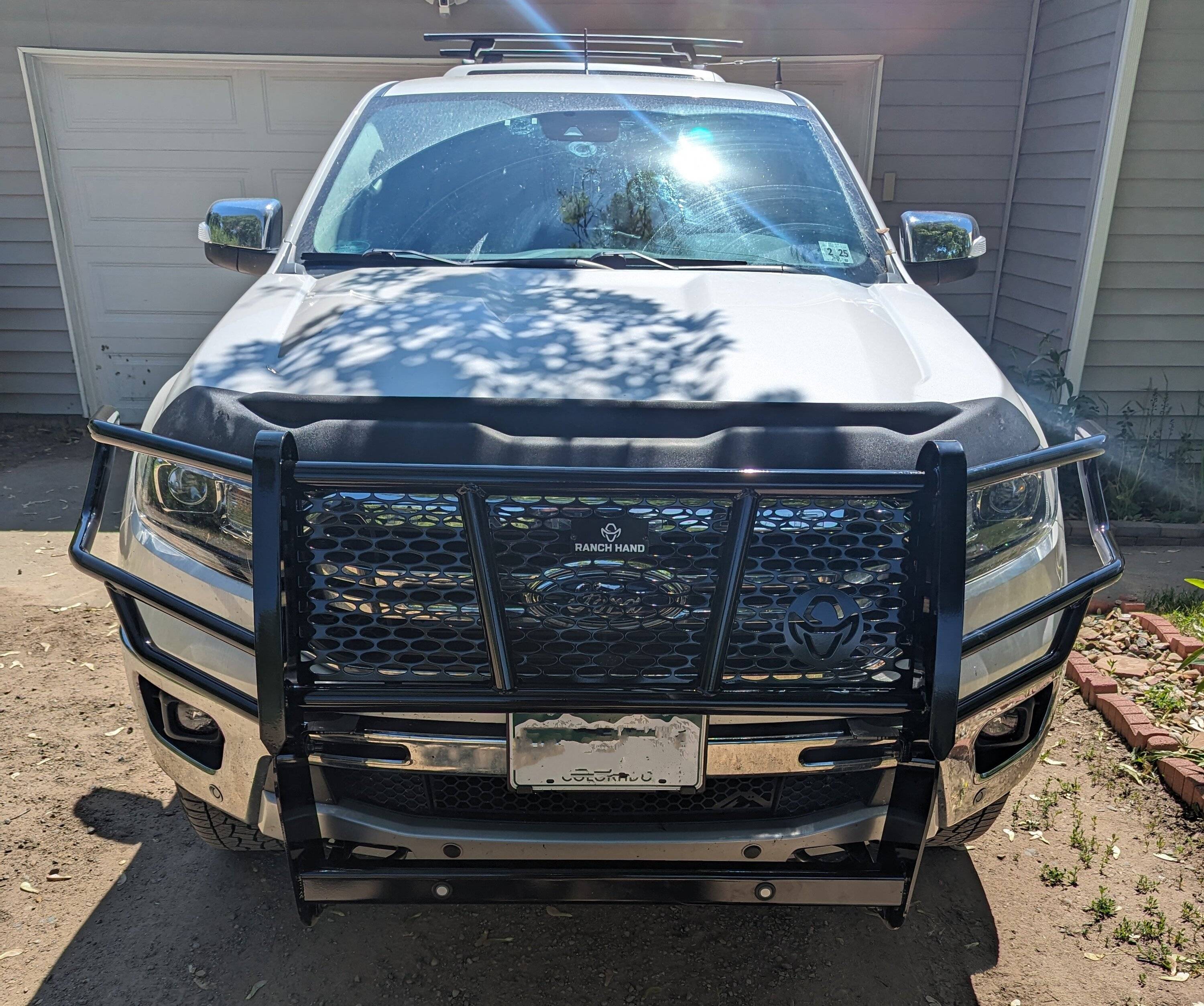

Adaptative cruise control is a black box located behind the grill, the parking sensors are located in the bumper. Most if not all of the bull bars and other assorted items will block the parking sensors so those will need to be relocated or turned off.
There are relocation brackets for the adaptive cruise control boxes as well.

Ranch Hand with front sensor.
