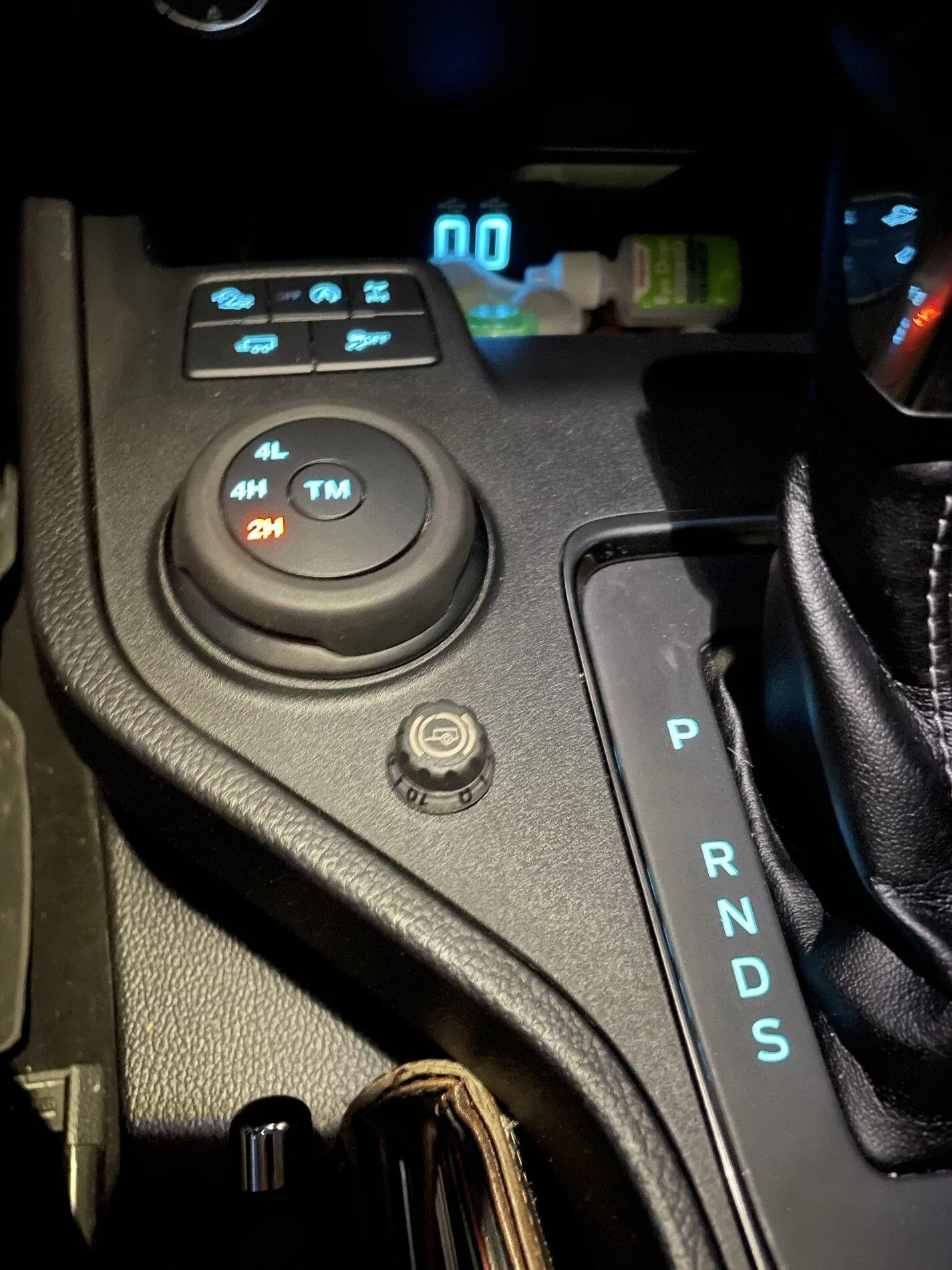

I’d like the knob larger, but dealer did nice, left knee high, colorful light knob.
i use the small, center push knob t to check brakes before towing. Just slightly rolling, then pushing the knob to apply selected brake force.

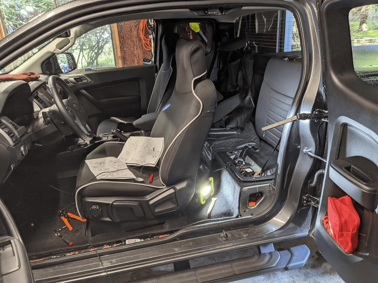

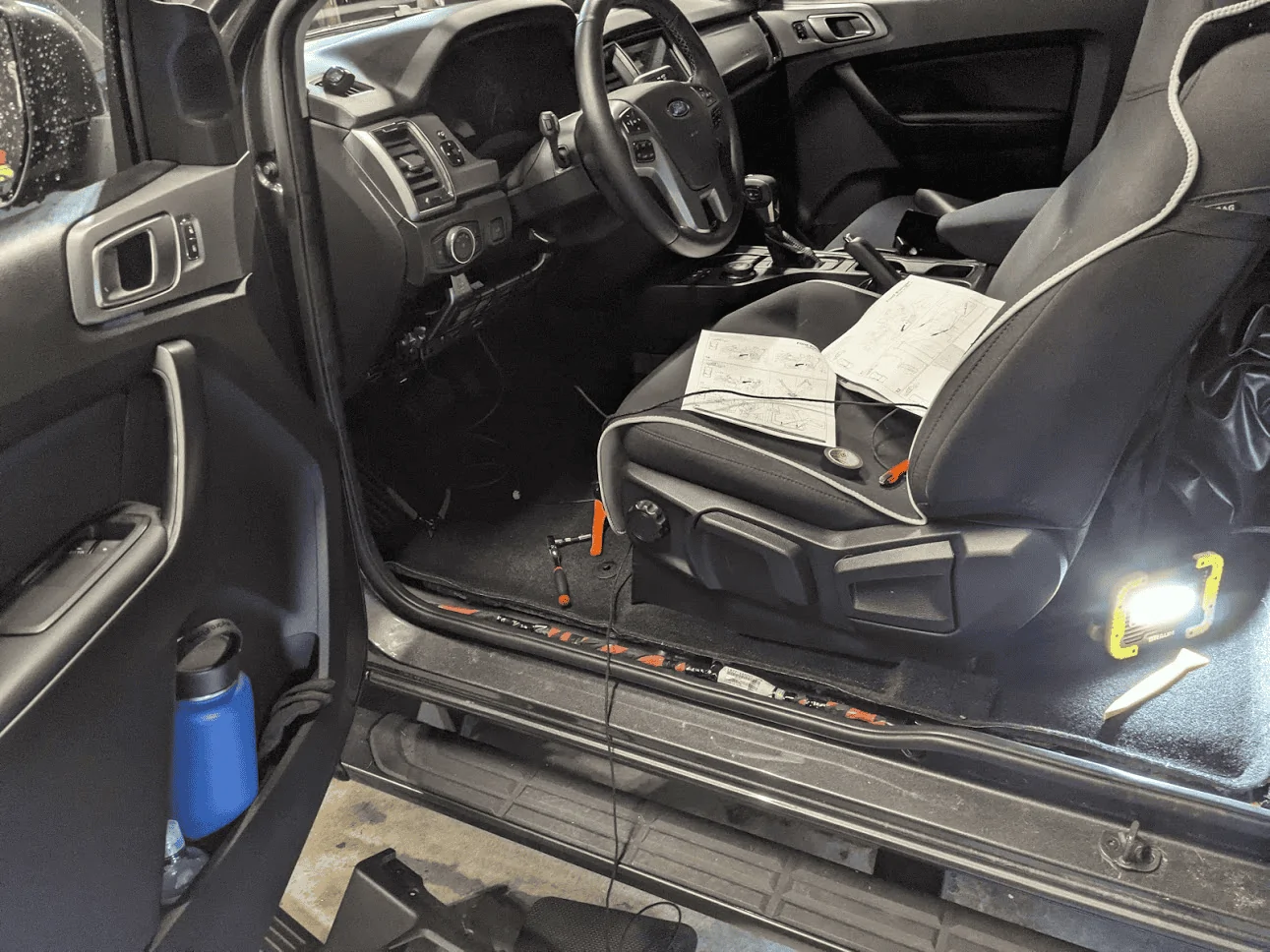

It's not plug and play at all. If it's the Ford one with the emergency brake module, it is quite involved.
Normal Redarcs would be a 45 min process but for the Ford one you need to pull all the trim from the kick panel, to the back of the cab so you can run a wire along the floorboard, and up to tie into the 3rd brake light. It's not a difficult mechanical install, just tedious and time consuming. 90% of the time is running that wire back.

Not quite plug and play. There is quite a bit of work involved to install. Involves removing several internal panels to route wiring to the center high mounted stop light at the back of the cab. Assembling connectors to said stop light. Installing two modules under dash and the control knob. The last of which requires drilling a hole in your selected location.
So if this sounds like something you are comfortable doing, fine. If not maybe $150 for dealer to install is a better deal. Lots of good threads documenting the process. But, no required dealer programming needed.
