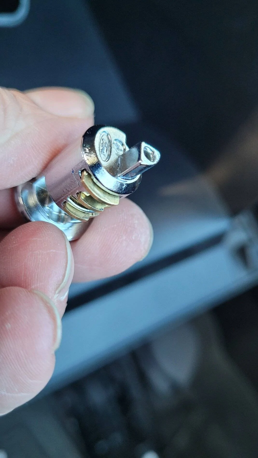

Well I got it fixed..
You will need the physical truck key, a small flat bladed screwdriver, and a 5/8 c-clip.
Talk about the cheapest method to secure the lock to the latch. No wonder it rattles.. Upon inspection of the lock I discovered that the lock tumbler is held in the glove box handle by the tiny spring loaded tab at the very back of the tumbler just below the beveled edge.
To remove the lock tumbler open the glovebox and insert the truck key into the lock. Next while holding the key in place look at the back side of the lock tumbler (inside the glovebox door) and take a small flat bladed screw driver and press the third tab that is barely visible towards the tumbler core. once pressed in twist and gently pull the tumbler out of the door.
Now here's where it get's a little fun. I was not able to find a nylon washer or c-clip that fit exactly onto the backside of the tumbler. The 5/8 c-clip is a very close fit, just needs about 1/8" of clearance to lock into place. Unfortunately there's not enough clearance for this and the next size up is too large unless you bend the crap out of it. So to secure the c-clip to the back side of the tumbler take put a tiny drop of super glue on the back side of the tumbler face and press the c-clip down till it bonds. Once bonded carefully reinstall the lock and test.
Once re-installed the lock tumbler still actuates smoothly and the c-clip closes the gap so it eliminates the rattle when unlocked. You may get lucky and find a clip that will fit better than what was able to find, but at least for now this works and no rattles.
