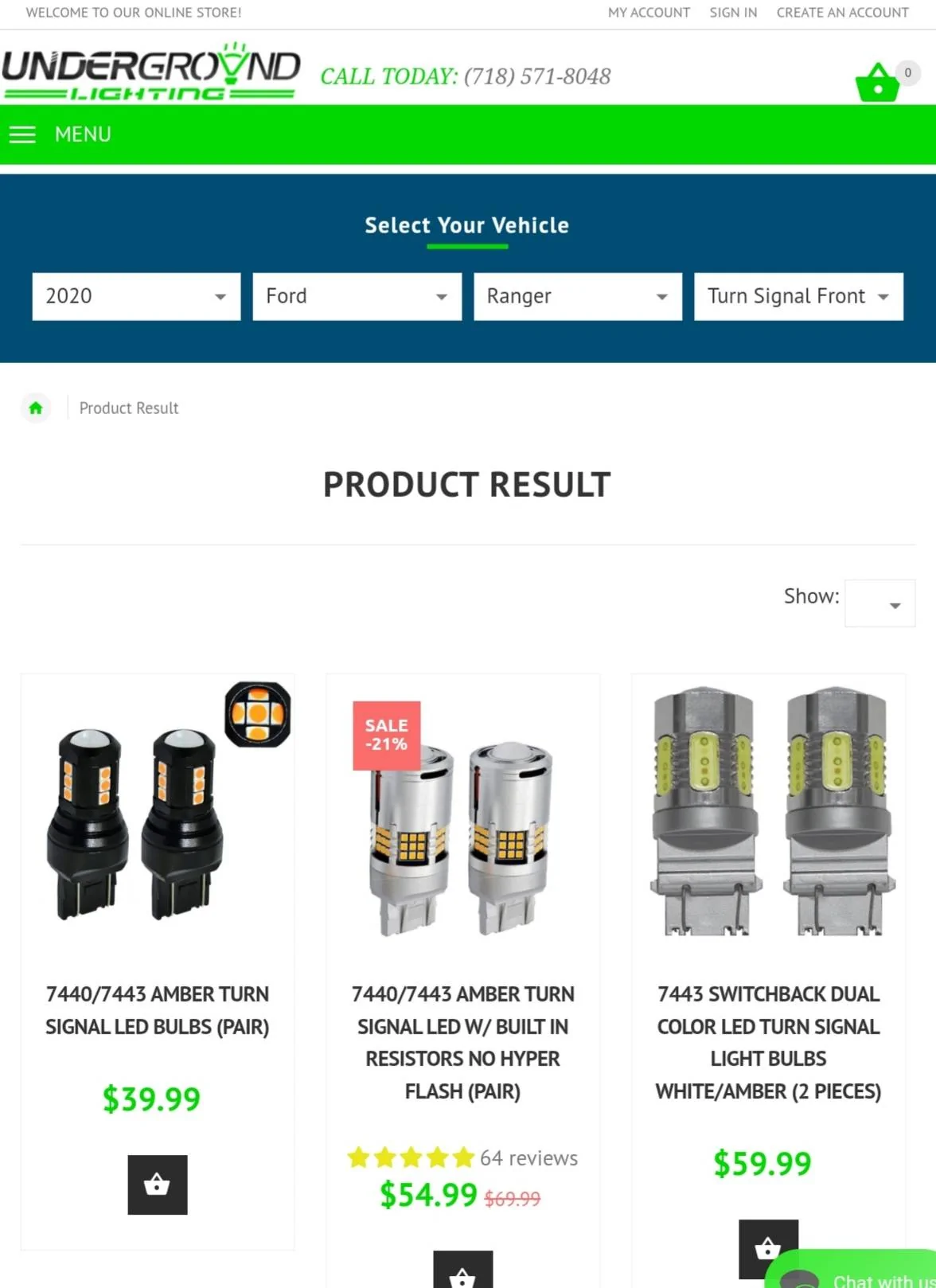

Anyone out there using lights like this? They claim no hyperflash.

Not to sure if anyone has gotten luck with the drop in led turn signals. I do know that the Rangers do well with the full LED assemblies like Alpharex and Morimoto

I have LED switchbacks my XLT. It is a simple setting in Forscan to get rid of the hyperflash.
No need for resistors or expensive bulbs.

Only one small problem with that. Those that do not have Forscan at this time or dont habe an extended license may not be able to male said adjustment. Unless you can get the free trial license then maybe its all good but im not too sure on that.
