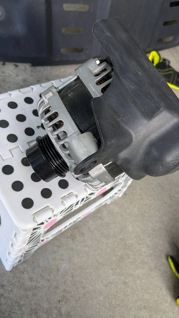

I attempted this over the last day or so, and for the TLDR crowd, gave up and abandoned the idea.

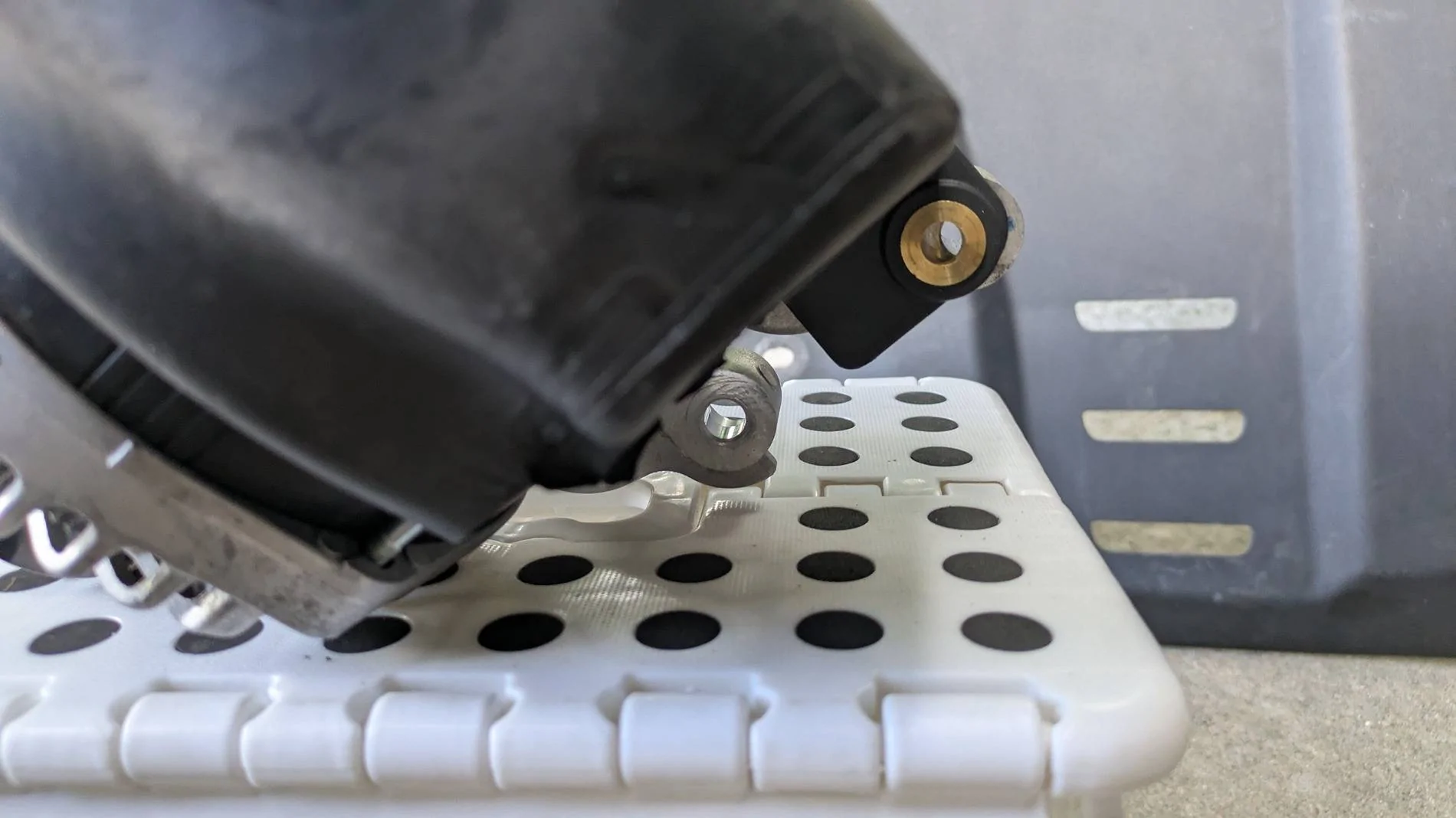

Couple photos showing the orientation of the shield on my alternator, which as you can see, is off the truck.
I was committed to the project. Even with the alternator out I could not figure how to get the shield and the alternator in place at the same time to bolt up.

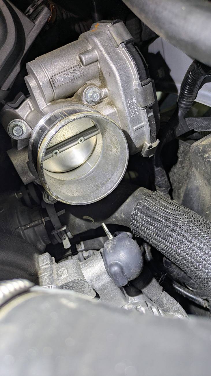

You need to remove the hose from the intercooler to the throttle body for access to unbolt the upper mounting bolt where it would line up if there was room for it, which there isn't.

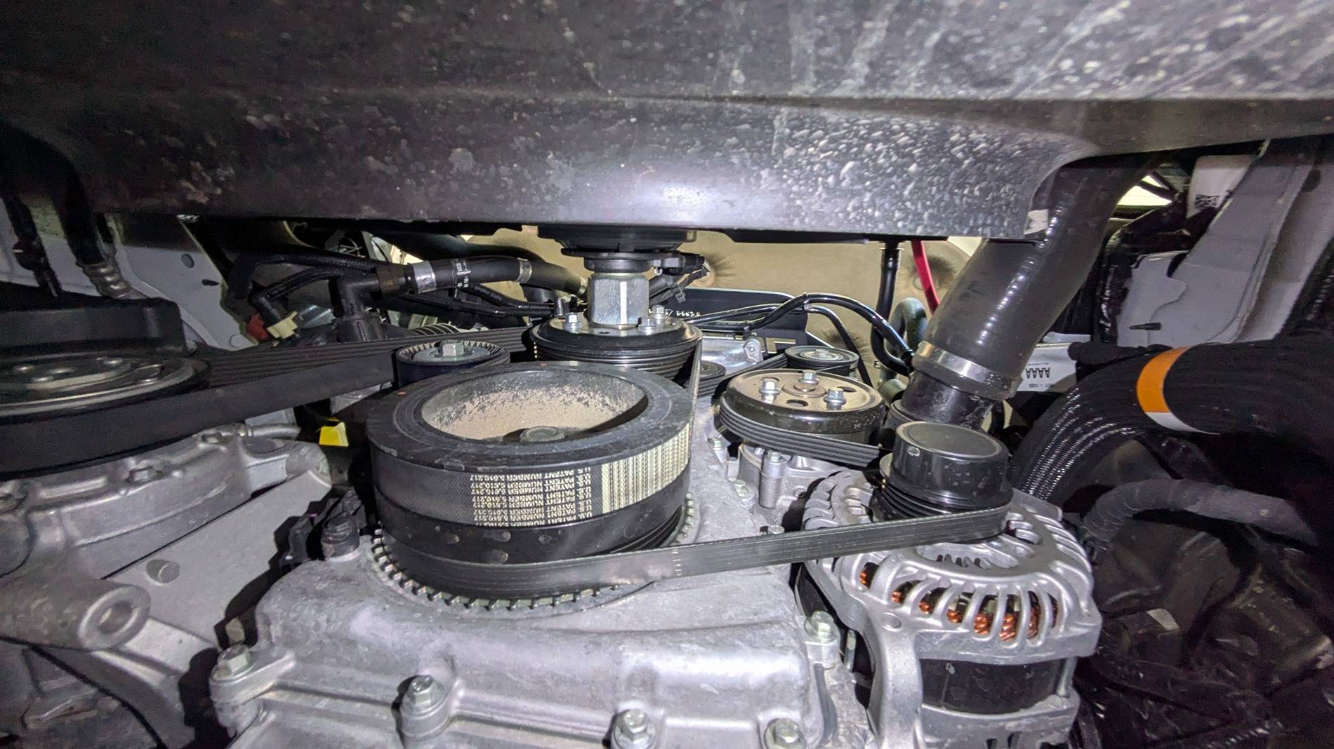

This was a photo from beneath I took for reference on the belt routing for putting things back together.
If you can get this thing in there you're a better man than me, it just doesn't have the space to slide in laterally with the alternator in place, which is how it seems to need to mount.
I bailed, anybody considering this I'd save your money. Wasn't a total loss it was basically a dry run for an alternator swap for me. Just didn't work out for the mud shield.
