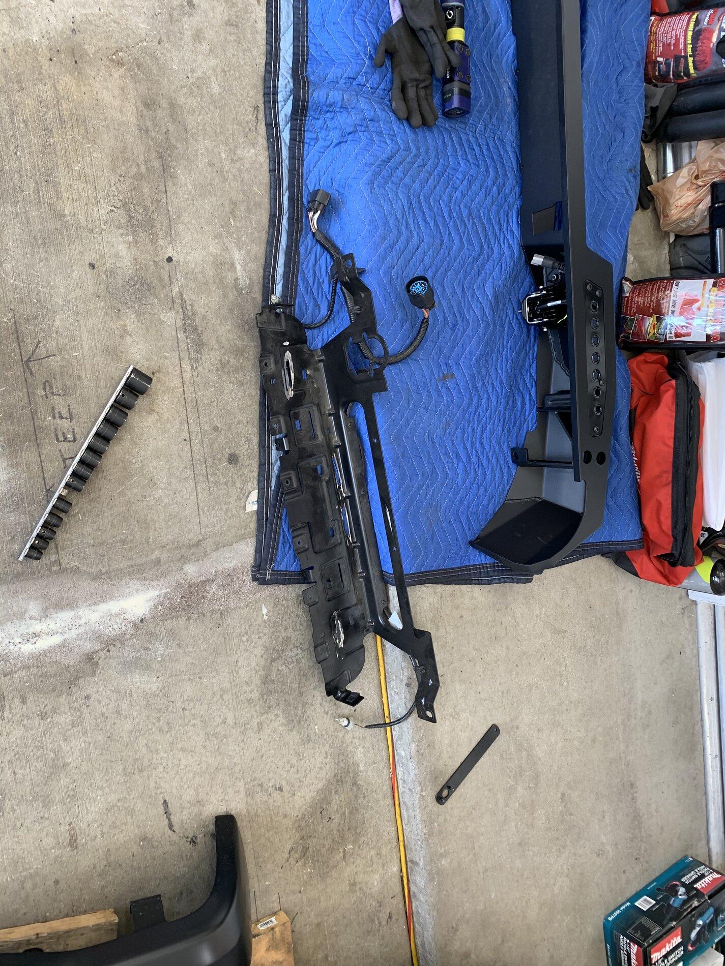

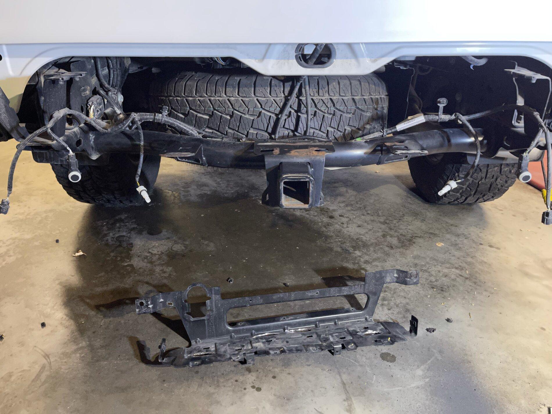

Unless they are going to completely redesign the rear bumper to integrate the hitch receiver, you may be out of luck. The rear bumper bolts to the hitch receiver which is bolted to the rear frame of the Ranger. The bumper itself is not structural at all, it is purely cosmetic. Sure the aftermarket rear bumpers are thicker/stronger/etc. vs the stock bumper, but nowhere near strong enough for a hitch. Pic attached shows the factory tow package hitch with the rear bumper completely removed.
Thank you for this picture - worth at least a thousand words. Prolly cost prohibitive to ask them to re-engineer something to work, and I am unwilling to trust something that my welder buddy could help me make.
I did reach out to ICON - they said they have a rear spring kit coming out for the Ranger in the next month or so, several leaf springs, at least one removable/reversible to adjust for load. I had already planned on using - will see if I can balance hitch-height v. ride quality with that and the stock tow hitch. Cheers :)
You're welcome for the pic, I figured it might help let you see how it is designed from Ford. One thing for you to consider though, maybe call and talk to RPG about their rear bumper. In the description from the link you shared it does say in there "integrated trailer hitch" so maybe their design is completely different. It could be worth a shot, especially if their bumper is designed to also be the hitch, then maybe you could have them put the receiver between the tubes so it is higher.
