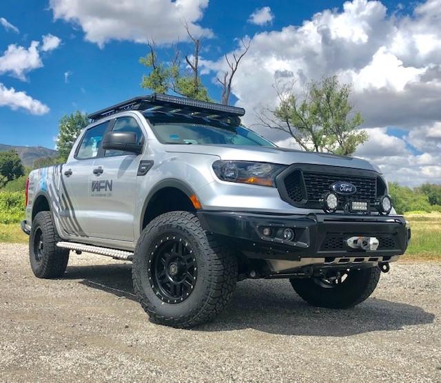

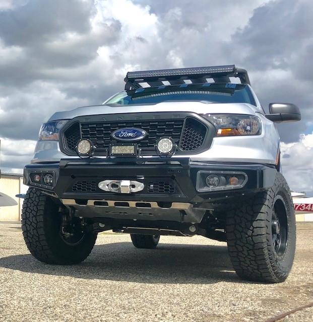

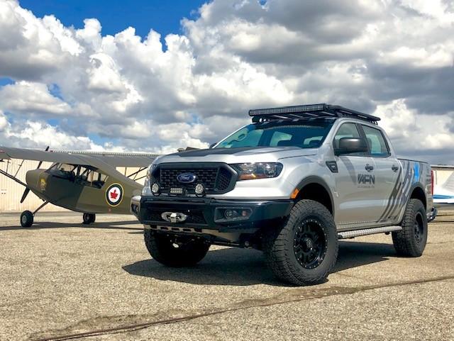

Here is some better pics... Still need to swap out the lights for some better stuff...

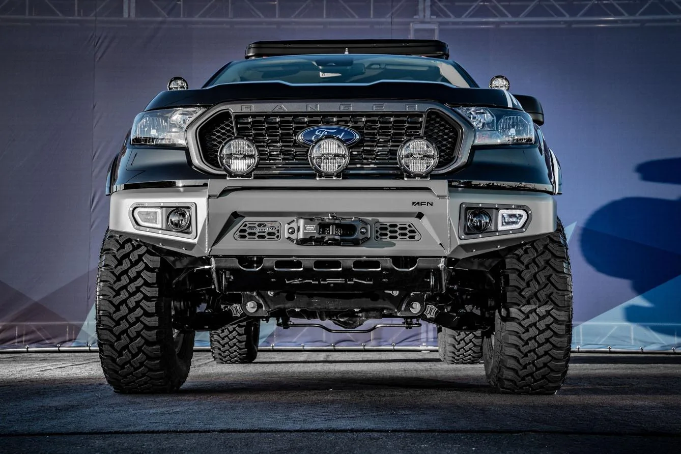

it is shipping with the sensor holes and it they have the updated turn signals pictured below.

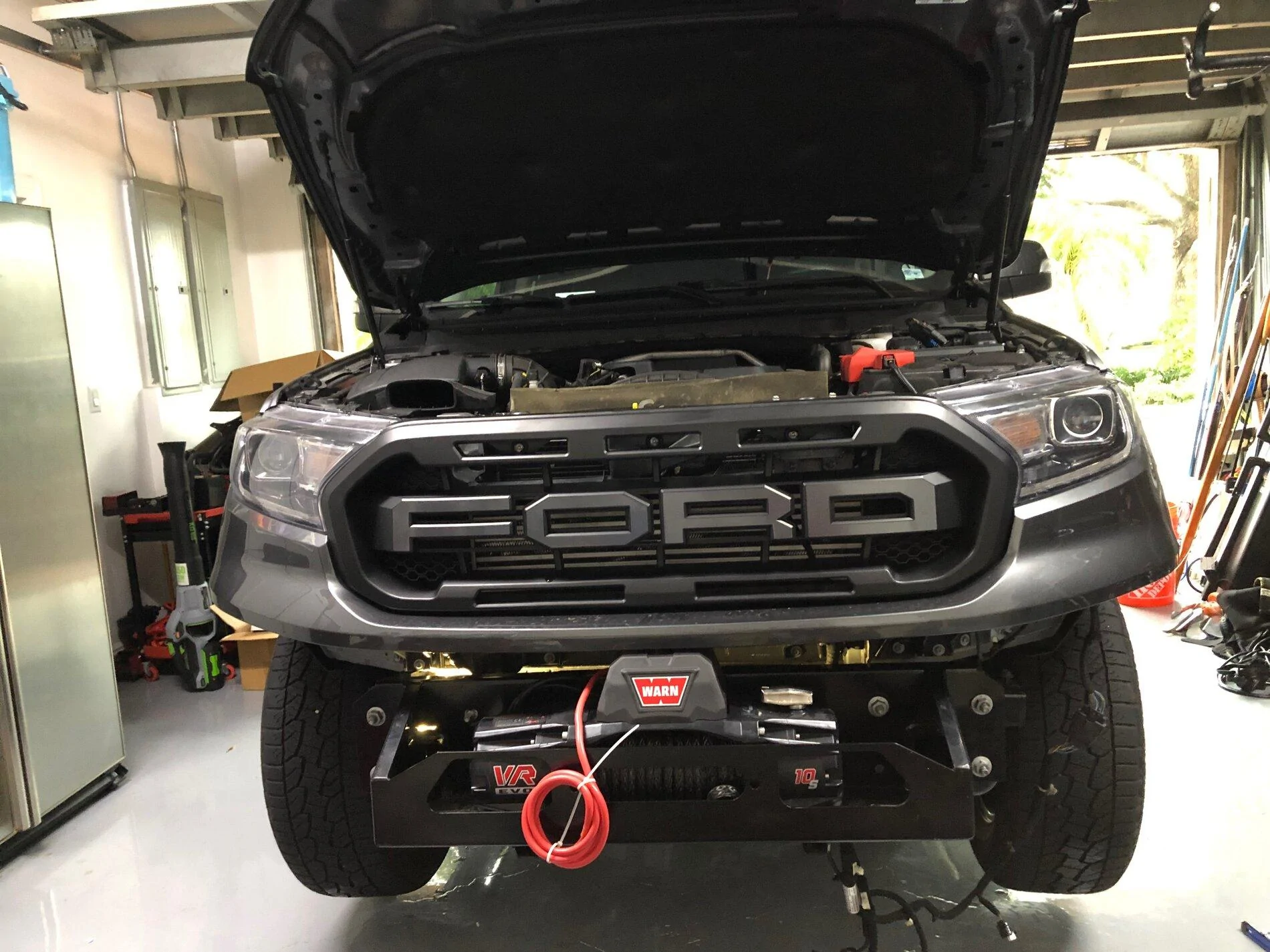

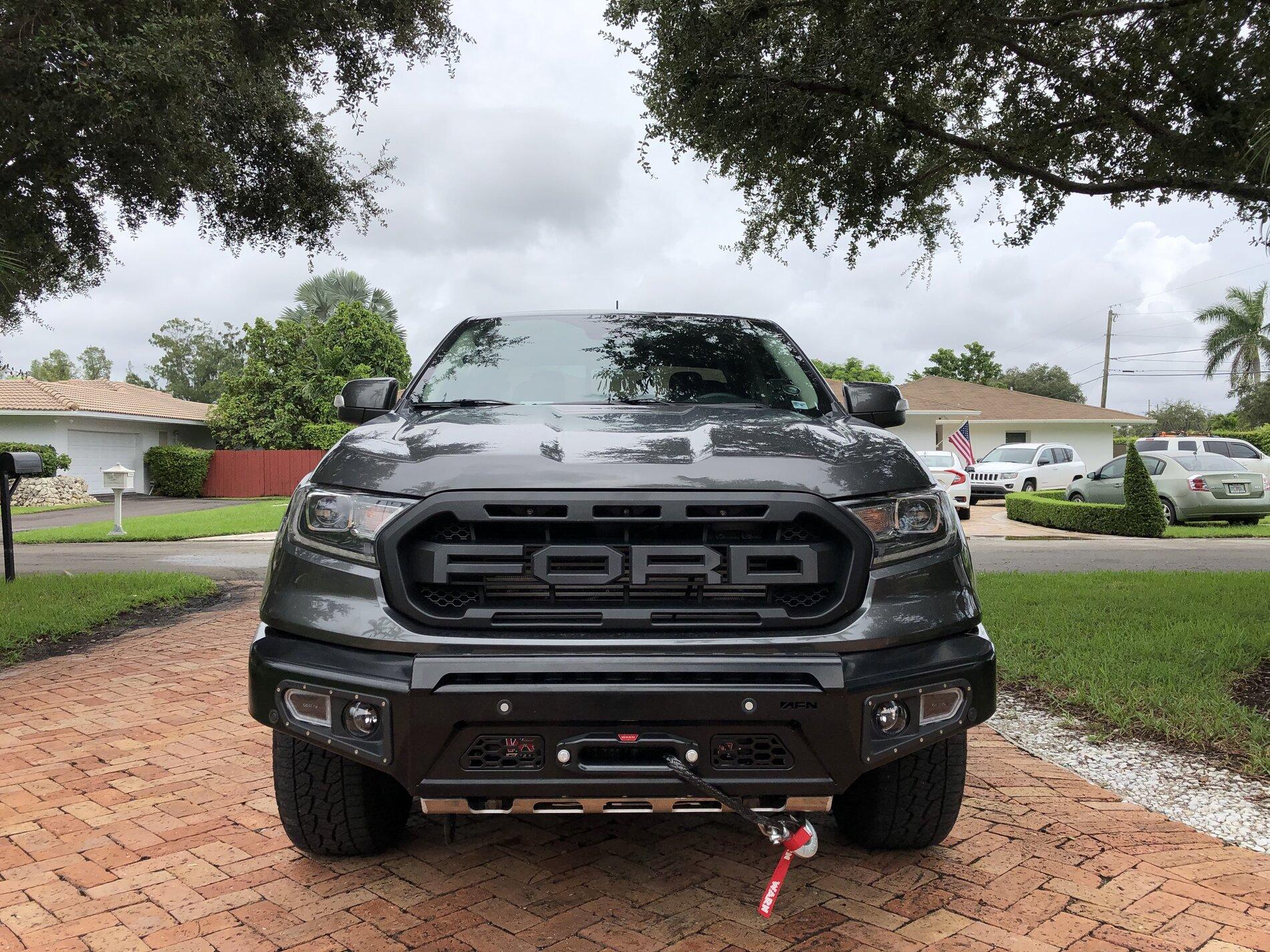

I'm running it and have been really happy with it so far. I even thought I would have to relocate the winch controls on my Warn VR10s, but ended up being a tight but great fit. Here's a picture of the winch clearance:
Post-install
The lever on my winch can be accessed easily from the top. There is an access port on top of the bumper, behind the right side of the raised light mount. It's really easy for me to flip the lever. Plugging in my winch remote is a little tougher, but still doable. Thankfully I will be able to just run wireless most of the time to avoid having to deal with that. There is also another access port on the other side. Alternatively, and depending on your winch setup, the grilles in the front to each side of the fairlead can be pulled off for access.
