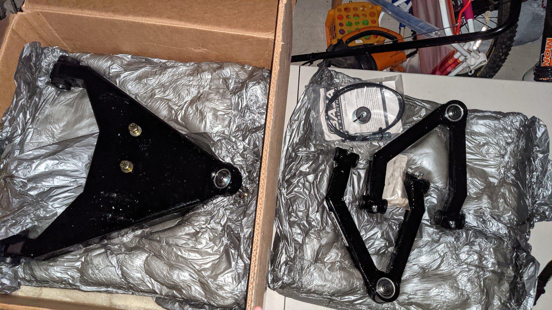

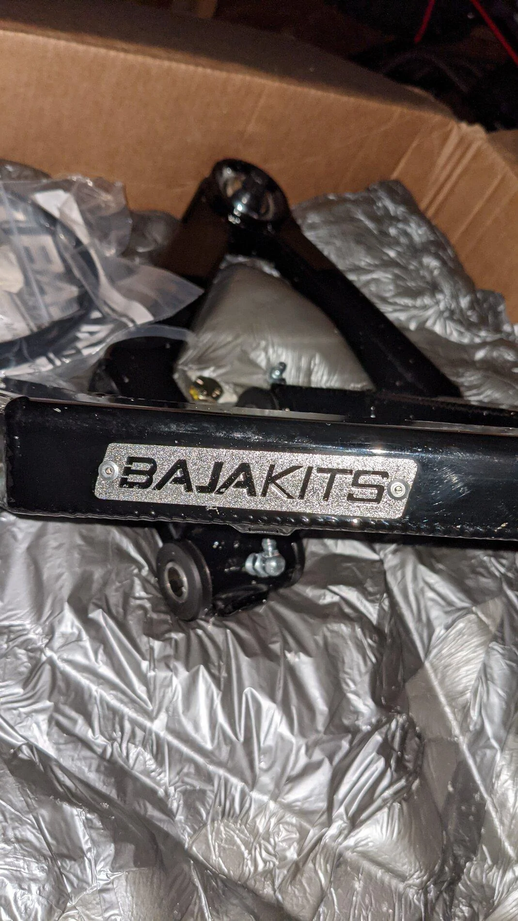

So I got the Bajakits LT kit for the front it came in yesterday

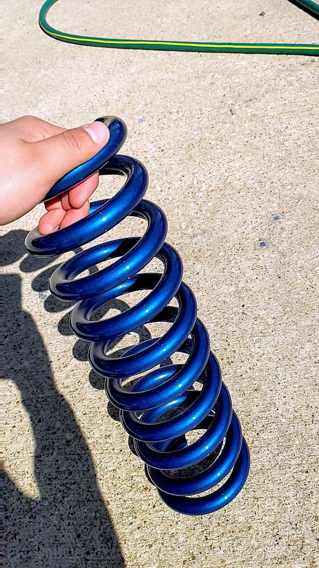

I'm gonna see how it goes with the eibach 3" lift coils on the bilstein 5100's at the lowest setting so no messing with preload (I am currently running the 5100's with stock coils at the highest setting so about 2.4" of lift) and I got them paint matched
And in the rear I want to bolt some mounts to the frame and run a bed cage to the mounts with like a 16" shock strapped at like 14" or something with deavers springs. I'm getting the front installed this Friday but the rear cage will probably take me like a year to do by myself I have a ton to learn about cycling suspension. If anyone makes a cage I'll buy it by this summer.
Wow! Thats going to look really good!???? What comes in the kit?

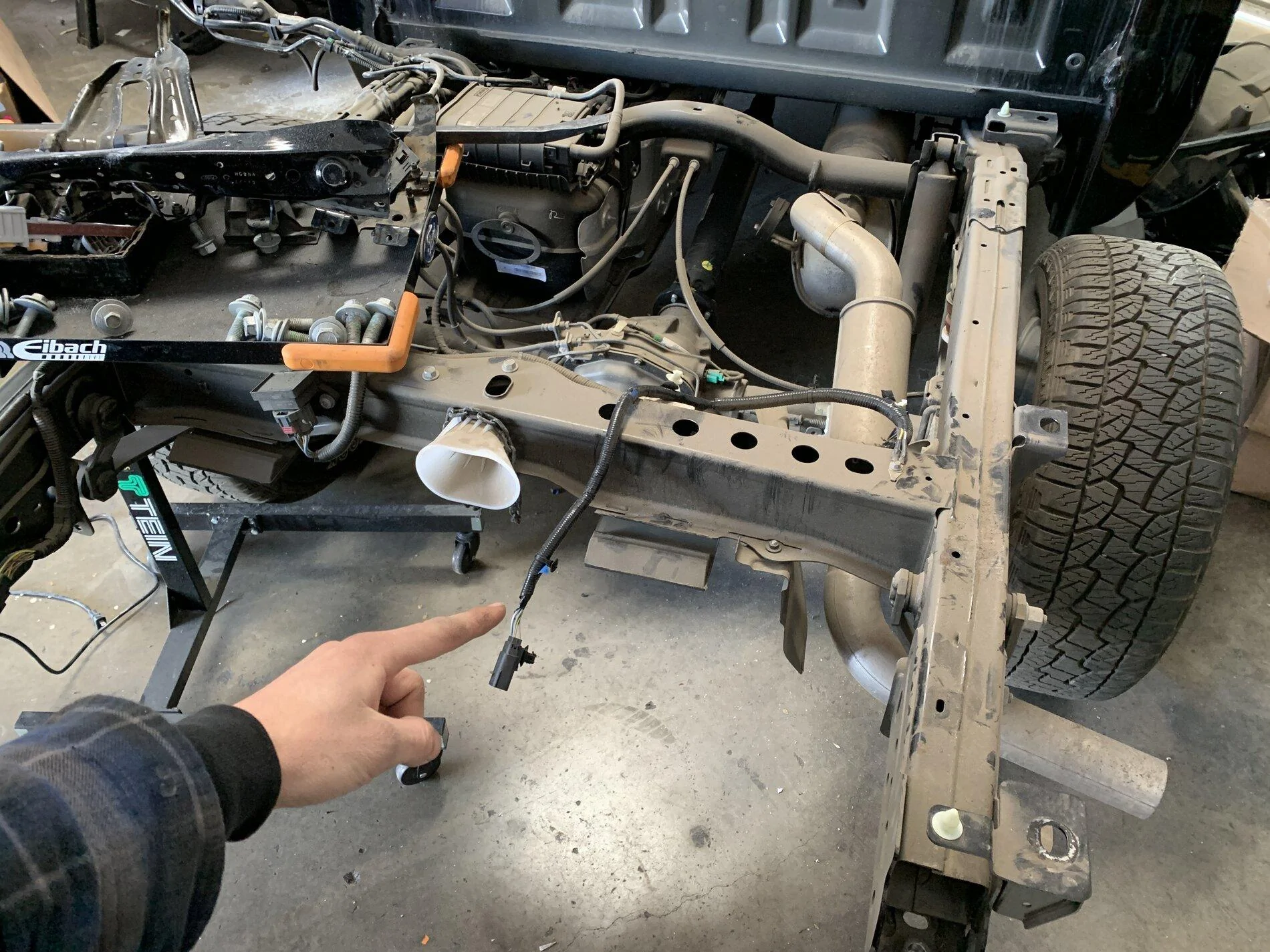

I had the same thing it turned out to be the wire harness attached to bottom of the bed
Now that I'm looking at this again, no I unplugged that wire that's what I was referring to when I said I unplugged the tailgate.
My problem was around the fuel lines it looked like wires were connected to the bed but in your picture they are all together in the top left of your pic.
Looks like we're getting rain over here in 30 min all night so maybe this weekend I'll look.

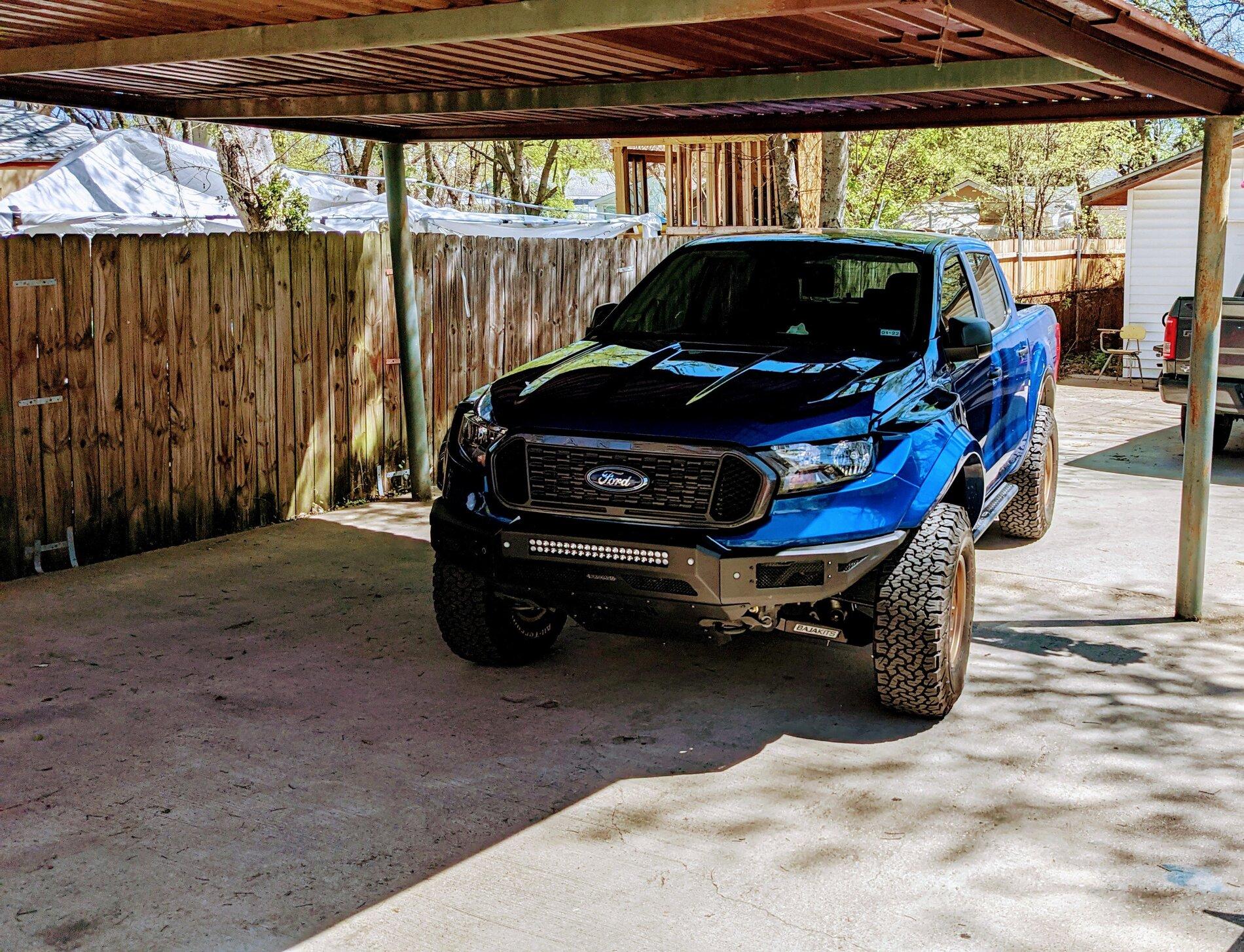

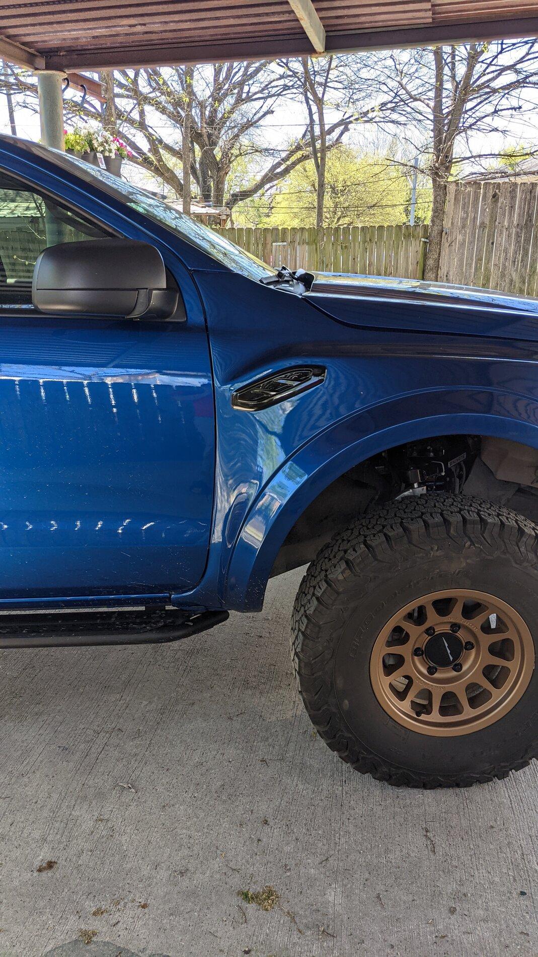

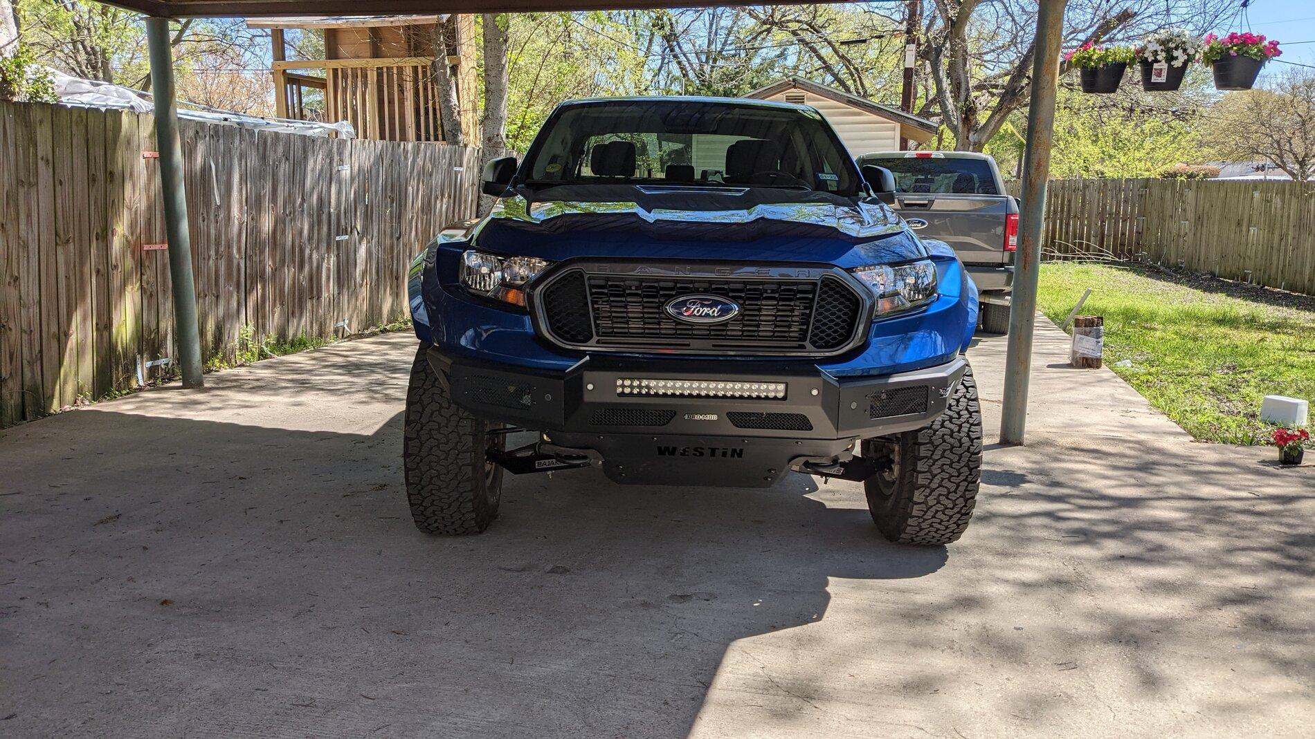

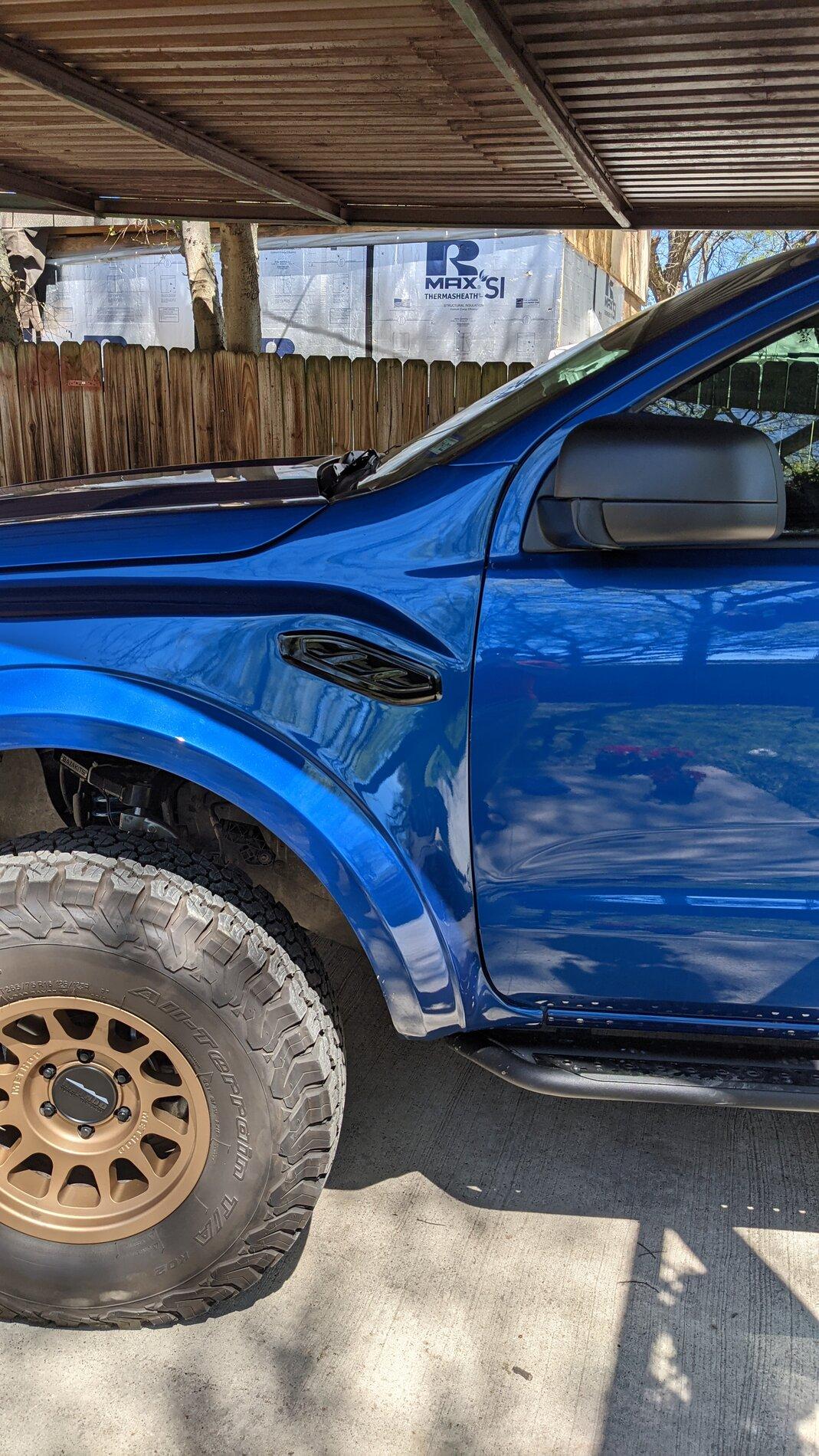

Got the LT kit installed Saturday, which is the whole reason I installed the fiberglass in the first place. I also lined up the right fender better to the door. I still need to drill one more hole on the bottom to bolt up to an existing threaded hole that I'm not using (there are 2 stock bolt locations on the bottom and I'm only using 1 right now), and it should line up next to perfect.
Overall I'm pleased with the quality of the ADV fenders I didn't do any sanding for fitment up front but the painter did sand for the primer.
Remark: The valence and the fenders don't exactly match up perfectly so you could sand it flush to each other. Also the valence is too thick to fit under the headlights the same way the stock valence does. There is somewhat of a slot at the bottom of the headlights that the stock valence fit into but my fiberglass valence didn't. Fiberglass is much thicker.
