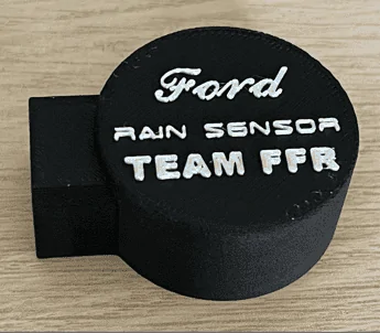

I designed a quick 3D cover. You can print this yourself or have someone do it for you. Search for https://www.thingiverse.com/thing:5905369
I designed this to allow room for the sensor and pad. Note the FORD Sensor has gel already applied. If you have a lip on your sensor, you need gel as the sensor must sit FLAT against the windshield with no air bubbles. No lip, no gel. To install you will need to notch your camera cover behind your mirror to run the square piece into and run the wiring. (3 wires). How do I plan to keep the sensor on the windshield. A small amount of silicon should keep it in place.

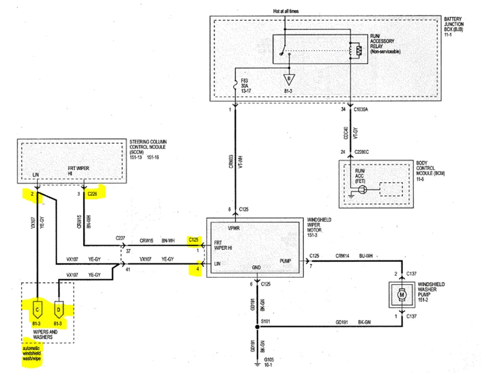

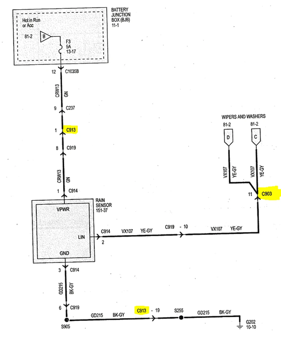

Rain Sensor wiring:
What the complete circuit looks like:
Pretty straight forward. The Sensor goes to switched 12v, Ground and Rain Sense. Problem the connector C903 (Drivers side A Pillar) on my truck has nothing in Pin 11 (Yep Ford saving money). So we need to keep on tracing that wire…. Rain Sense goes to 81-2 D / 81-2 C (Wiring Diagram)

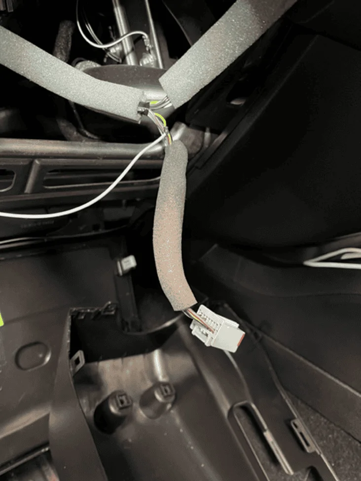

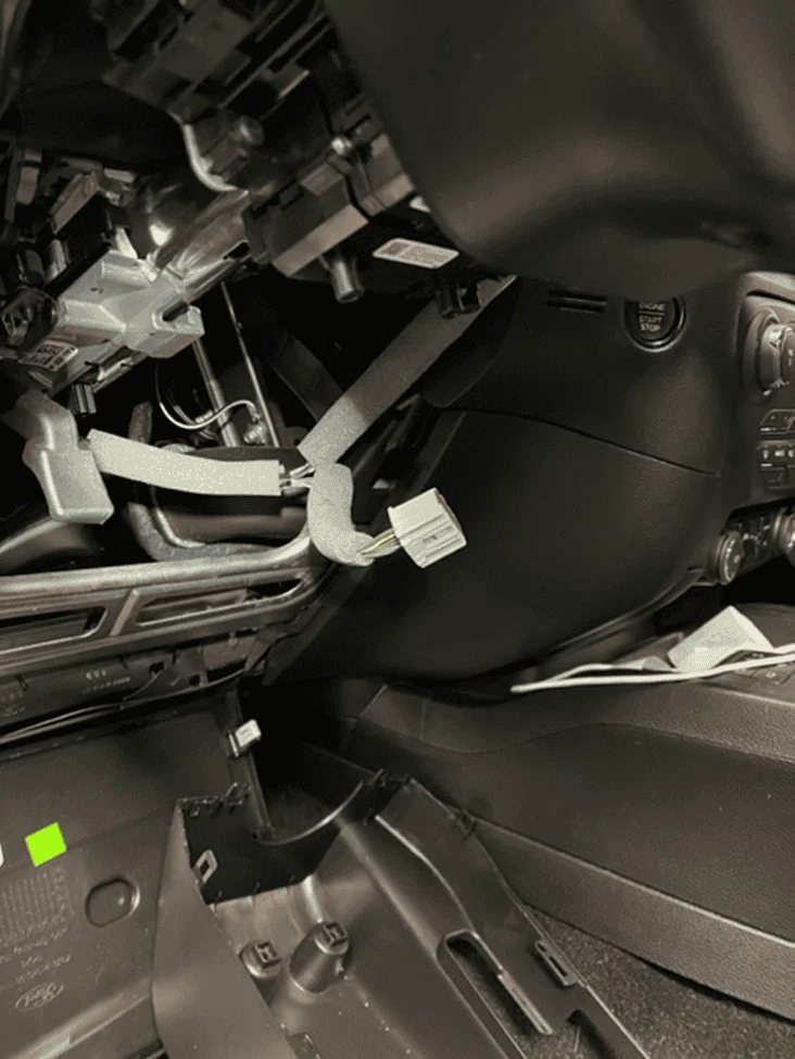

Which connects to Pin 4 @ Connector C125 (At the Wiper Motor) Yellow wire for my 2020 Ranger or Pin 2 @ Connector C226 (The SCCM module located under the steering wheel) Also a Yellow wire for my 2020 Ranger. 3 bolts to remove the bottom of the steering console. And tap that wire. I like to solder my connections. So here it is:
Connector unplugged​
Yellow wire going to the connector @ PIN 2

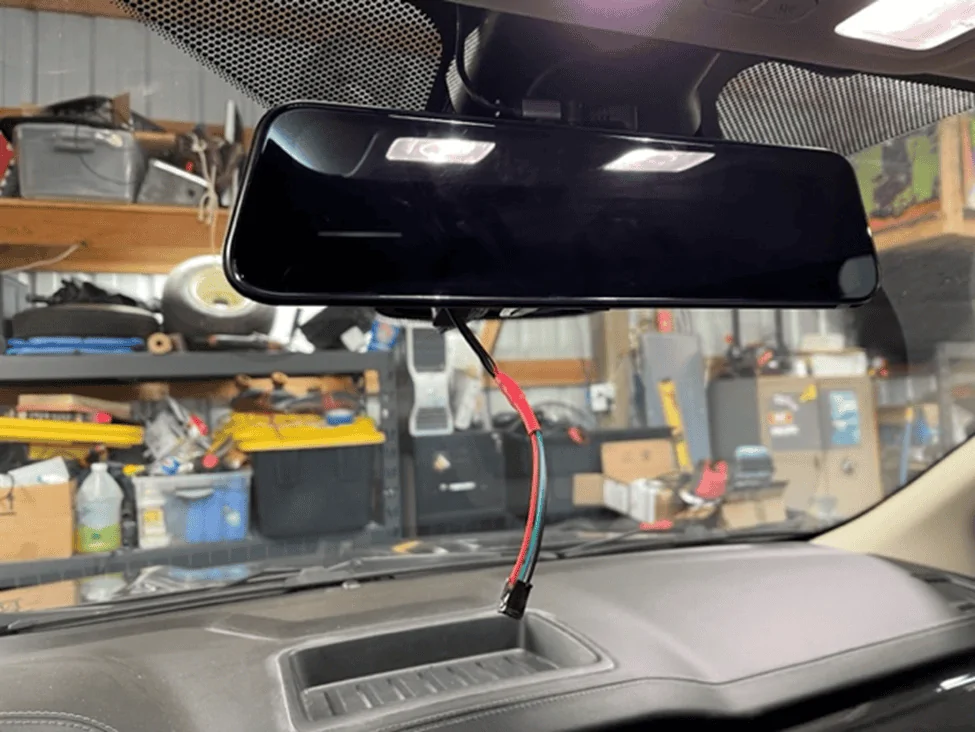

Wires ran. These run under the headliner and down the drivers side A pillar.

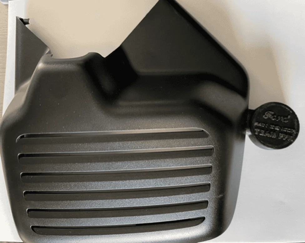

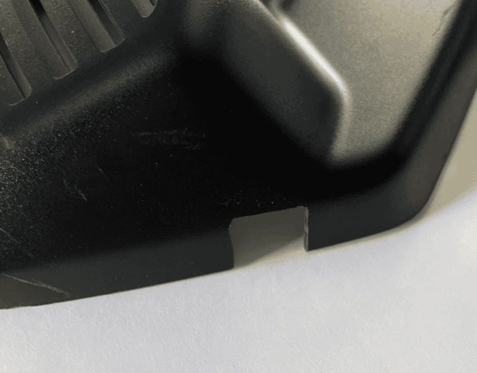

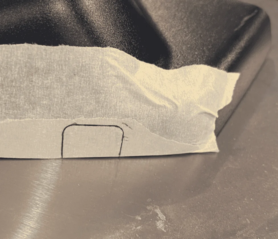

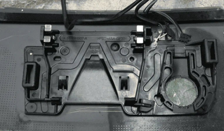

You will notch your camera cover (behind the mirror) something like this. I used a dremel which made quick work of it, but a file or hacksaw would probably work. Use your 3D printer cover as a template.
Which will then look something like this. You can put a little bit of black RTV to keep it attached and hide the 2 pieces.
It should fit into the slot and will look something like this. The sensor will be mounted to the windshield under the cover.

I printed my cover with Carbon Fiber Filament and white letting on top for vanity..
