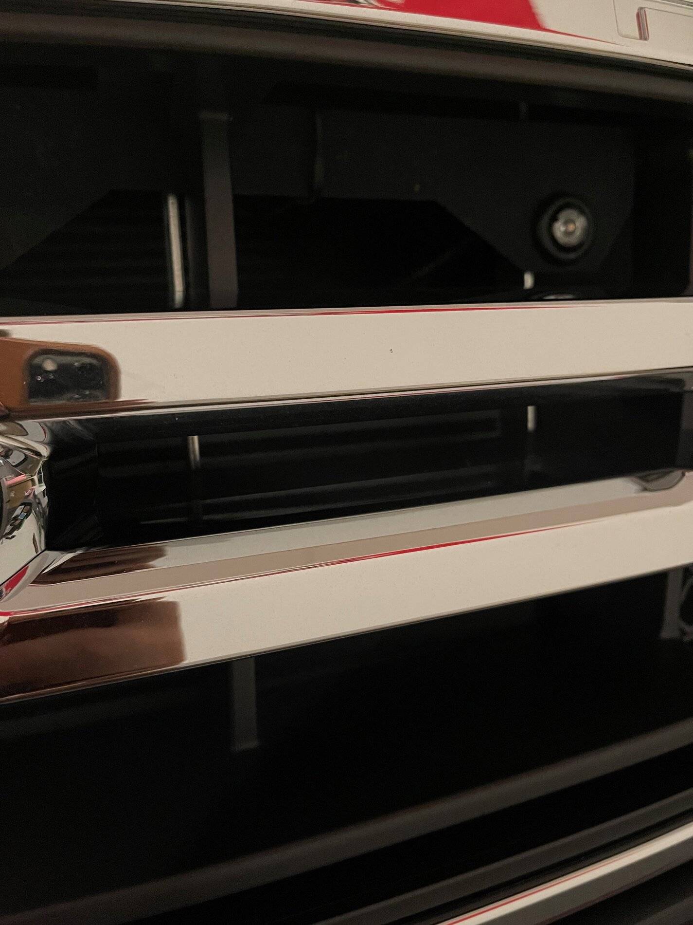

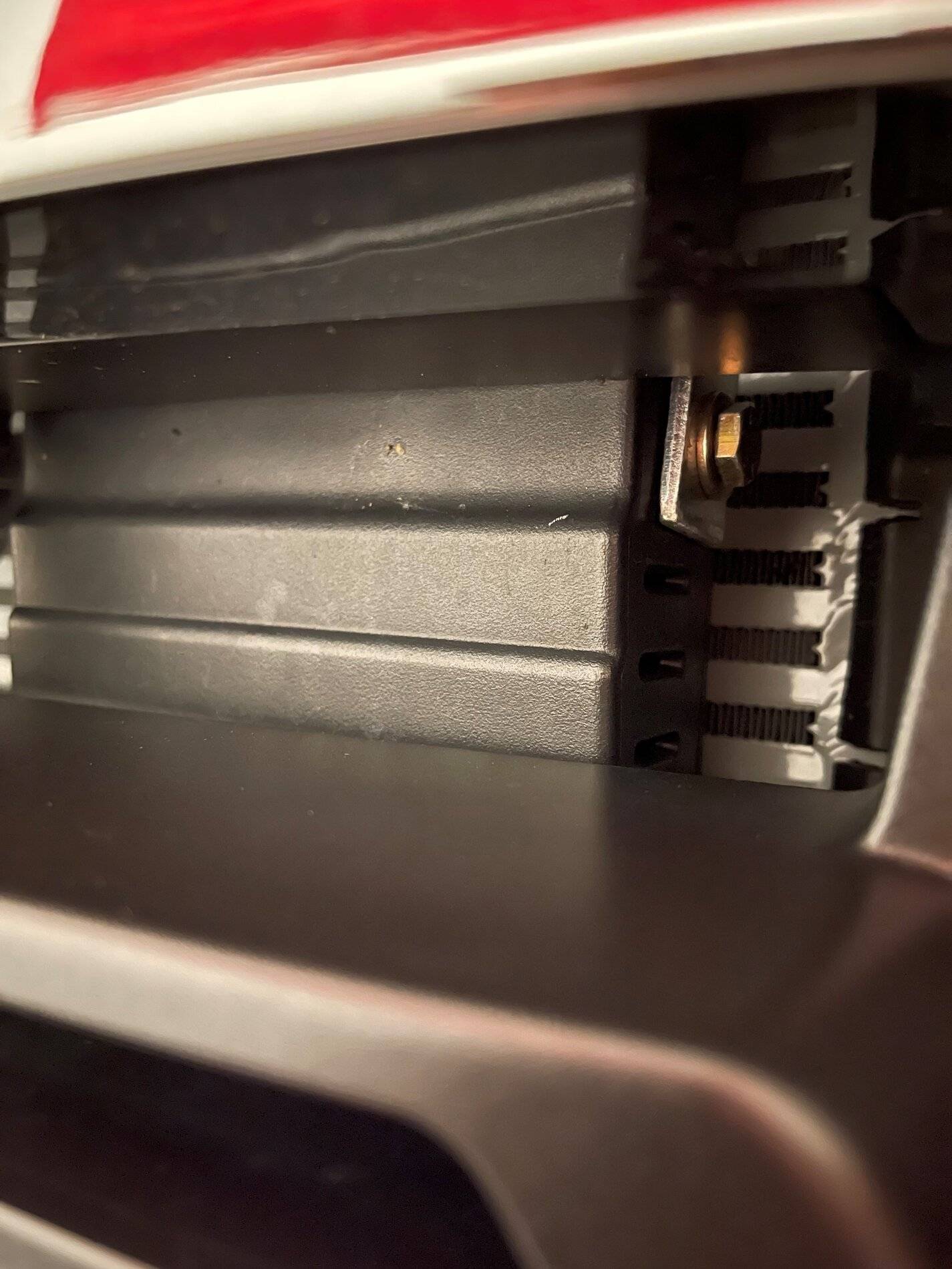

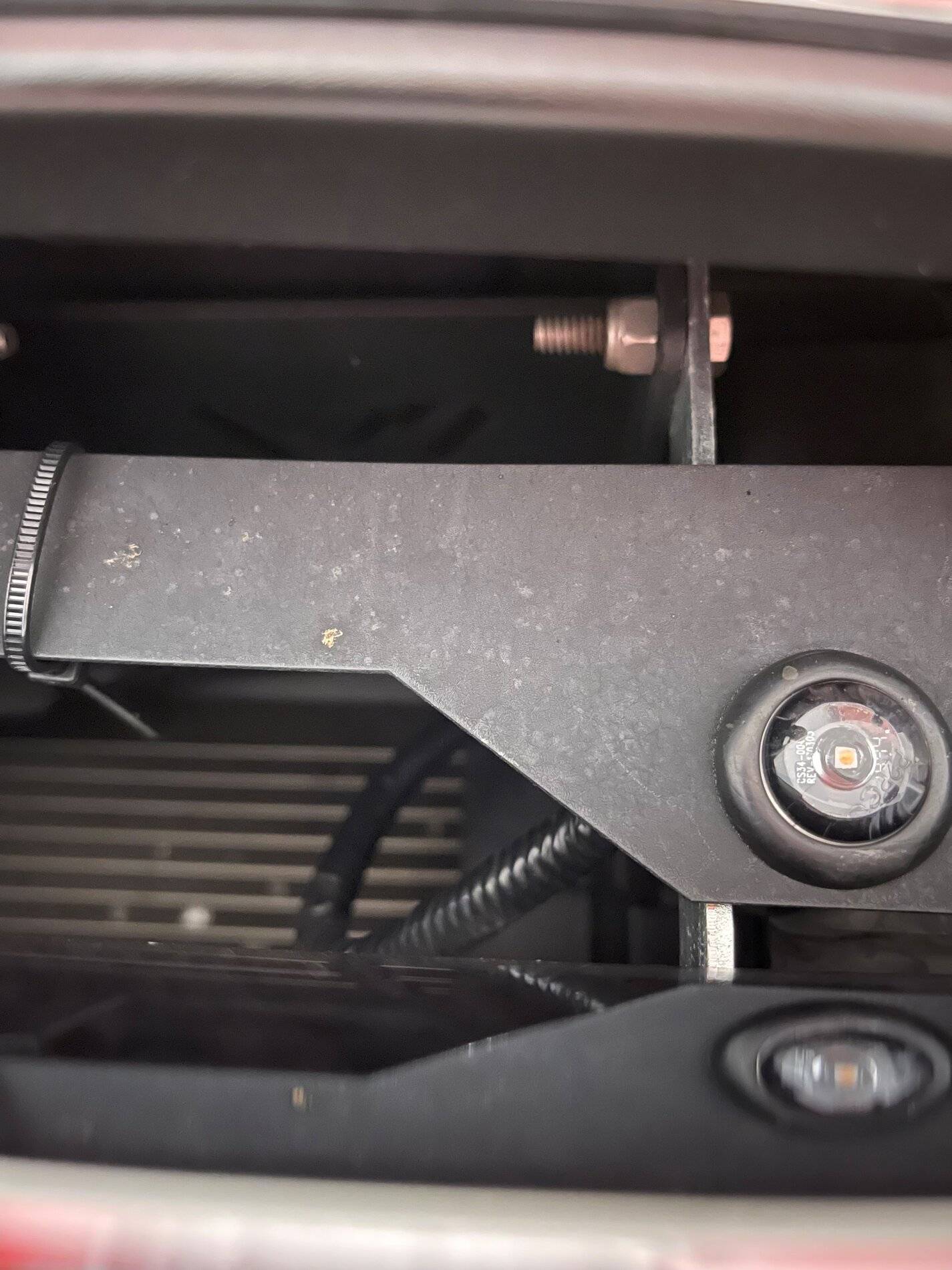

I used two of these fence brackets from Lowe's - attached one end to the FabFours bracket and the other to the ACC module.
Photo below is the top of the FabFours bracket, this is where the top of the stainless steel fence bracket attaches to the fab fours one
This next photo shows where the fence brackets attached the ACC module.
And here you can make out the two of the fence brackets (silver) running down from the FabFours bracket to the where the ACC module now sits
Let me know if that clears it up.
