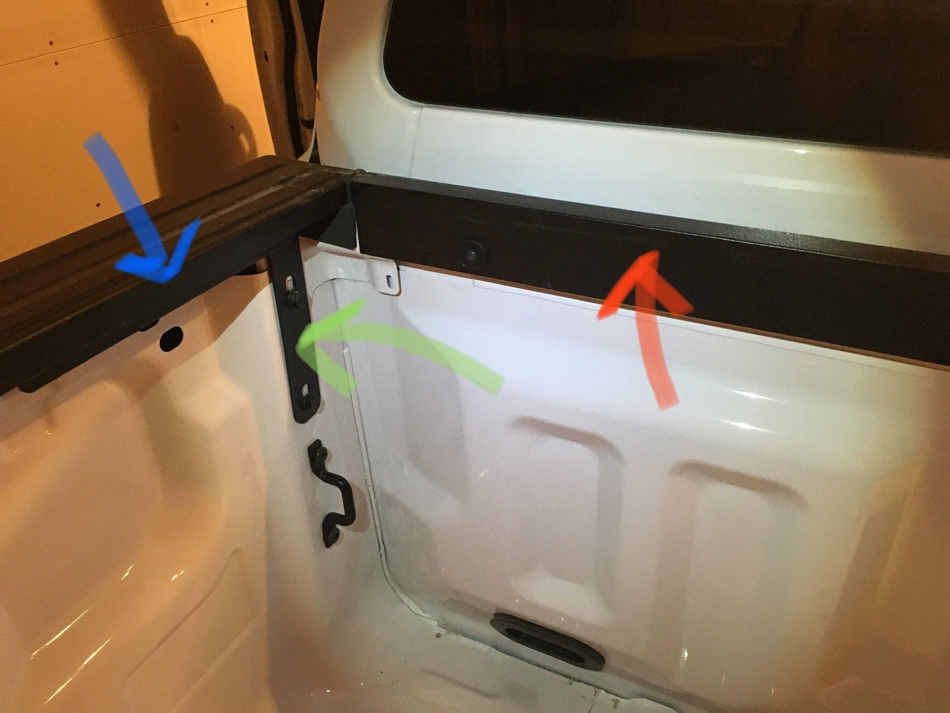

thanks to you and others that have responded. Now that I start sniffing around, I can see a few gaps that clearly would benefit from sealing, and now I have a couple more questions.
See my attached photo. This truck came with the OEM soft folding tonneau. i believe the metal bracket (green arrow in photo) is basically part of the tonneau, so my plan is to remove that in case anybody ever actually finds a new home for this thing.
However the red arrow I’m not sure about. This is a thin metal cover over the top edge of what I believe is called the front bulkhead. It’s flimsy and fragile appearing. Is this something that came with the tonneau, so that there is a uniform top edge and creates a better seal? Or is this part of the truck bed and the topper is going to sit on top of it? if the latter I definitely need to remove this, caulk underneath it, and put it back on before we go to the dealer to get the topper installed. It will be impossible to run a nice outside silicone bead once the topper is in place.
Finally, I have been assuming that the plastic rails on the sides of the bed stay there and the topper sits on top of them. Blue arrow in the photo. But if that is not the case and those are going to come off before the topper is fitted, please let me know!

Green and red are tonneau related and should be removed by you prior to topper install. The topper dips down to meet the forward bulkhead (you can kind of see it in the below unrelated picture), a tonneau doesn't so that's why that sheet metal piece has to be there. But since the topper does joggle down to meet the bulkhead, the areas in the corners are where the seal won't conform as well and it can leak a bit.
Both green and red should be packaged with your tonneau for when someone buys it.
Speaking of that bulkhead sheet metal cover. The holes that thing uses to mount to the bulkhead are the holes I was talking about that are open to the world (once you remove the sheet metal) and can allow water/dust into the bed.
Blue stays since those are essentially the bedrails. The topper rests on top of those. That's what you would drill through to bolt instead of clamp if you went that route. Though looking at mine, the clamps aren't really in the way at all. But that's up to you.
