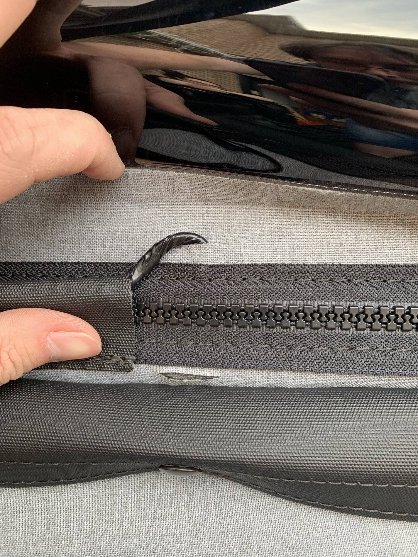

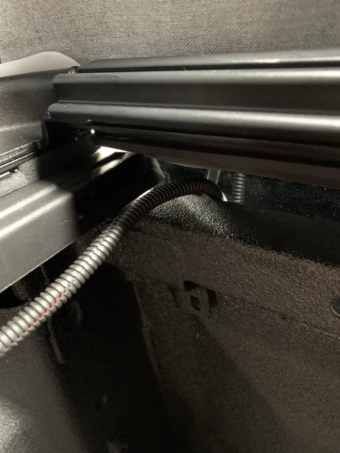

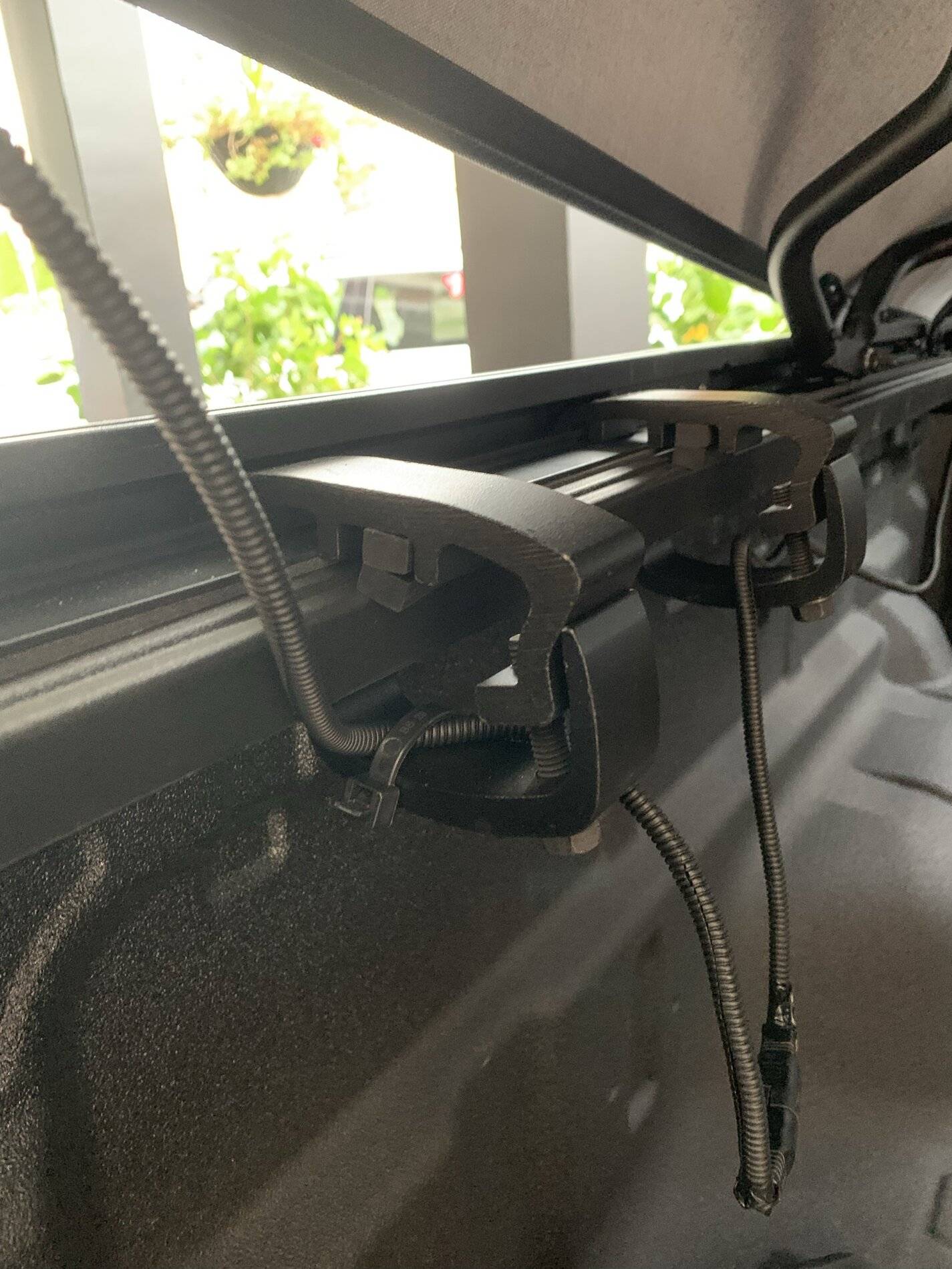

Problem 1: Zip tied the wiring before the connector so it can't be folded back. Easy enough to fix, but shows a lack of attention.

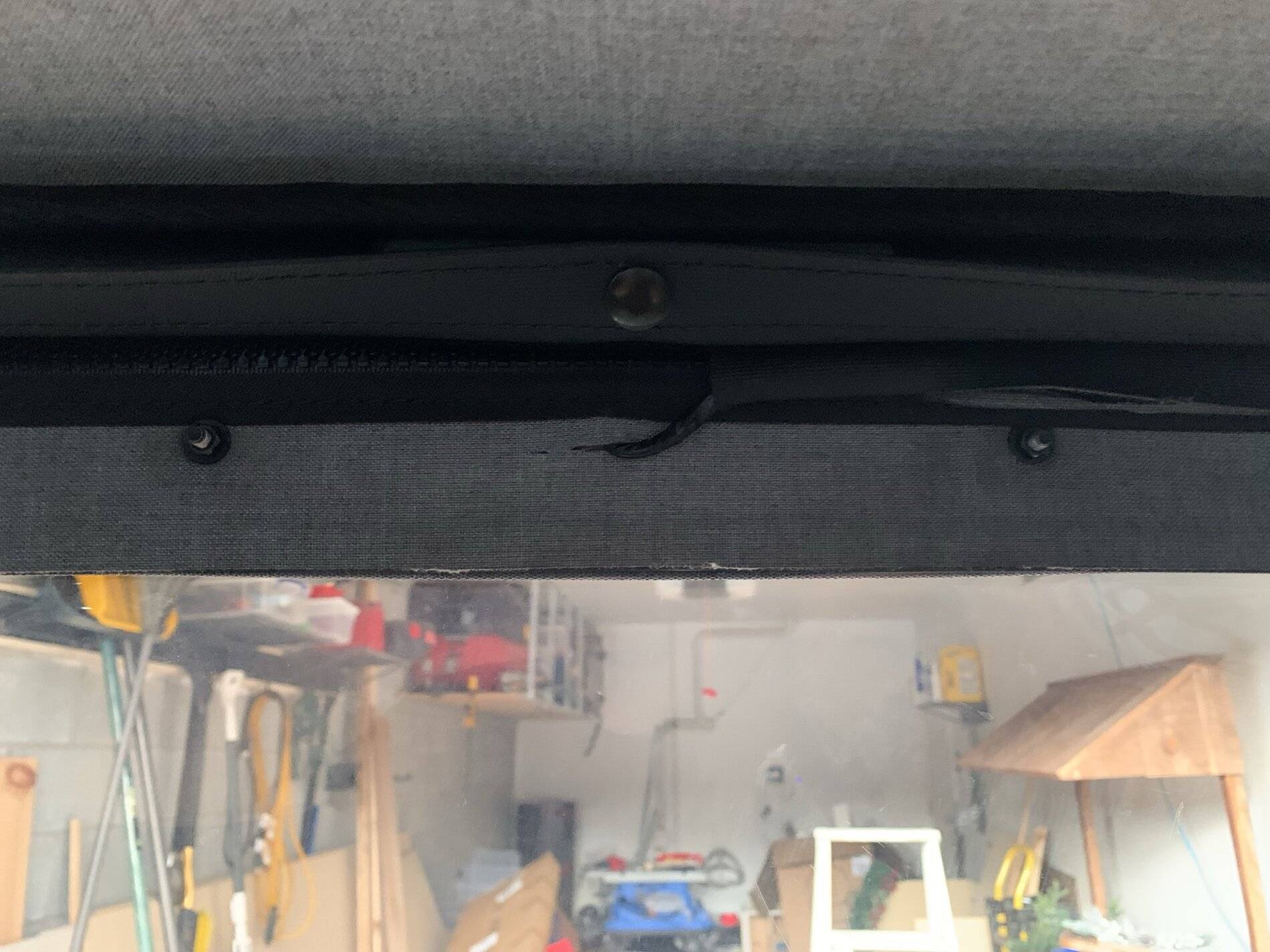

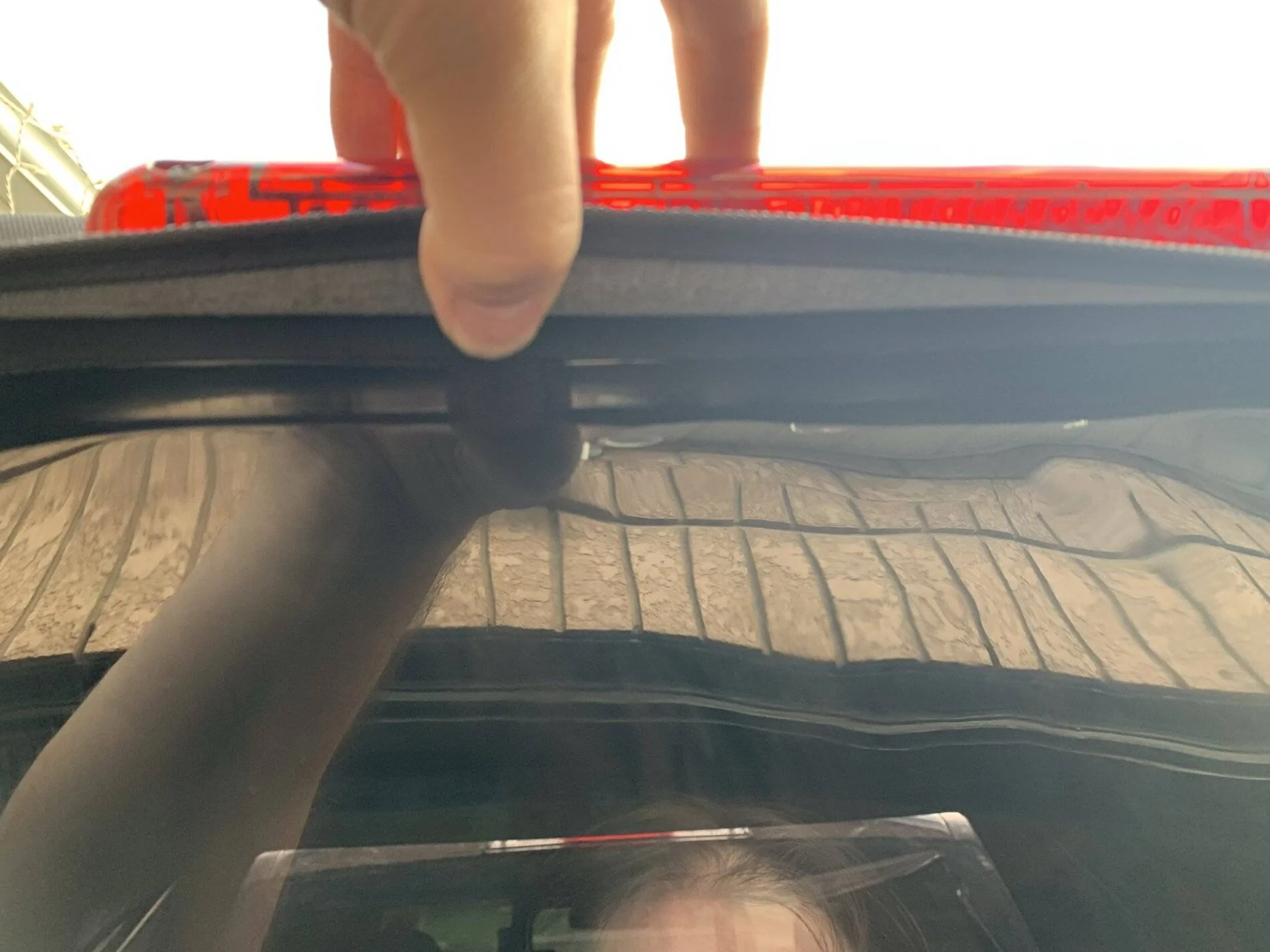

Problem 2: They installed the 3rd brake light through the window panel. This makes the whole thing useless as the window can't be removed. If it's moved to where it should be, it will leak.

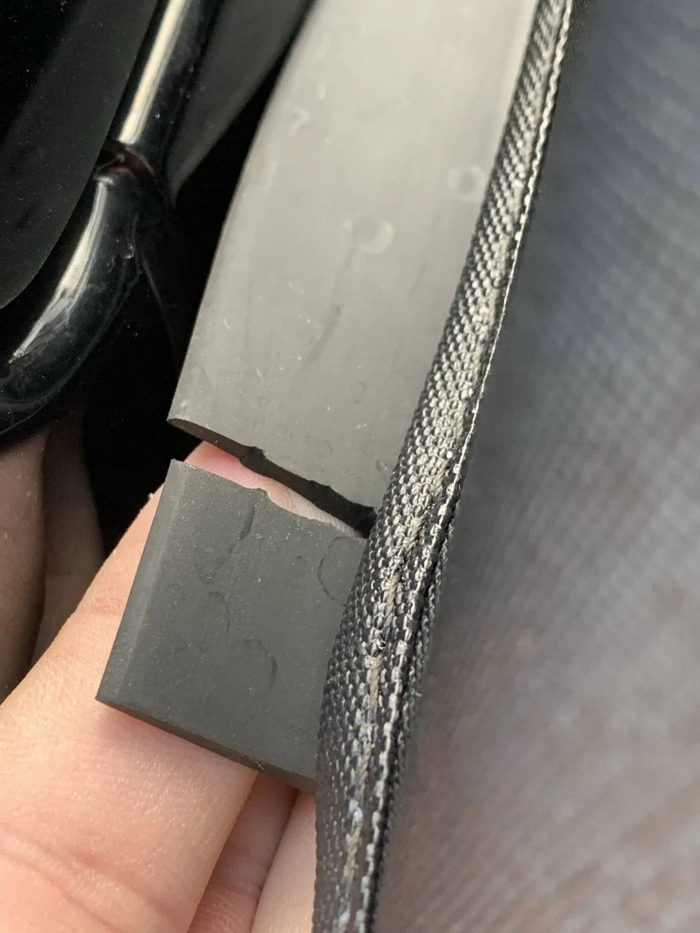

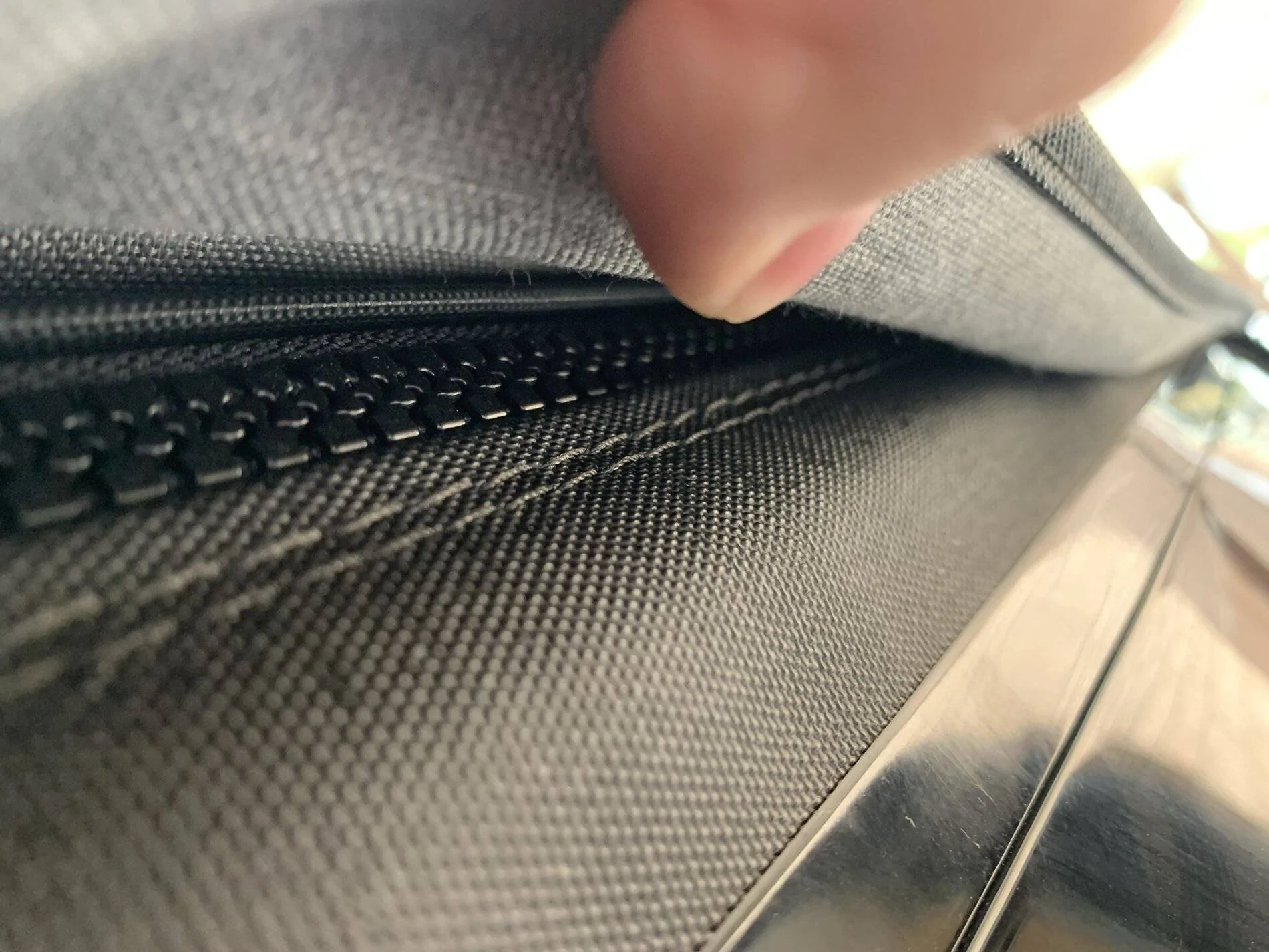

Problem 3: It doesn't look like it's fitted correctly so there's a huge gap & they cut the rubber flap so it's just going to leak.
Problem 3.b: Also the instructions show that wire being routed through the bed not over.

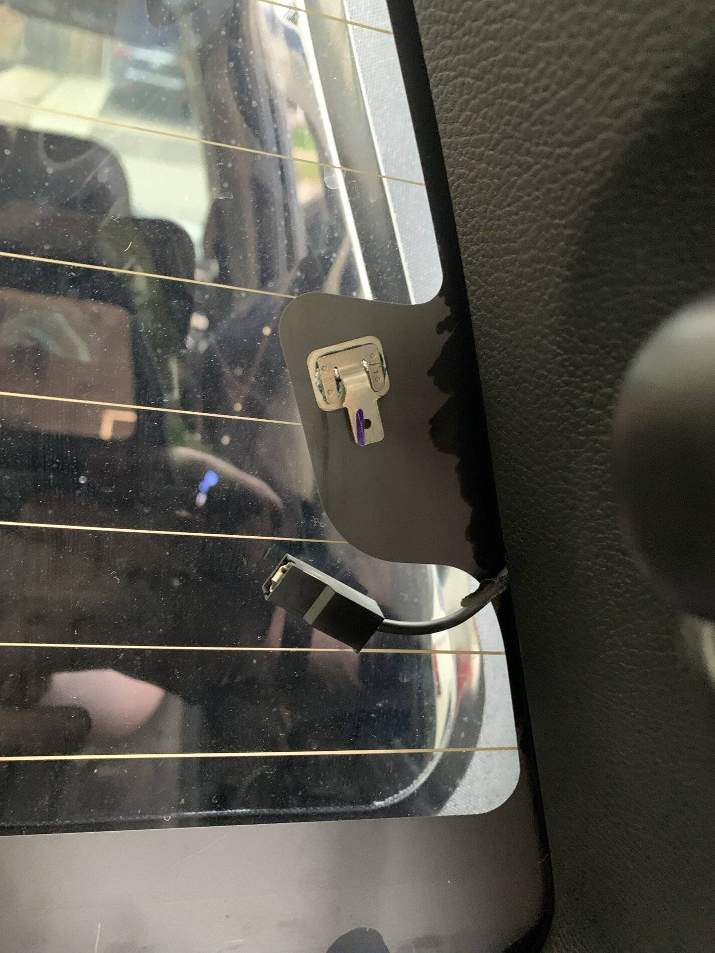

Problem 4: they didn't reconnect the defroster, again easy fix but shows lack of attention.
Problem 5: They cut the boot instead of fishing the wires through. This doesn't affect the topper, but does show lack of care or attention when following the directions. Also since the topper folds, these may rip completely over time.
Problem 6: It wasn't properly secured, the drivers front corner wasn't clipped over neither was the passenger rear nor was it clipped around the crossbars only one of the bars had the Velcro around it.

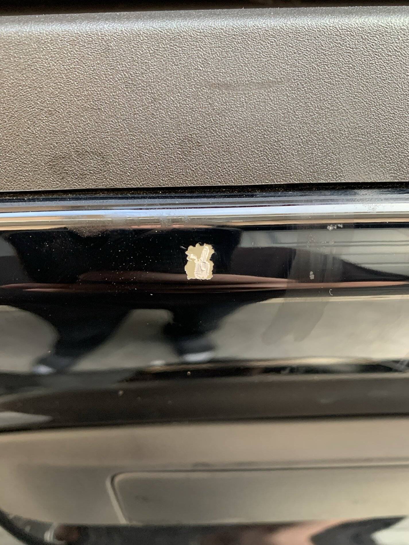

Problem 7: Forgot to include the chips in the tailgate that's down to the metal.

So they:
1) Installed the topper incorrectly
2) Damaged the product in the process
3) Damaged the truck in the process
4) Actively concealed the fact that it took them 4x as long as it should have.
Even if they were giving a full refund, I wouldn't trust them to remove it.
