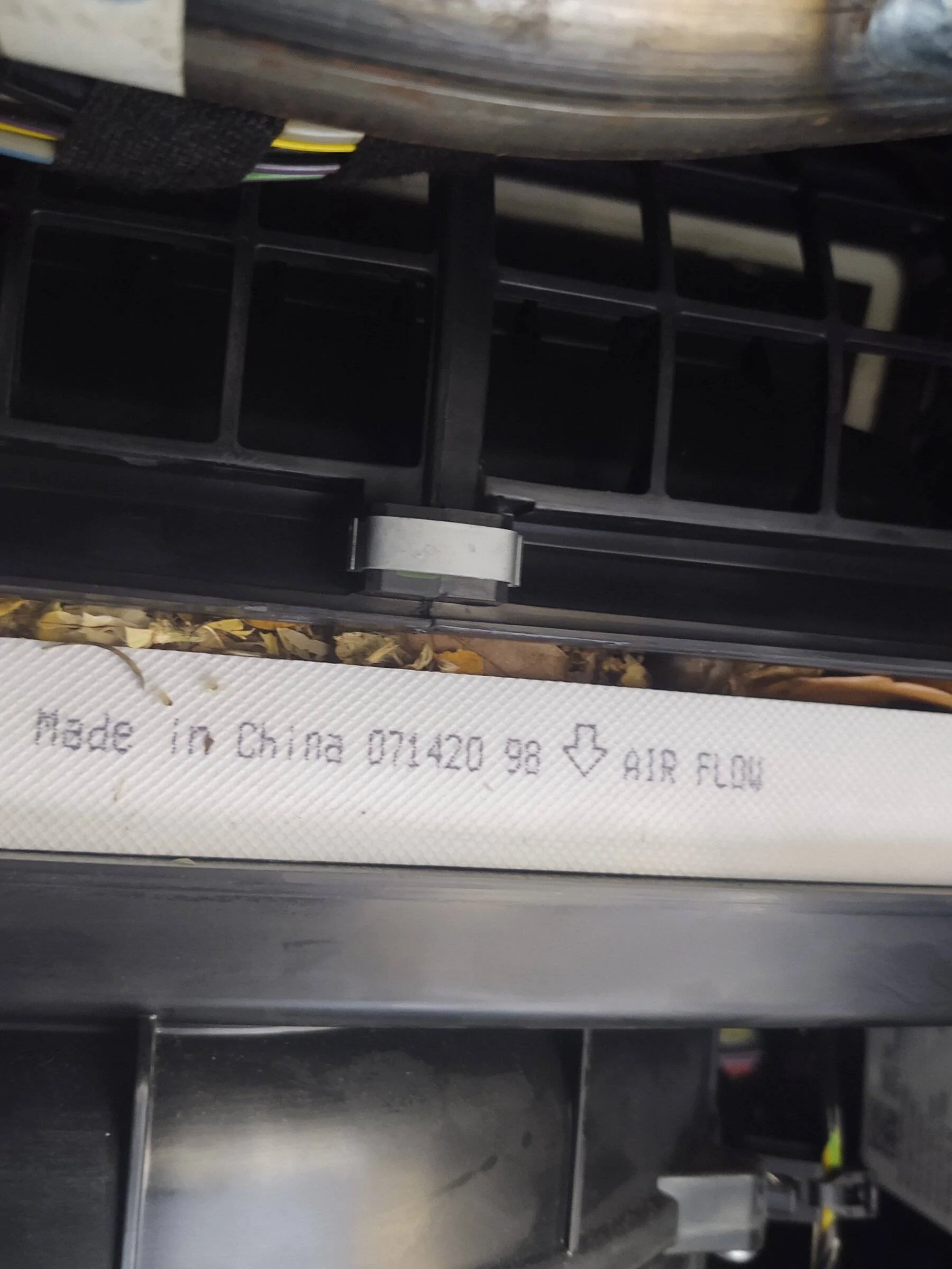

I noticed my cab taking on a smell, thought maybe decomposing leaves or just country dirt getting in. Did a lot of driving since I last changed my cabin filter, so I ordered another cheap one from Amazon.
Finally got around to changing it - removed the cover to the cabin filter...

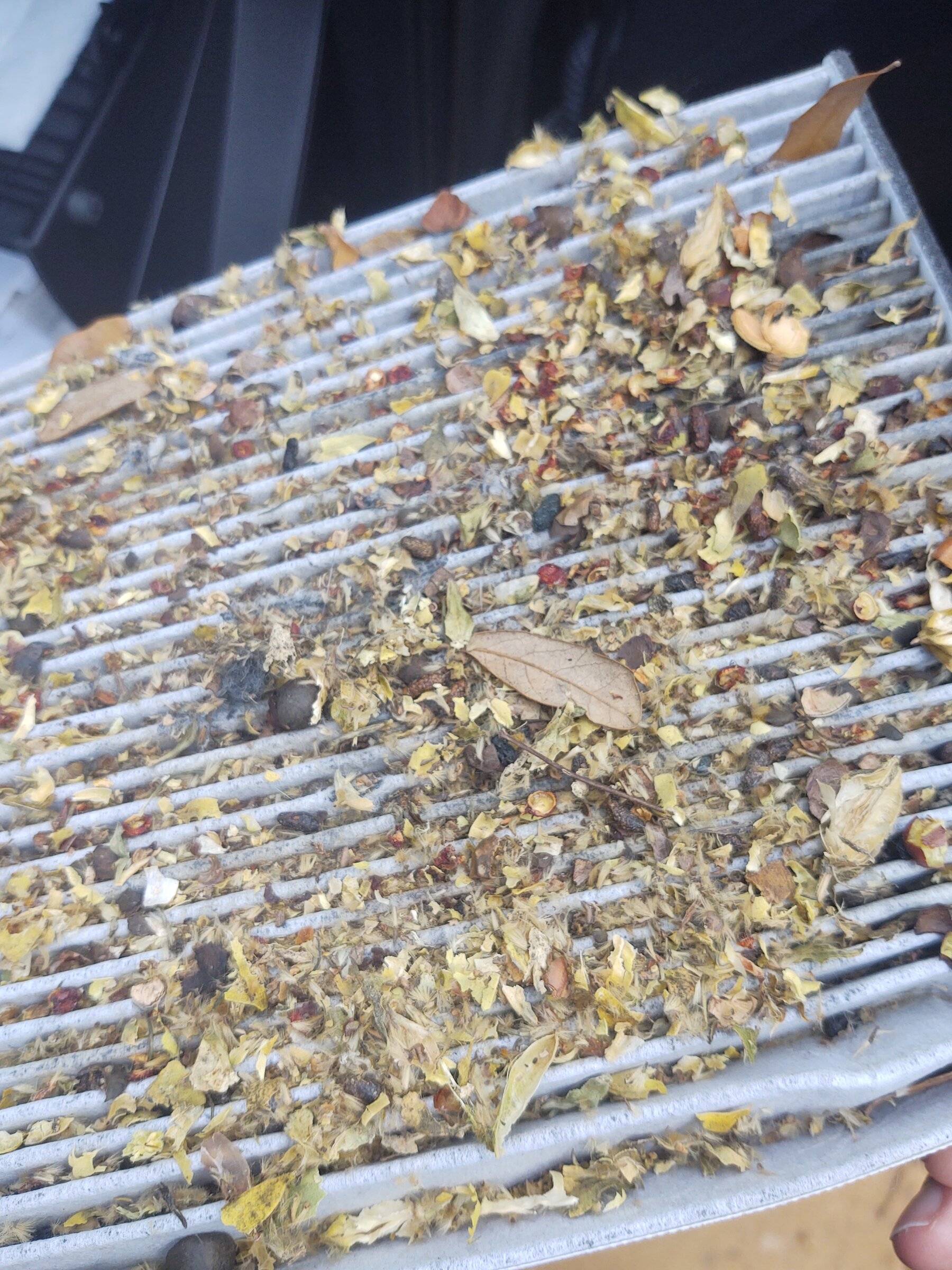

Hmm, a lot of leaves. Let's see how much it's collected?

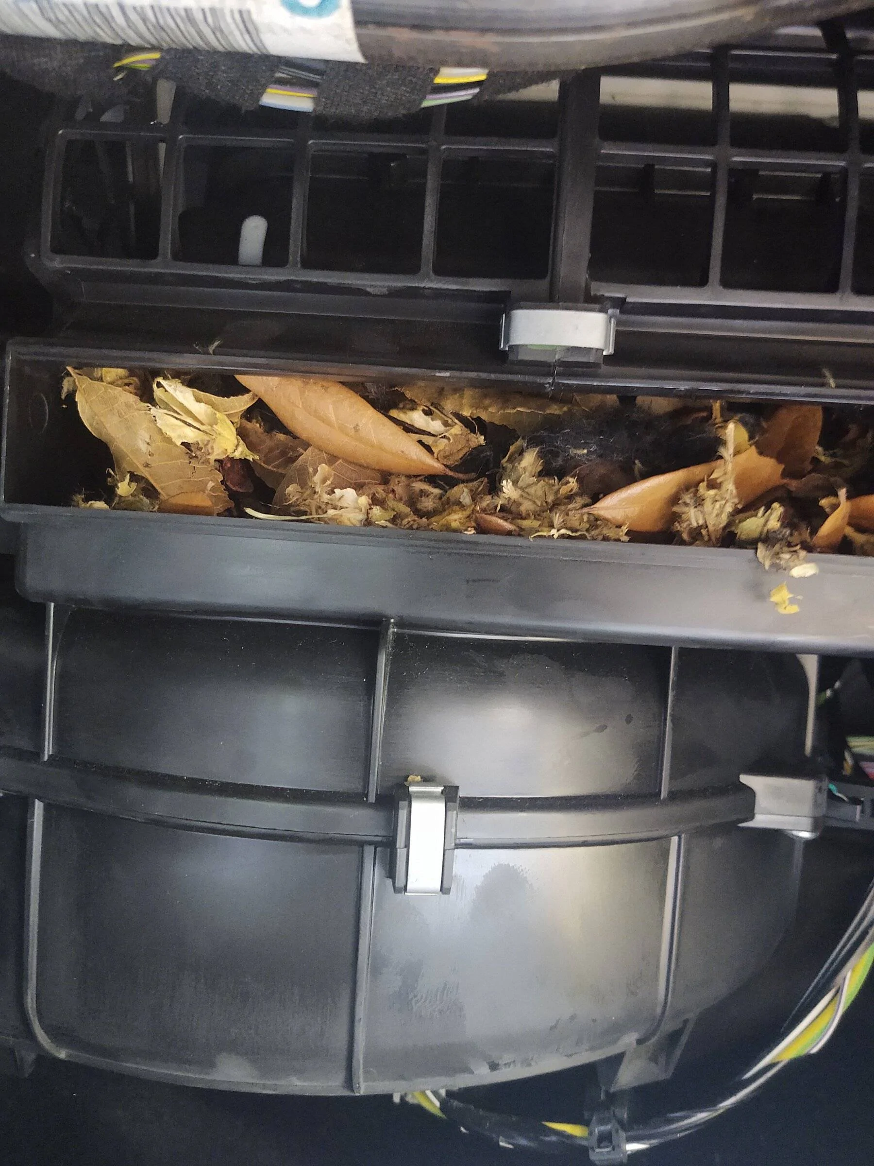

Aw crap, there's mouse turds in there too. Time to check to see if there's anything else in there:

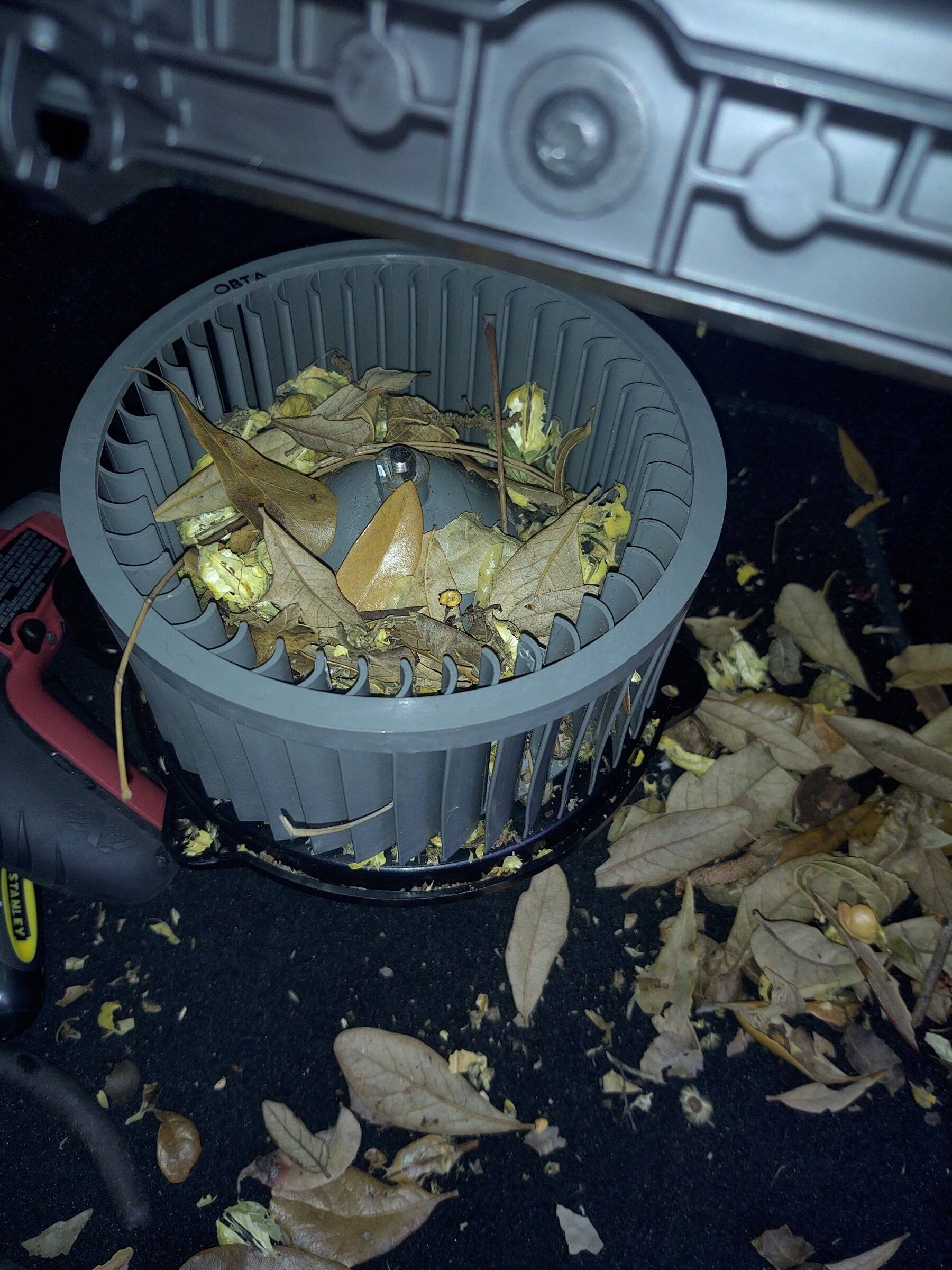

Twenty minutes with the shop vac and I'm not getting everything out, so I drop the fan from under the dash (unplug power, take out three screws)
I'm feeling a little hostile now, going crazy with the peppermint oil spray since there is a LOT of insulation coming out:
