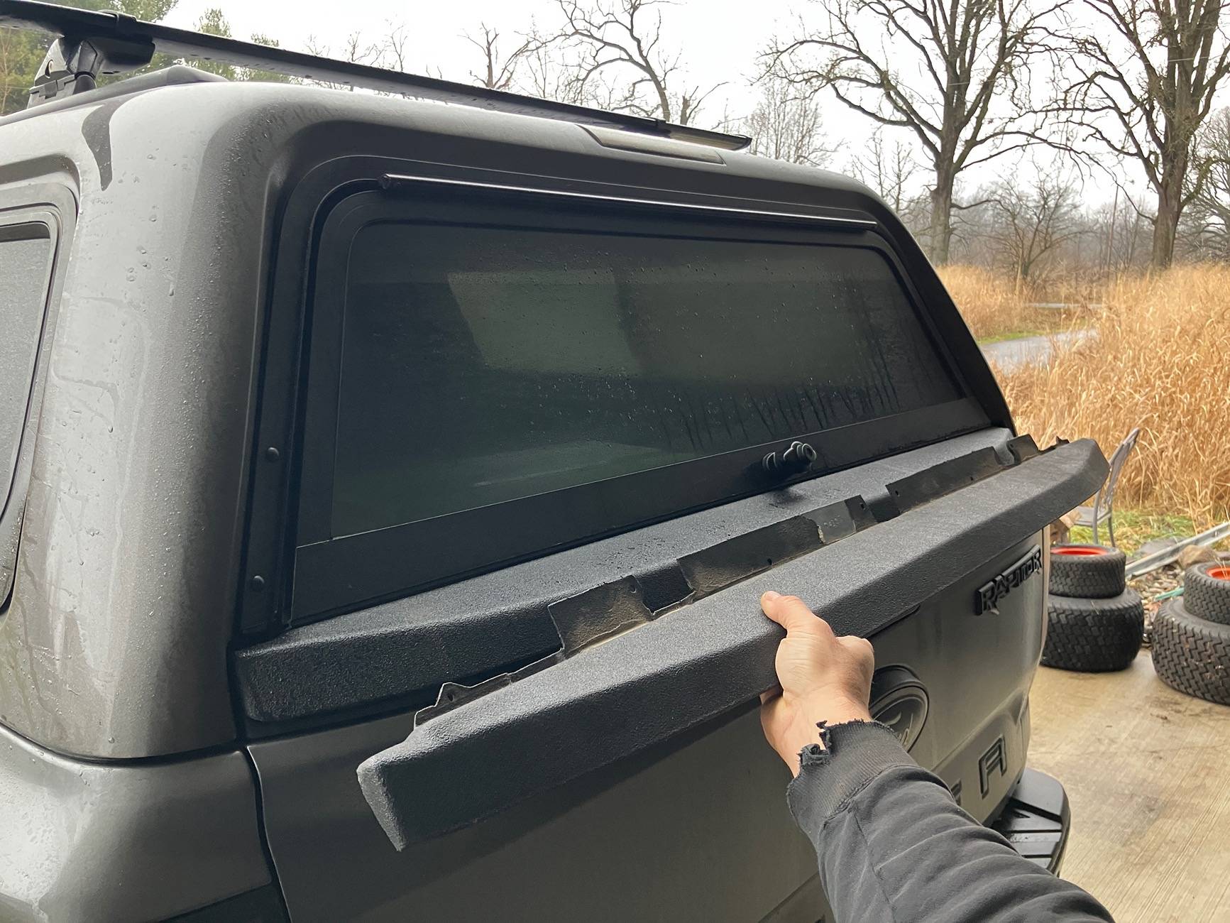

That bottom door piece needed to accommodate the shape of the tailgate is called a door "shroud".

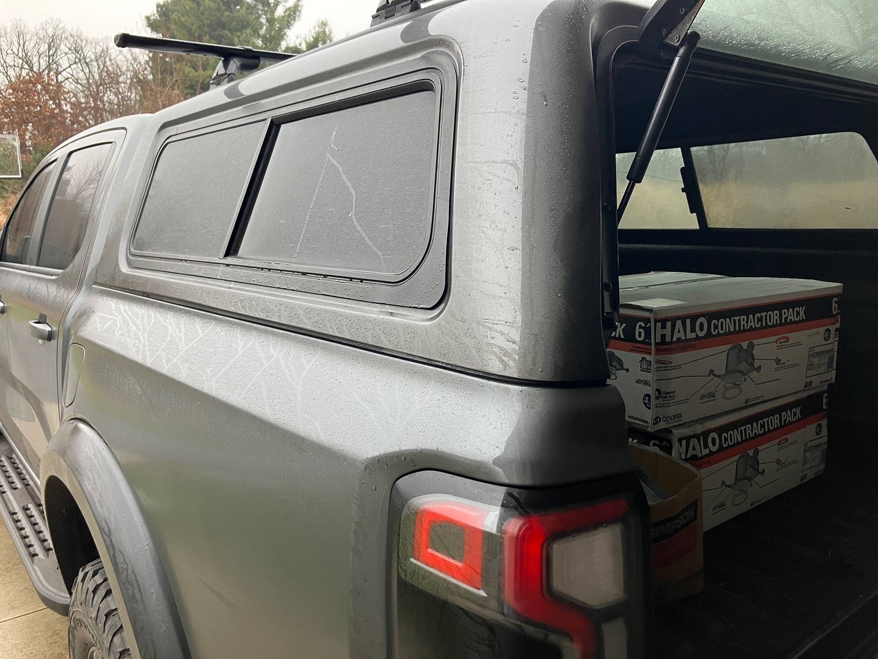

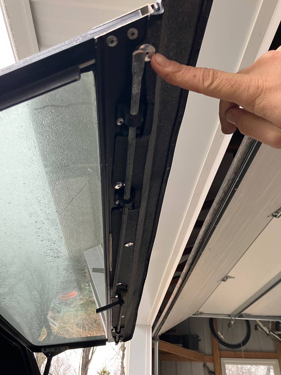

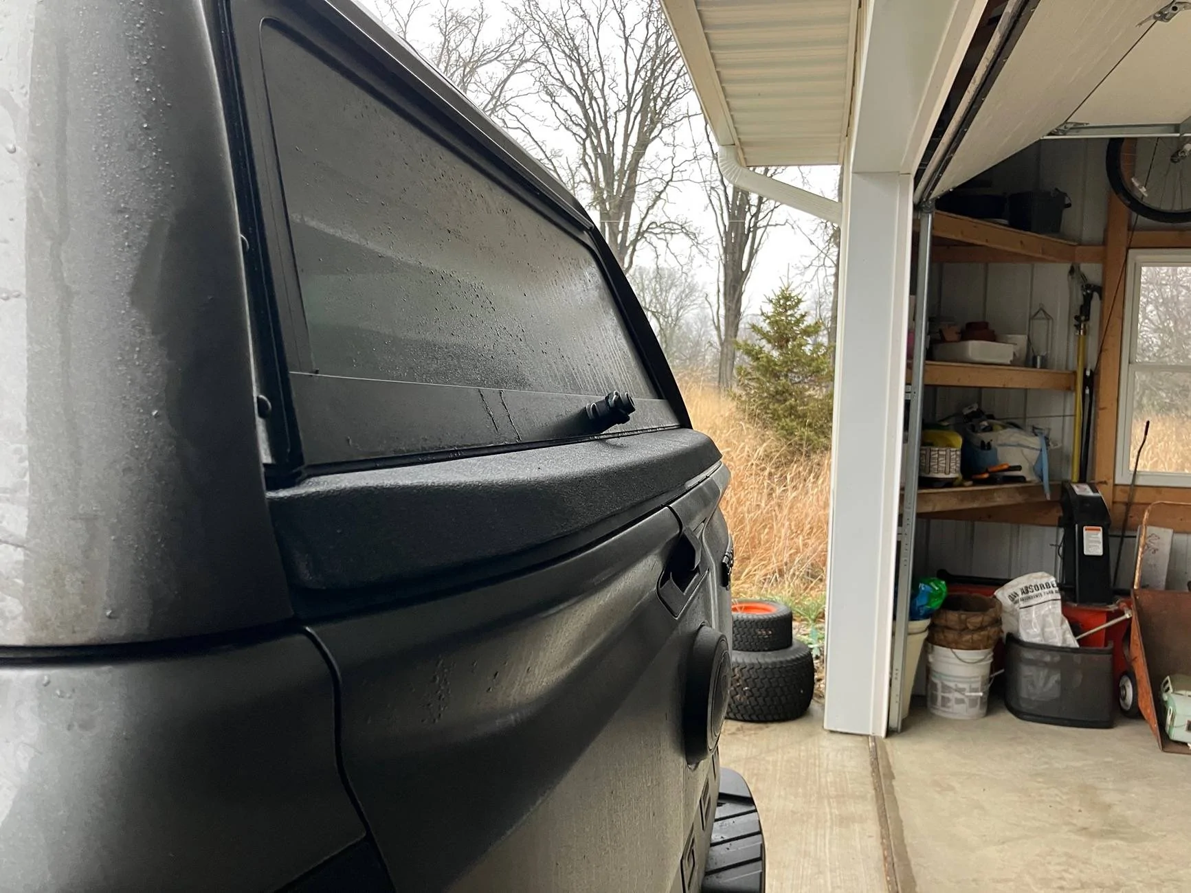

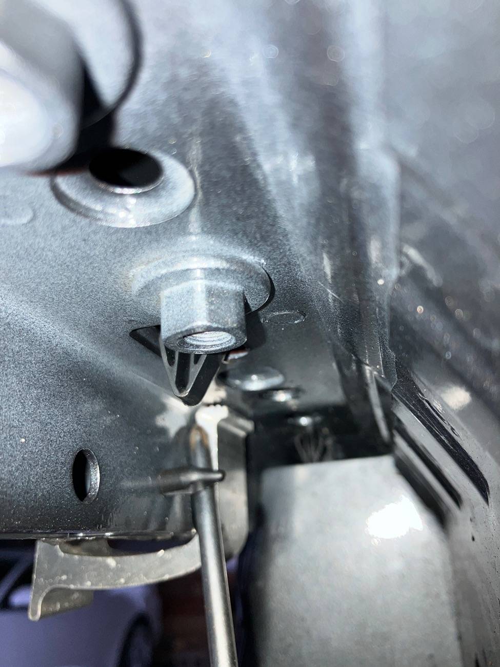

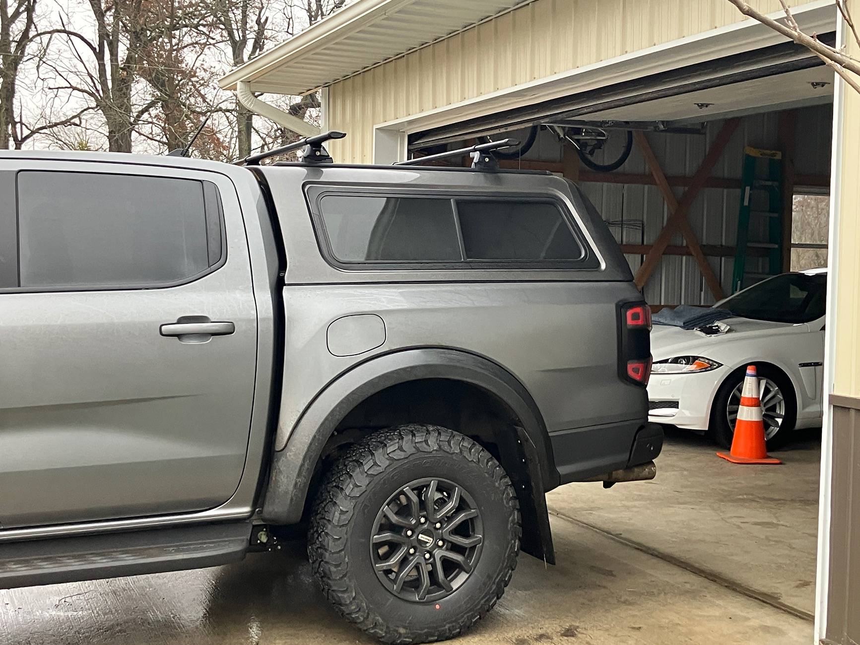

Here are the pictures. The shroud replaced and the inside of my clamps needed to have the inner lip ground off for proper figment. The kit ordered had the shroud, 1 sticky backed seal, 1 loose seal and 8 rivets included. Drill out the rivet heads and the shroud pops right off. Put the loose gasket in place and start setting the rivets making sure all rivets fit and the loose gaskets remains in between the shroud and aluminum door before setting the rivets. Took about 30 minutes

Thanks for the pics! The fitment looks great and good to know the tops swap out minus the back trim panel.
Is that a XF lurking in the background? Looks lowered too? I was a Jaguar tech in years past, Im a big fan.

It is an XF, 2012, V8, 39k mi and unsure on if it’s lowered. It will be for sale in the spring. It’s a gift from my wife’s ailing Father. We don’t have any use or space for another vehicle. I’ve driven it maybe 20 miles, seems like a nice car. Fresh from sunny AZ!!

Great info. I hope you take as much care when you install those Halo cans.
