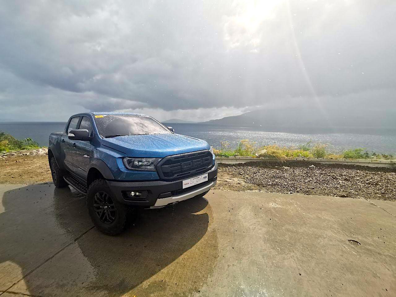

Since when do they make a ranger raptor?
I try not to even use 4 wheel in the snow if I don’t have to, no reason to cause excessive wear and tear
I guess I should've specified what country I'm in. We've got the Euro Raptor in Asia Pacific too (Asia, Australia, New Zealand). Incidentally, this was the curvy slippery road I was describing. Typical Asian road that's just concrete, no asphalt. But yeah, since it was pretty twisty, I decided not to even try 4H.
