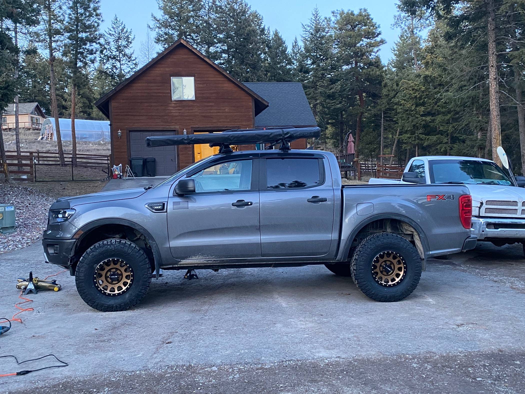

Forester
I saw another member with literally the same exact setup as me. Method 305, nitro ridge grappler 285/75/16
