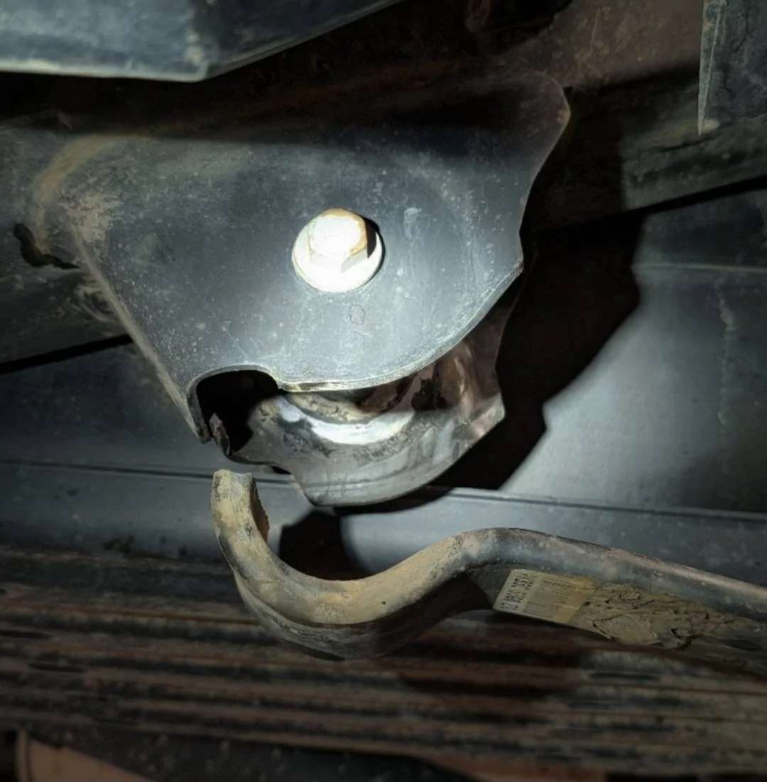

Has anyone had issues with the stock control arms binding offroad? We offroad a ton. When the front driver shock compresses there was a pretty loud *thunk*. When I finish the trail the steering wheel is misaligned. It has happened to me twice and has caused the steering wheel to be misaligned both times. But the alignment is fine.
I'm not 100% sure that the UCAs are causing it, but that's my best guess? Any ideas?

Mystery solved.
Couldn't see the issue since the truck was sitting on the broken part of the leaf. Pretty obvious when it went on a lift.
Sadly there has been several similar problems on the forum.
