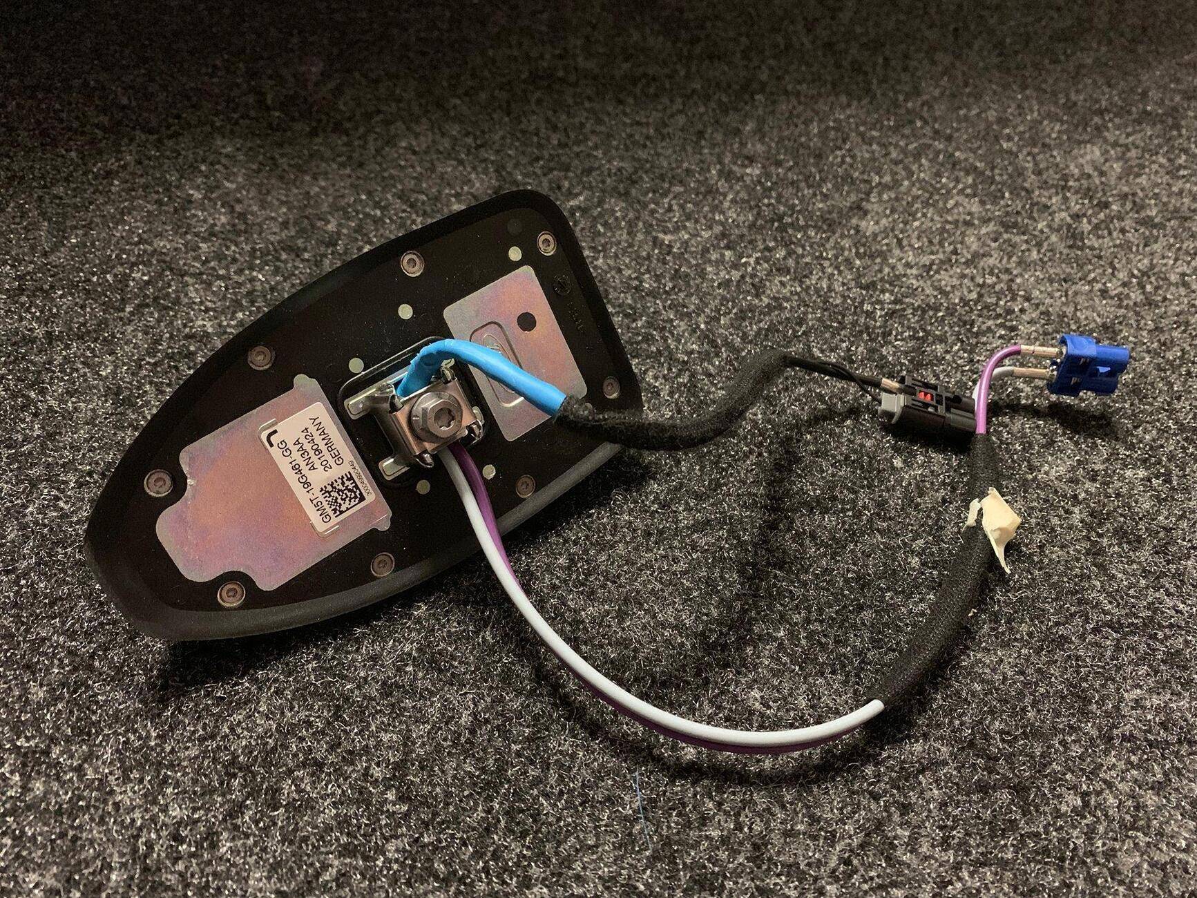

For Ref; Here is a pic of the antenna base
2 connectors - both coax
Depending on height of the roof tent, you may be able to find a longer (whip) style antenna and have it (bent) under and fold back or sideways to extend it for better reception.
The antenna (stick/mast) just unscrews from the base.

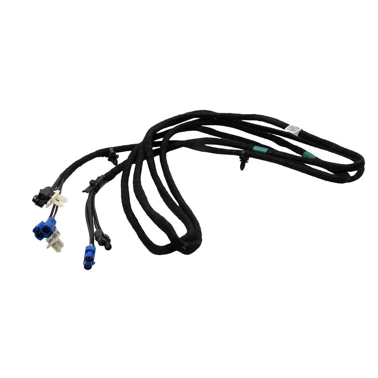

Do the antennas you are looking at have 2 connectors?
I would have to dig some but
1 connector has 2 inputs Radio / Satellite
1 connector has 2 inputs Power / Ground
The lower side of the Pas A Pillar is the connection point to the harness run on the headliner - 2 connections, one of them may be a single connector power feed at that point, then at the rear connections (headliner) x 2 the ground is ran to body ground for the antenna.
It’s best to pull the Pillar Cover and look at what they look like.
Now possible solutions would be , hit a salvage yard - find a headliner and remove the antenna cable run from it along with the antenna, then just leave OE antenna in place - sealed for water and then remount salvage yard antenna and cable run to your new location tapping into the pass A Pillar connections

Antenna Cable - Headliner Run
The (Male) Ends connect at the (A-Pillar)
The (Female) Ends run back to the (Antenna)
Now you may be able to remove the attach points and reroute the cable, but it would be easier to just push a new cable up there and reroute the new one
P/N: KB3Z-18812-TF

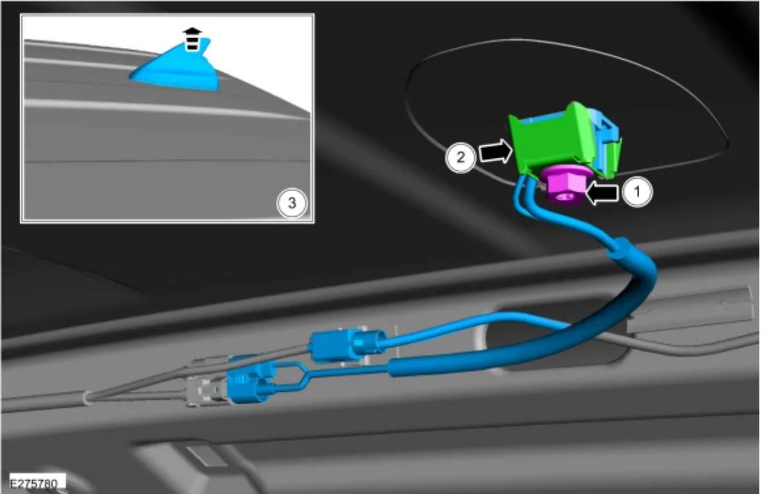

EDIT: 1/19/25
Blue Connector - Coax x2
AM/FM - Direct run to the ACM
Satellite - Runs to a Splitter - Then (ACM) & (APIM)
Black Connector- Coax x2
Antenna Power Feed - From ACM
The wiring diagram does not show a ground wire in the run, and the only physical wire I see is on the antenna wire connector, so I am assuming the Antenna Base is the Ground Point
Antenna Power- Direct Run From ACM
AM/FM - Direct Run from ACM
Note: Grd is from (Body Grd) (Mounting) of the Antenna
Black Connector: Coax X1
Runs to the (Satellite Antenna) Splitter
Coax: Cable Run - Across the Headliner - Routes back to the Rear Cab Wall, then picks up another harness run on the back wall that routes up to the splitter and roof antenna
I am going to post this, and it will take someone with a (Real Life) actual pic of this location
as none of the manuals show connectors to match the actual (Antenna).
So, it is confusing at this point - It shows the splitter (yes) and only that splitter feeding the antenna.
So, my assumption here is that the (single) connector running off the diagram - Is actually running to the Antenna.
So, something is not correct here. (FYI)
Note: There are no Connector Numbers Listed at this point
