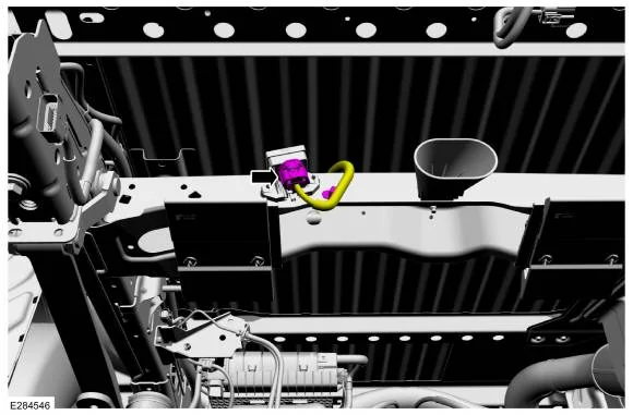

I would check the connector to the Fuel Pump Driver Module for corrosion or bad connections.
  1. NOTE: The fuel pump driver module is located on the rear of the frame crossmember above the spare tire.

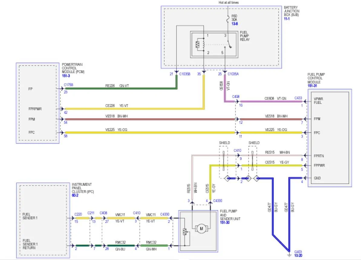

Here is the electrical diagram for the fuel pump.

Disconnect and inspect for corrosion C408 - this ties into all issues you have, I suspect corroded or not fully seated.

ok so dont need to drop (or manipulate) the gas tank to check this.
I will go from there
