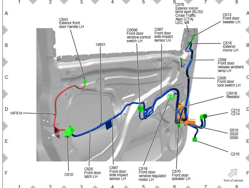

You stated it has power -how did you check it? you need a meter to ensure full 12-Volts and you need to also check to ensure it has a good ground.
I suspect the (inline) resistor is blocking voltage output to the actuator.
So check for voltage at the actuator (if low voltage) check the resistor connector and see if voltage increases.
C5018 = Resistor
You may also try - using the key in the physical lock and see if that resets it to working.

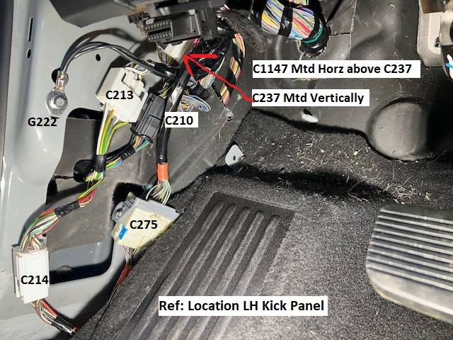

Pull & Reseat C210 & C214 - If these match the US Version Ranger, these connectors tie in door lock control (signal & actuator motor) which it appears that you are not getting full power on the Bi-Directional motor to switch polarity (Lock)
