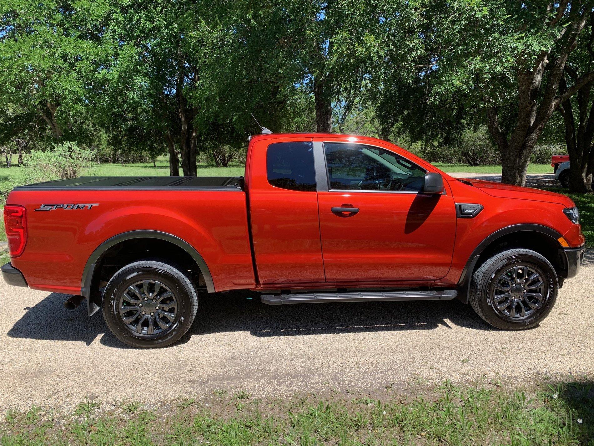

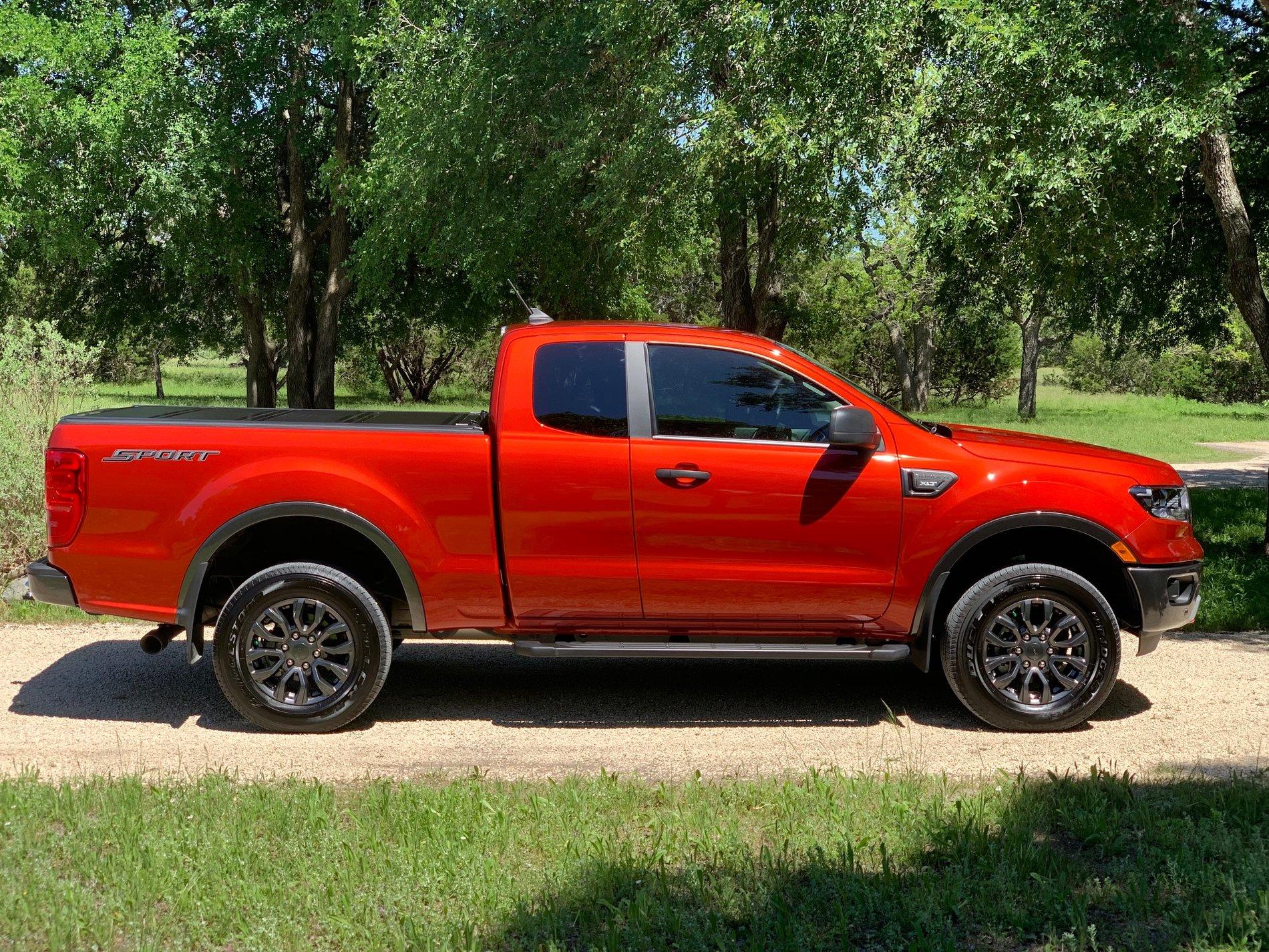

this might have been talked about before even by me ,but has anyone put a 2in readylift on a 2wd 2019 ranger ,I want 2inch because I want a little rake and not so hard foe my wife to get into it and put 255-70-17 or 265-70-17 tires on it.
Not 2". I am having 2.5" spacers installed next week.. There are a few who have done spacer lifts in this section of the forum
https://www.ranger5g.com/forum/threads/pros-and-cons-of-front-leveling-solutions.3315/
https://www.ranger5g.com/forum/threads/problems-backed-out-of-leveling-kit.2555/page-2
Picture of Ranger with 2.5" spacers
