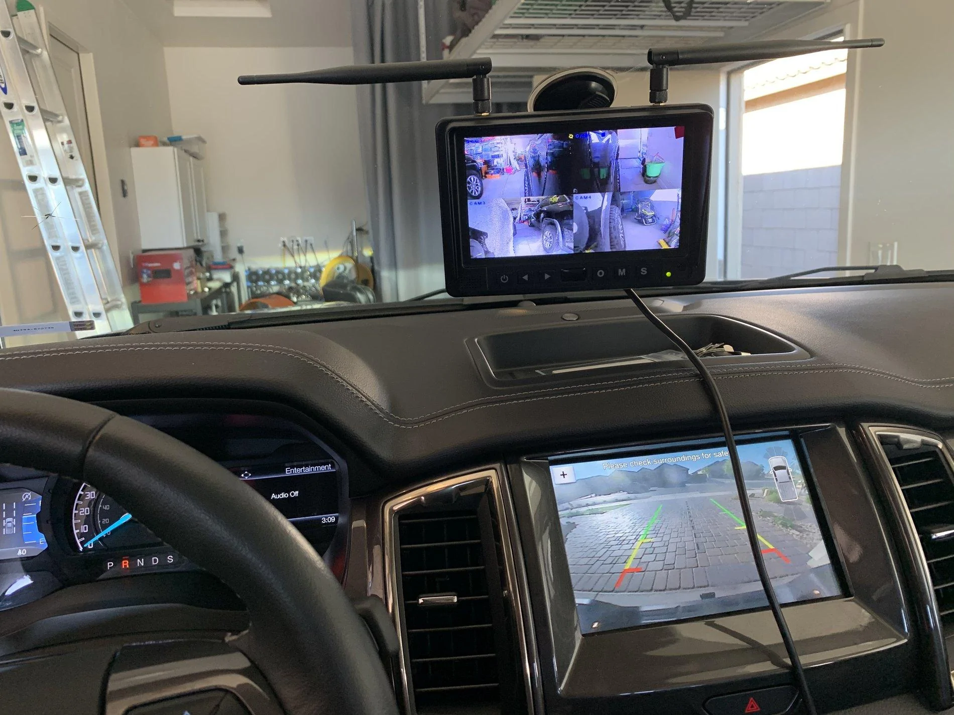

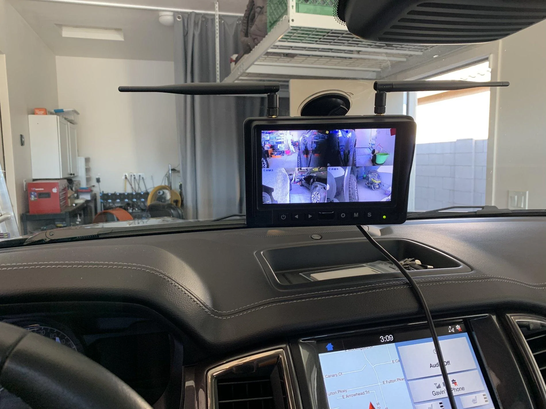

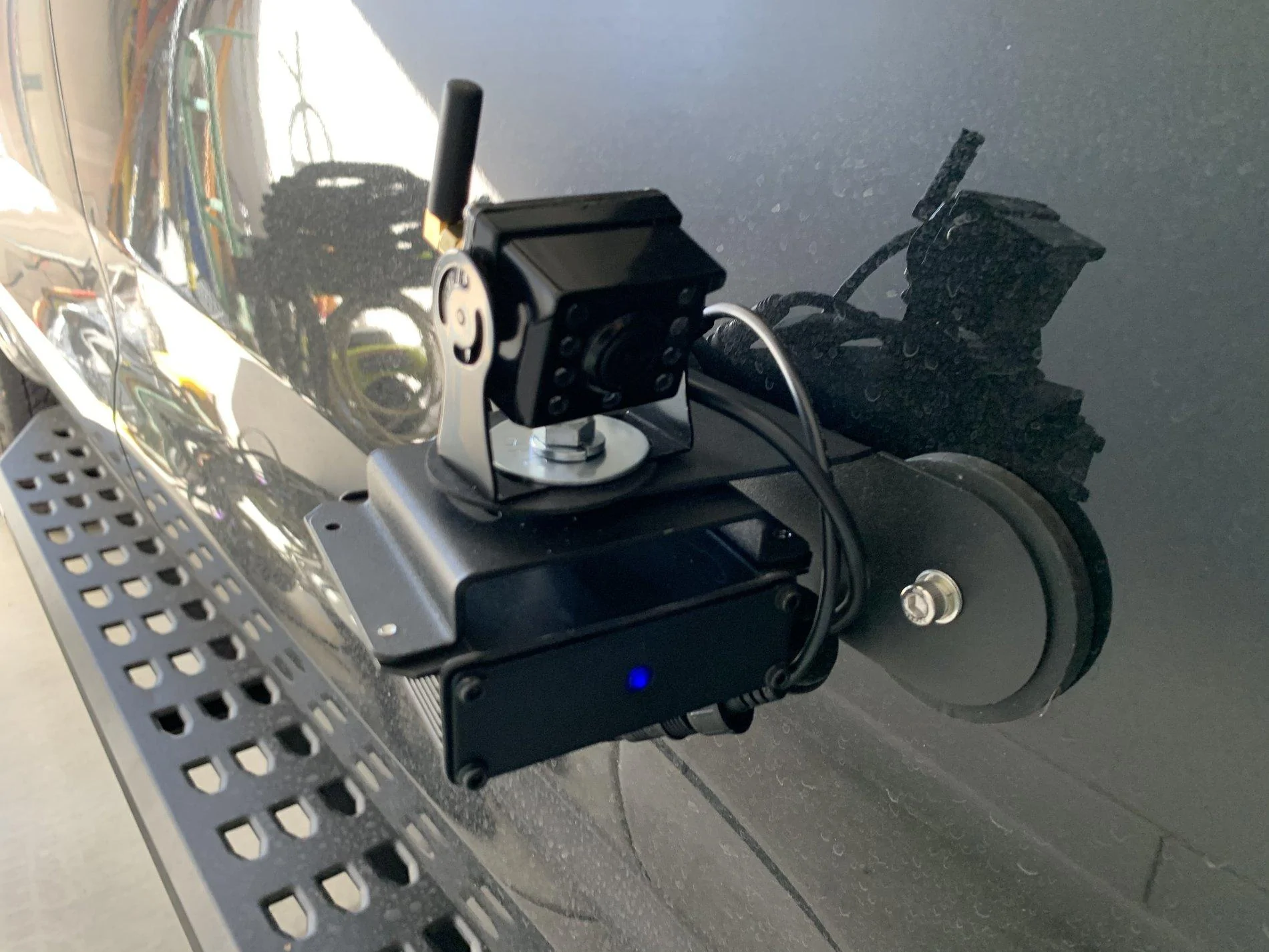

I took my Ranger out 4x4ing.. I felt I was a bit timid. New truck and all, didn’t want to hurt it and you can’t see the rocks! I ended up hitting a pretty big rock, bent my muffler into my fender.
I decided to solve the I can’t see problem with some tech! I just want to see my tires!
problem solved!! A bit much, I know... that’s just how I roll :)

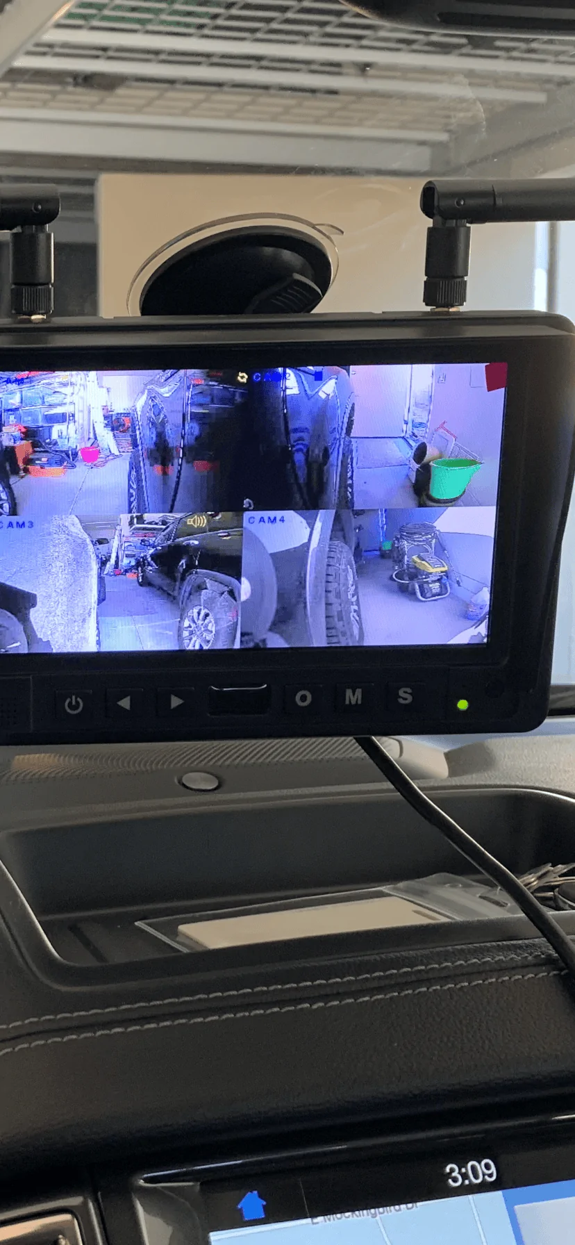

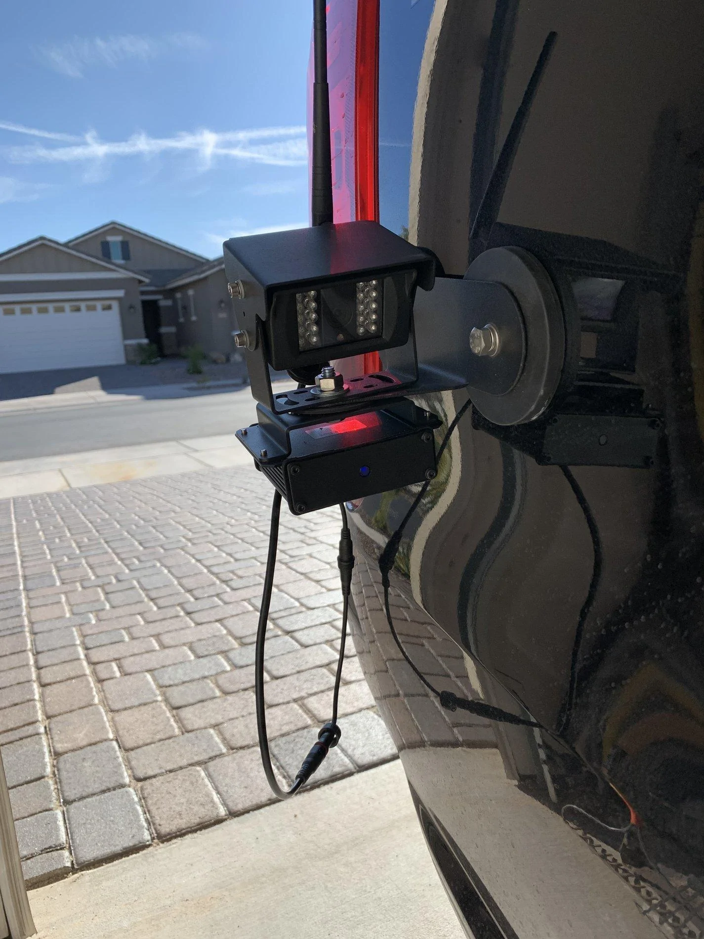

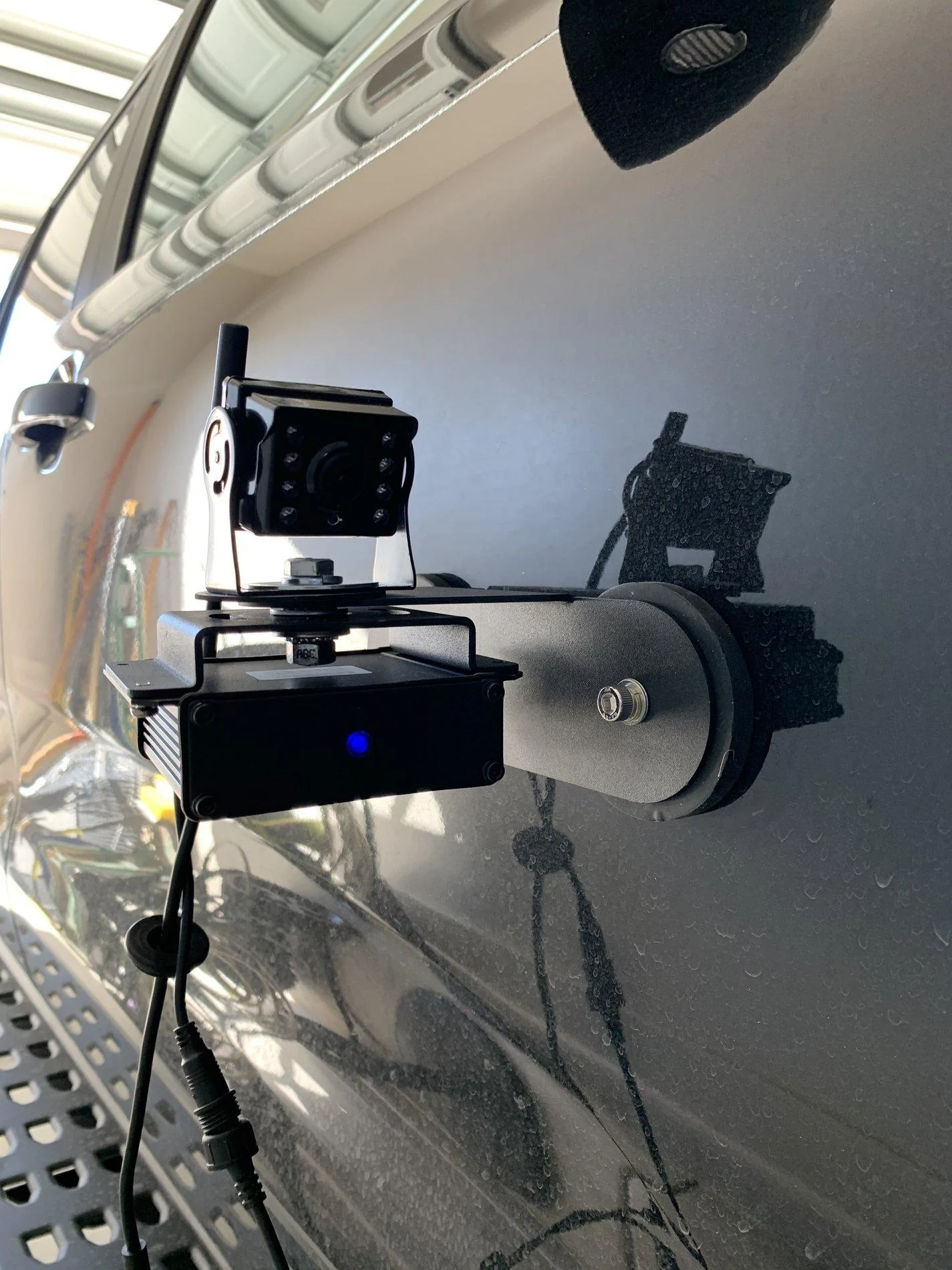

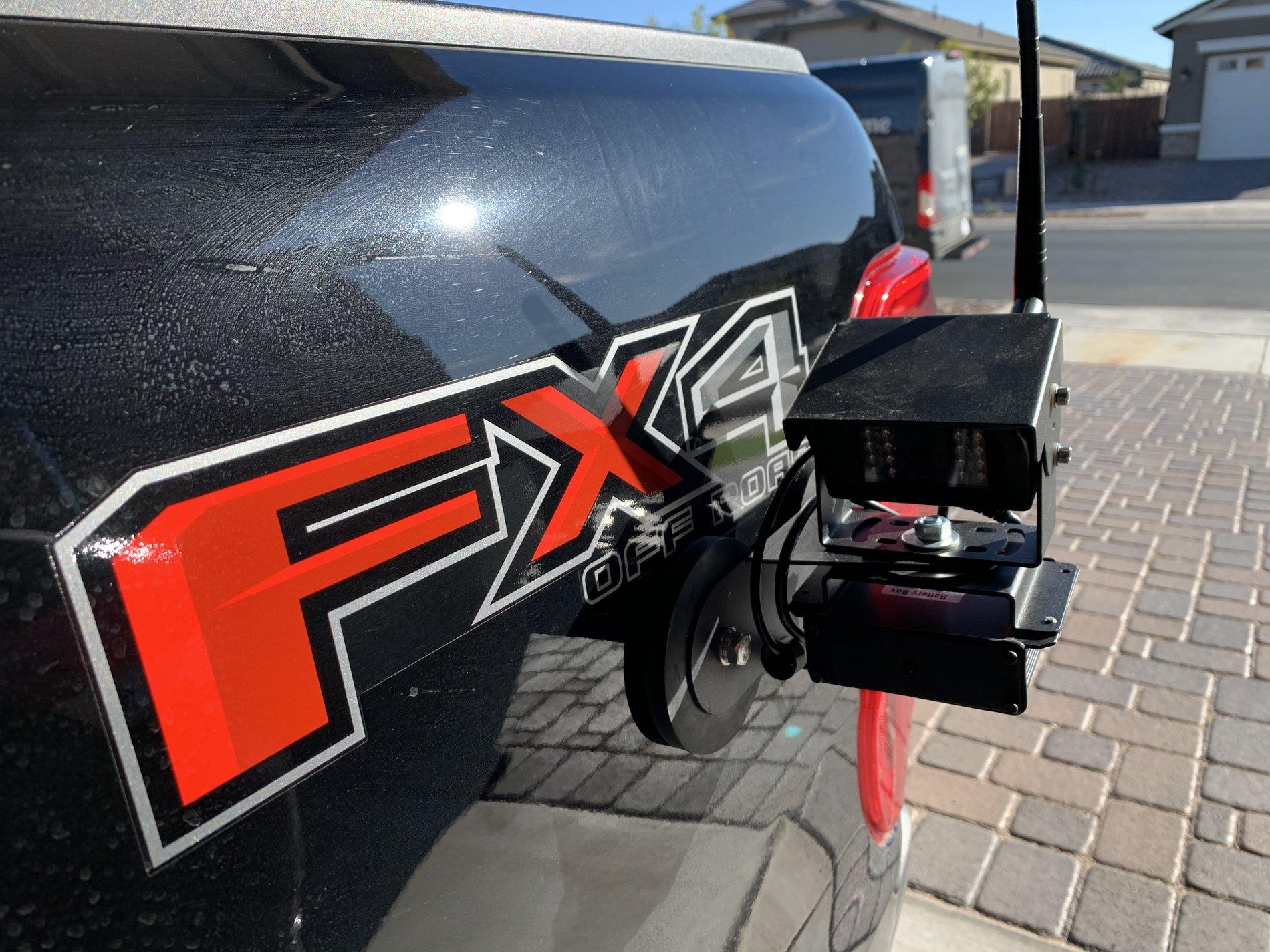

No, I wanted at least 2 cameras, that can stream live video to the cab. It doesn’t really work with a GoPro..
I tried a bunch of different cameras, my requirements were;
real time, high quality video (no lagging)
Temporary mounting solution.
No wires...
don’t want to use my phone.
It’s actually a pretty tough bill. I went through a bunch of different cameras. The nice parts about the ones I settled on is... BAM, they are on.. no messing around with WiFi, Bluetooth crap.
I think one of the wireless cams took me like 10 mins to get it all working with my phone.. not the experience I was looking for.
it works pretty well, I gotta take it out now and try to knock the cameras off.
