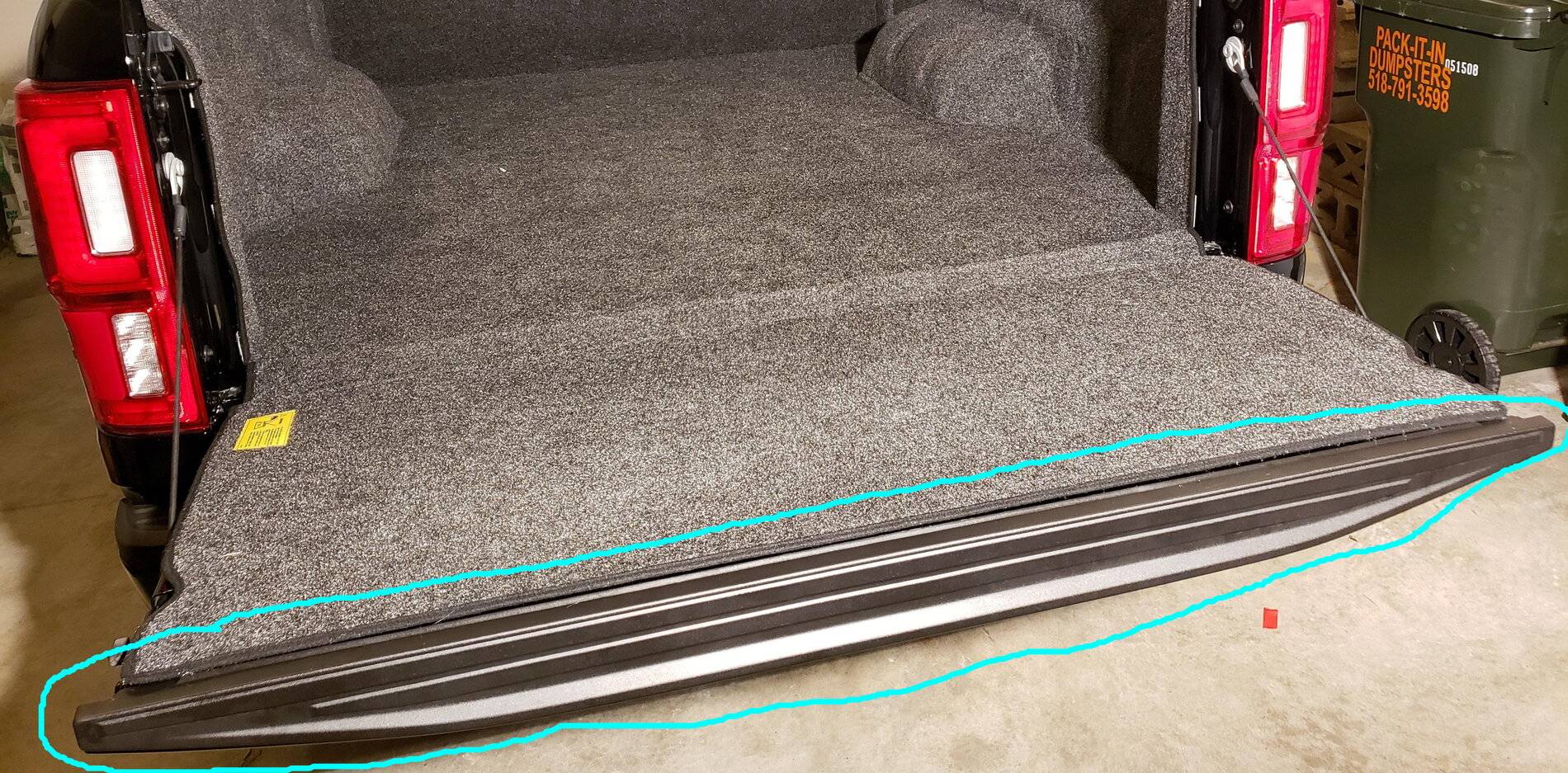

Hi,
I am looking for the part number of this plastic piece that goes on top of the tailgate, attached picture is circled. I suck at looking it up online. Thank you in advance!!

Thanks... That's cheap. Ended up putting a large noticable scratch from a mile away on it, thanks to a clown at Lowes loading water heater in truck...

.... I am sorry to bother you guys again.... is there any instruction on how to remove the part?

I had to take it off of mine when I had my tailgate repainted when it got gouged. I had to take off the latch mechanism access plate that is held in place by a bunch of torx screws. With it removed you'll be able to see retaining tabs on the bottom of the molding piece. I used needle nose pliers (both regular and 90* bent) to squeeze them together while prying at the molding with a trim tool. It was pretty difficult to get at a couple of the tabs on the outer edges and probably took me a little over an hour to get it off.

With my luck i'll be scratching paint and make it all worse. TY for info.
