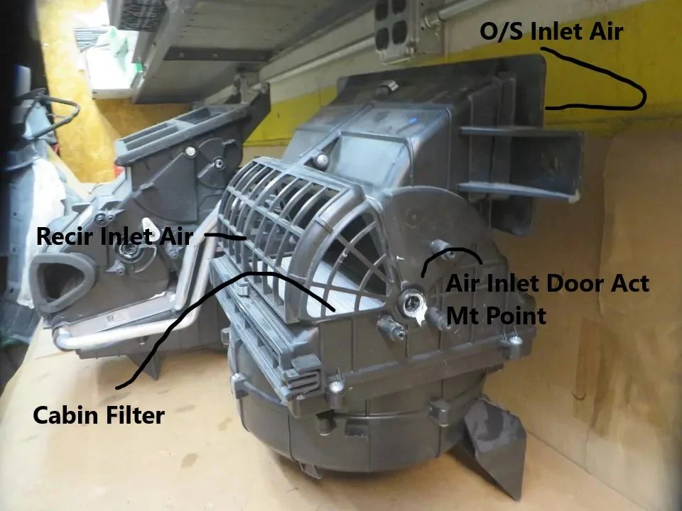

Drop the Glovebox down as if you are going to replace the cabin filter.
Turn off the truck and watch - The Air Inlet Door (Rock Back & Forth)
Only 2 - Doors cycle with Ignition cycled to off, Mode (Vent Position) & the Air Inlet door.
The actuator has lost position, can try open and clean or replace.
Plus ensure a Mouse has not brought in debris for bedding and its blocking the door movement.
So - Normal ops - when truck is shut off this door cycles to partially open (venting) Evap Core and it stops, since it cannot find correct position it continues to try to drive it to position, this is the sound you are hearing (rocking back and forth)

Do I pull the filter out?
This actuator, where is it? Can I access it pretty easy?
Any idea on the part number?
Would it be obvious to see mice intrusion?
