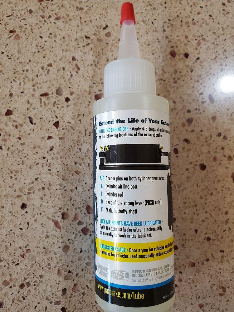

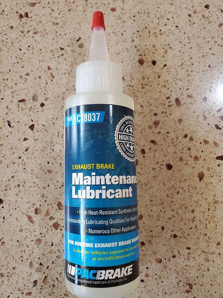

Hi Folks,
You might try this Extreme High Temp Lube that I use on my RV CAT Engine Turbo's exhaust brake (not a Jake Brake!).
www.pacbrake.com/lube
Phil Schilke
Ranger Vehicle Engineering
Ford Motor Co. Retired
