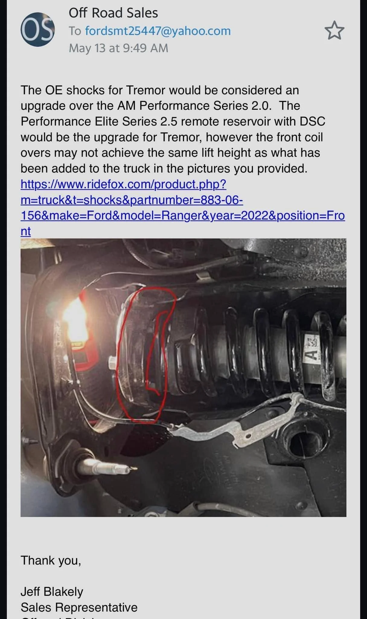

I emailed Fox about this. The stock Fox shocks on the Tremor are better than the 2.0. If you wanted better shocks than we already have they would be the Fox 2.5. See my attached email
I think talked to same sales guy on a 4Wheel show in Ontario CA about 1.5 years ago. I learned then that all the shocks designers/manufacturers are here in SoCal. I was looking for a shocks that could accommodate a lift up to 3.5 inch and Fox said that they don't have any, I pointed out that we are standing next to a Ranger with BDS lifted to 6 inch on a 35s tires. He was like I'm here to look at how it was possible for BDS to do this lift. He told me just use Fox 2.0 and wait out cause they are developing Fox 2.5 or even Fox 3.5 and might be able to adjuste it while it is loaded. He mentioned about waiting till 6G Ranger comes out with the Raptor.
