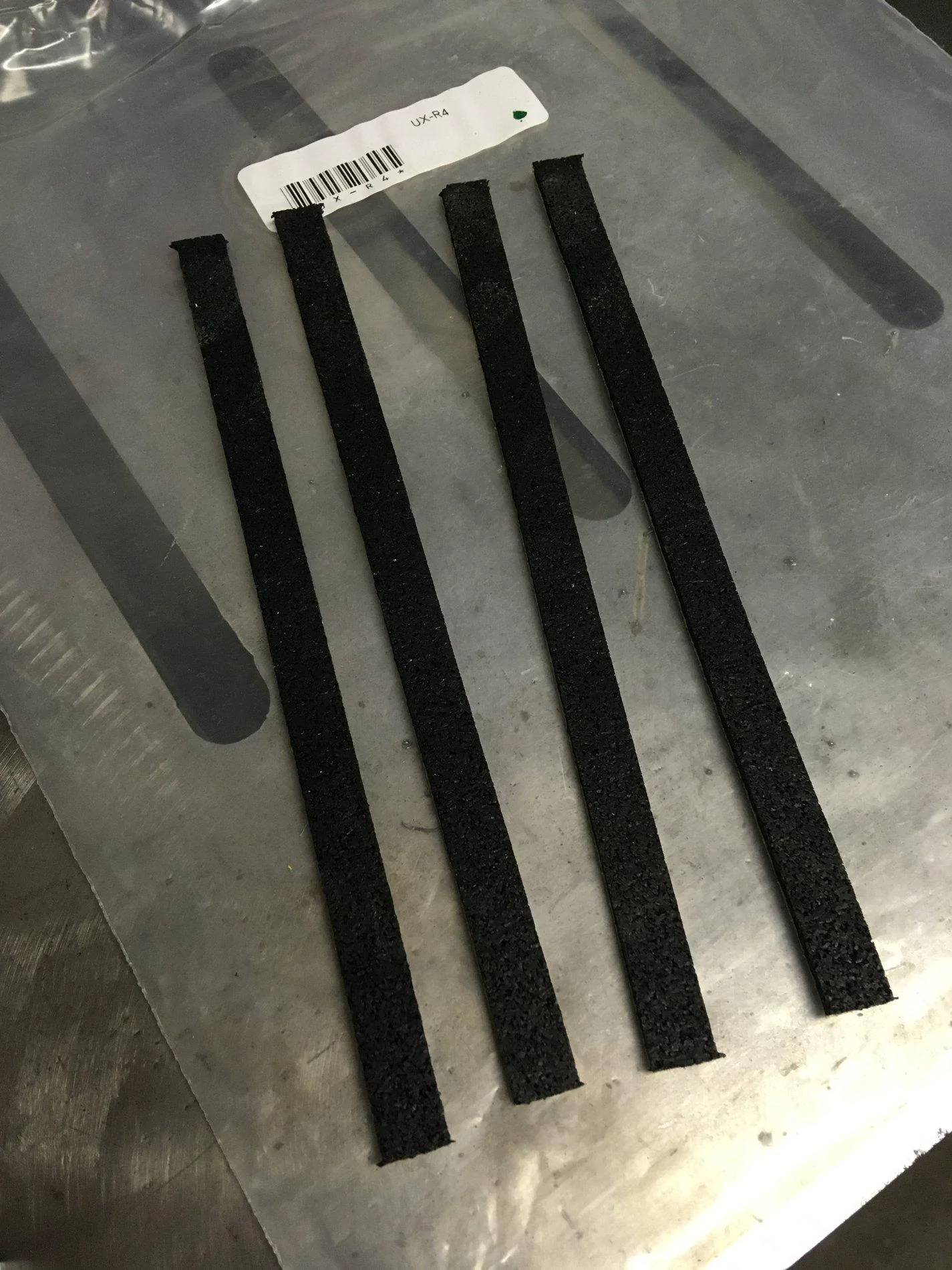

It didn’t want to stay stuck to the liner.
I am going to try a FIY Bulkhead Rail for the UnderCover Ultra Flex similar to the Bakflip ones. It should not be more than around $25
  1. Aluminum angle 1.5"x1.5x70 (bed is about 65") $20 https://www.homedepot.com/p/Everbil...ERCH=REC-_-pipsem-_-204273998-_-204273989-_-N
  2. 2x Expansion or Well Nut #10-32 x 1-1/16inch $1.05 https://www.homedepot.com/p/Everbilt-10-32-x-1-1-16-in-Brass-Expansion-Nut-814368/204275921
  3. 4x washers (for over expansion nut). D=3/4" d=3/8
  4. 2x #10-32 x 1-1/2" machine Screw $1
  5. 2x fender washers for machine screw
I will stick the seal straight into the angle and paint the rest black enamel.
Drill the 1/2" holes and mount it flat on the spray liner. Not raised like the Backflip.
