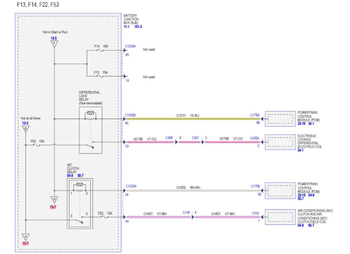

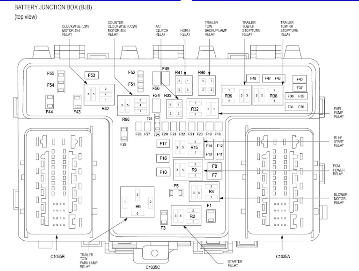

Want to install some Raptor style grill lights but want them to be lit when ever the truck is running.. I know about the ones. Custom Autoworks.sells but they are a little small and are a little lost during daylight.
Where to hook up under hood?
It looks like F14 in the BJB (battery junction box) would be a good candidate.
