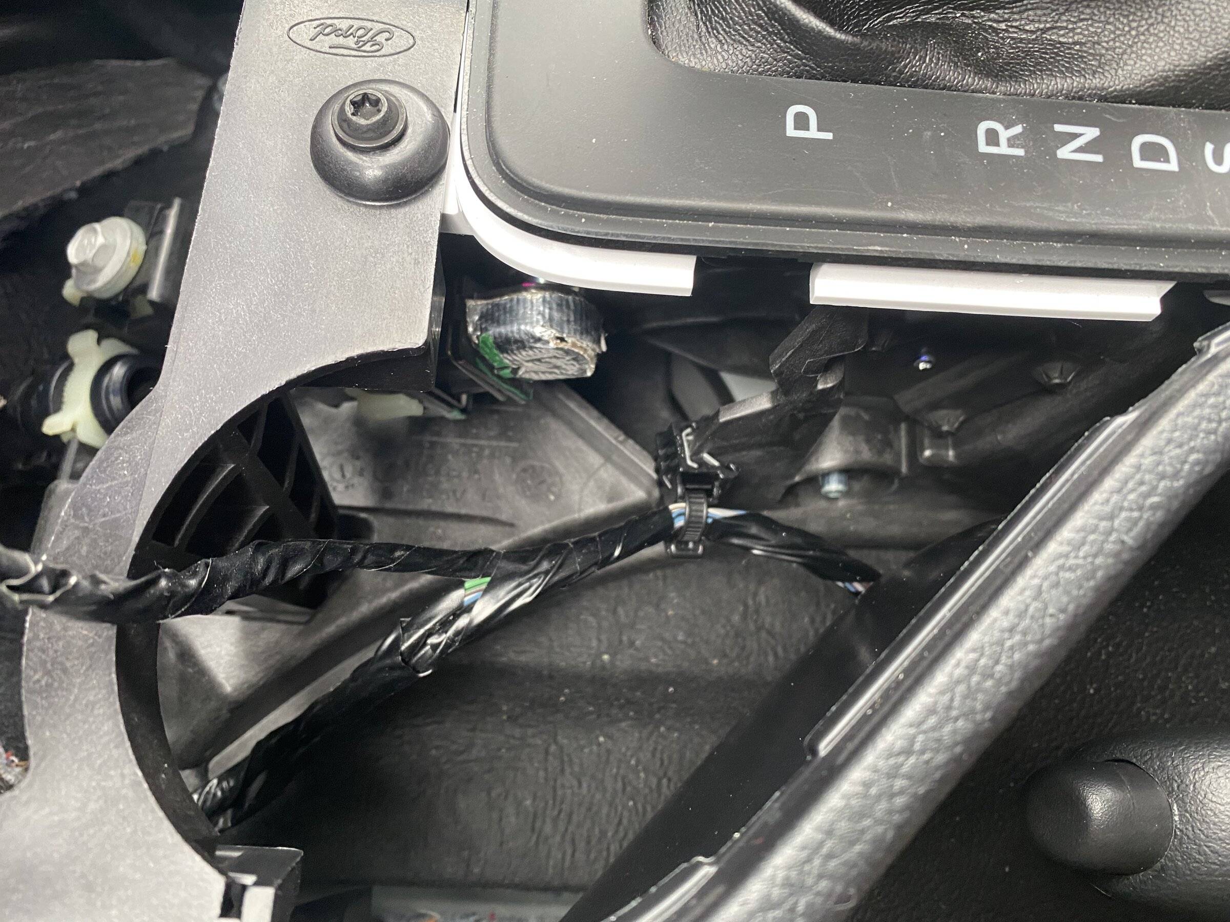

got a plan to install led's in my cup holders , how does the center console come apart ? been trying to find picture or a service manual,on this any Idea just don 't want to rip and break...

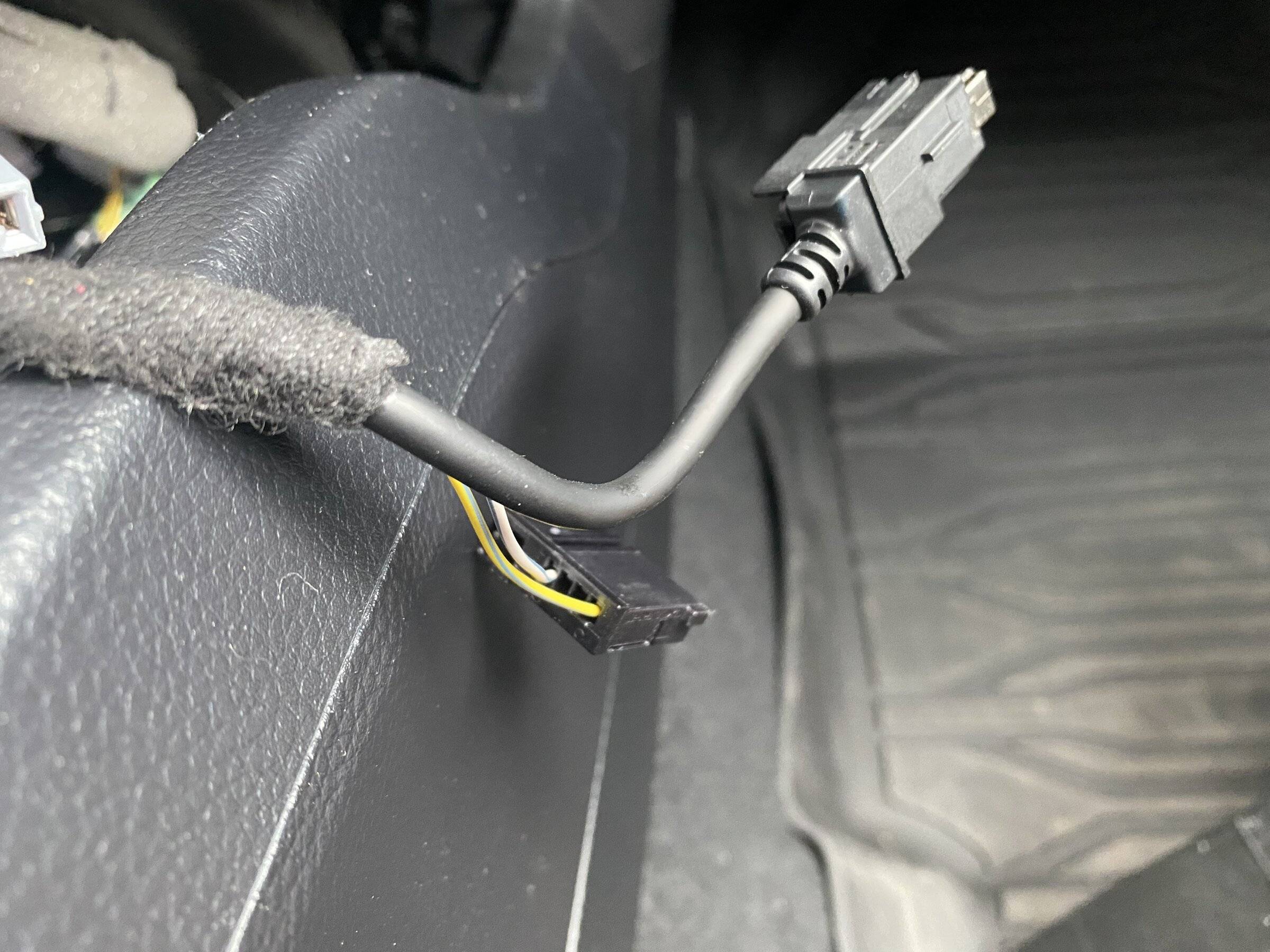

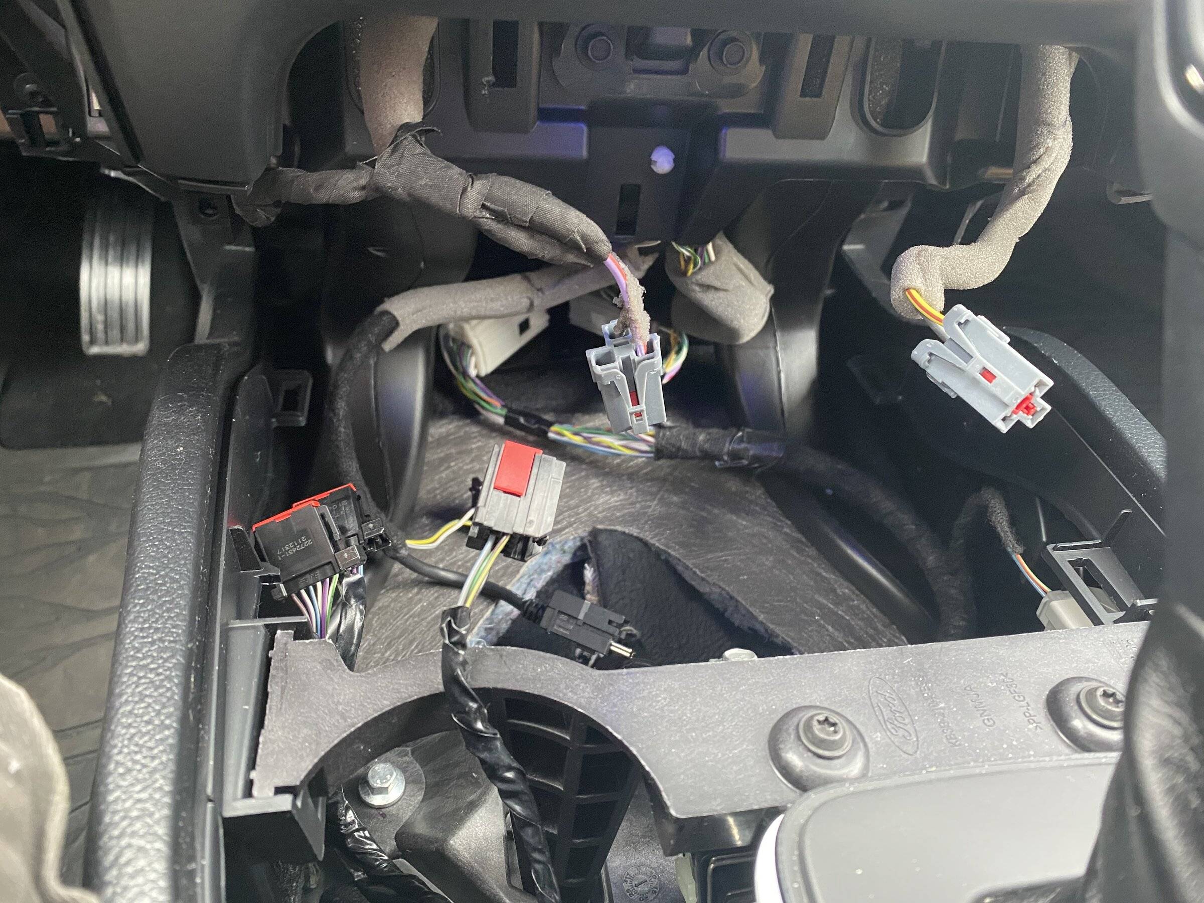

I’ve gone as far as removing the large piece around the shifter and includes the front cubby. It does just pull up around the shifter, disconnect the 4x4 knob and switch panel harnesses, pull the trim towards you, disconnect the USB and lighting.
