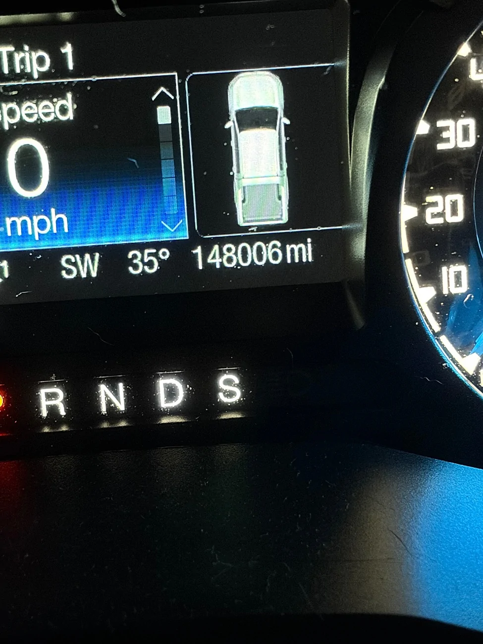

Not the first problem to date.
Of course I probably just jinxed myself. It will die on the way home.
2021 five years old next month.
Has had every single maintenance recommended every 5000 miles.

Honestly, that's really good!
2021 here, 134k. Rebuilt trans, then replaced trans (warranty), new HVAC box, rebuilt rear end.
Just checked my original brake pads, and they're only halfway through!
