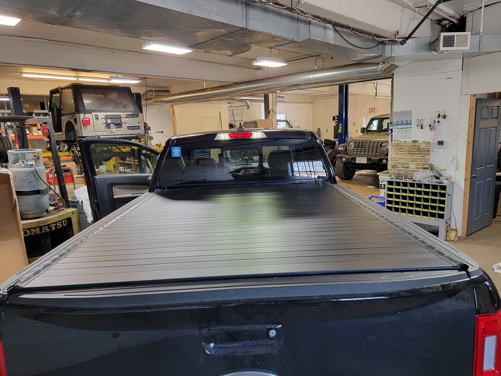

I got the cover installed today and here is my review of it, along with some other observations.

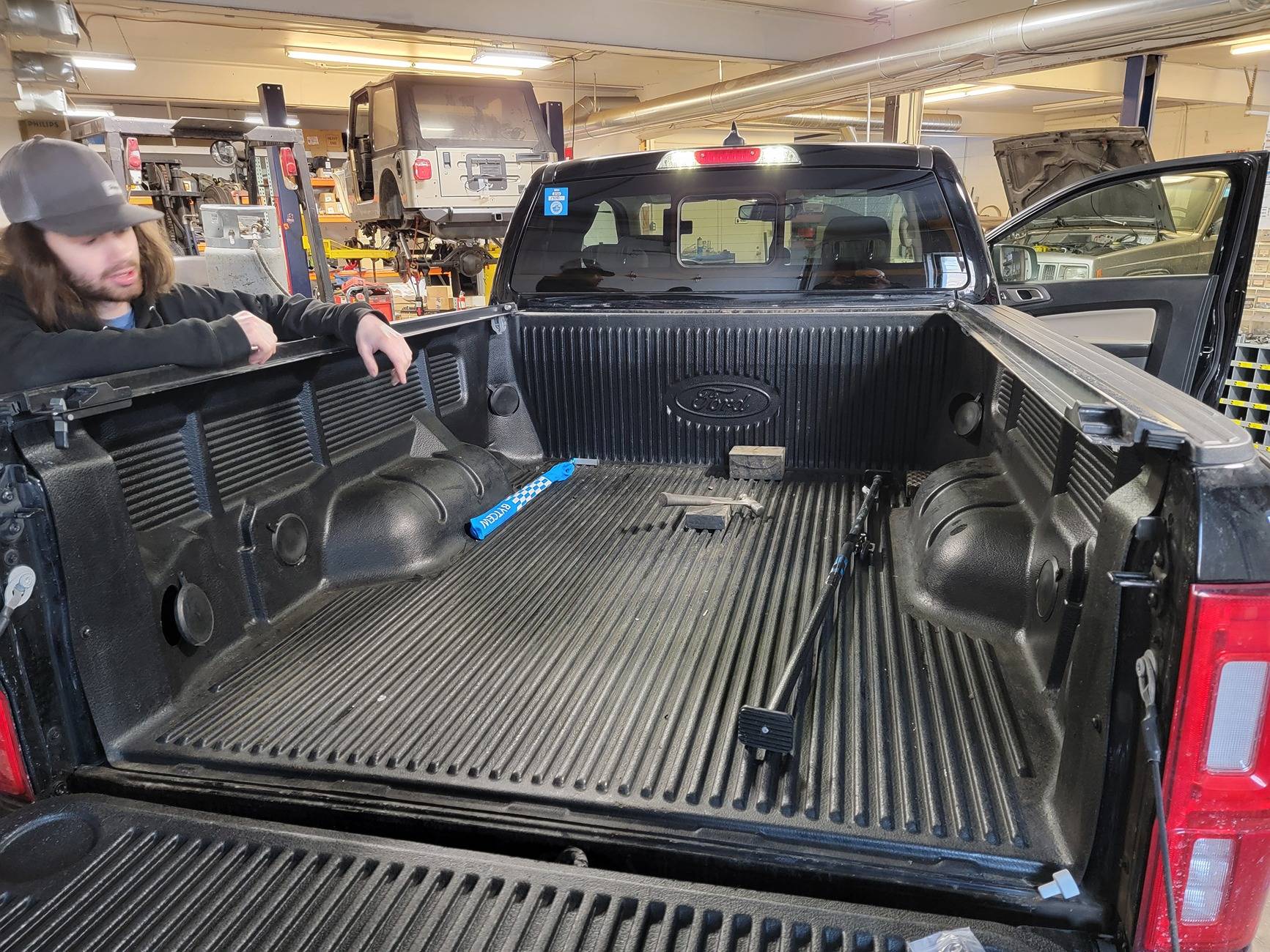

This was our starting point (Ford drop-in liner and Truxedo Lo Pro soft rollup that's been partially removed already):

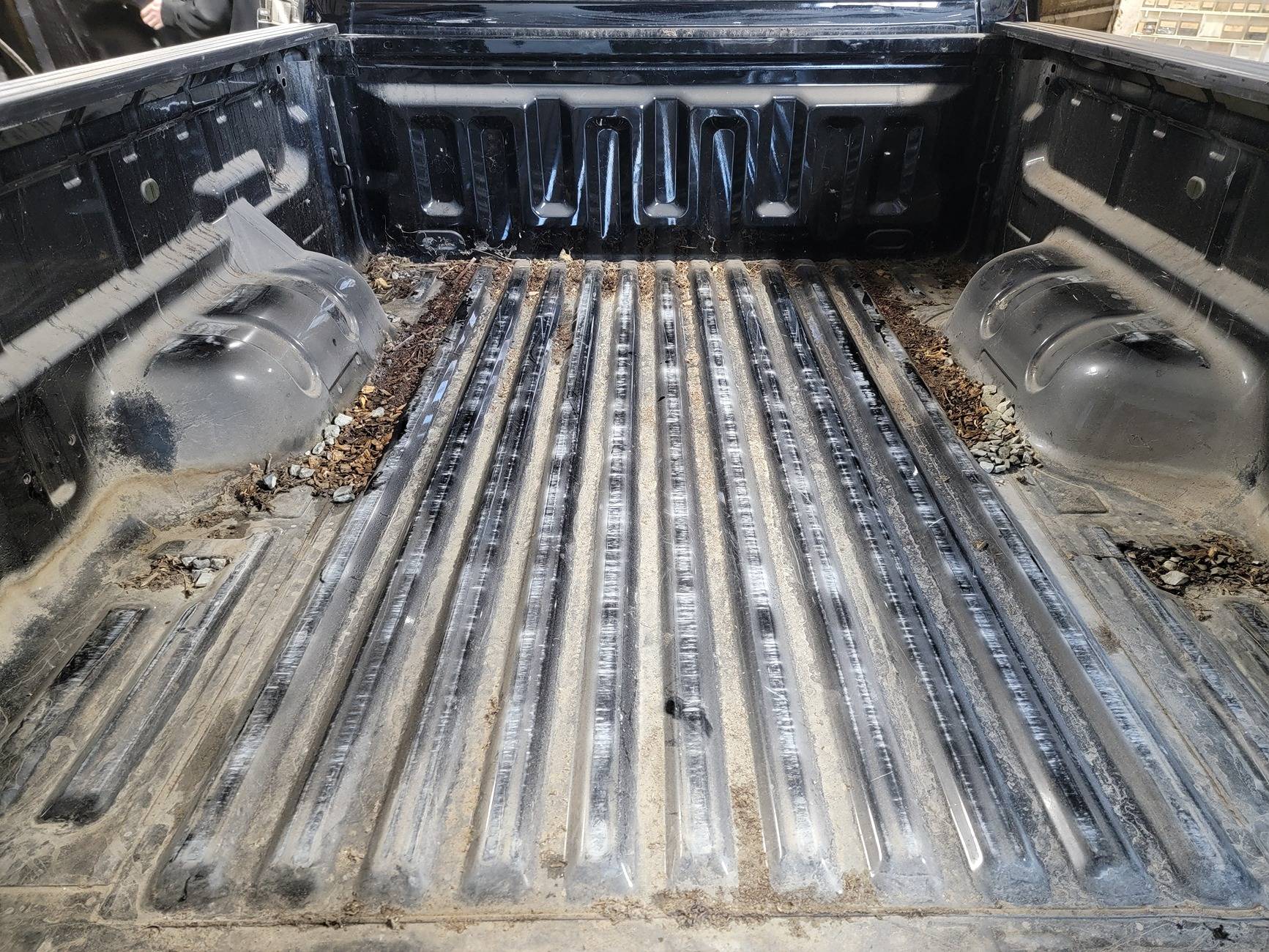

Here is what the bed on my 2020 Ranger looks like after only 4-5 years with a drop-in liner:

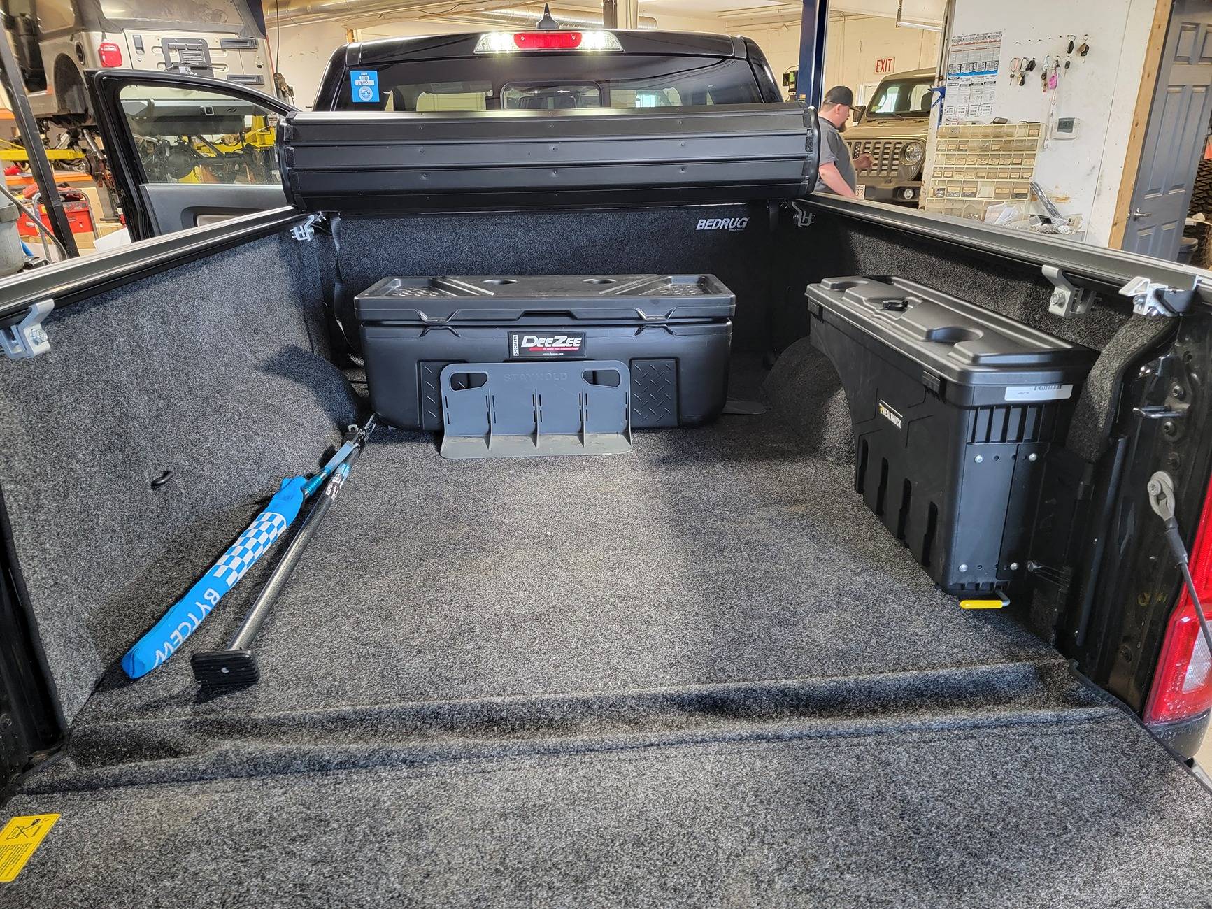

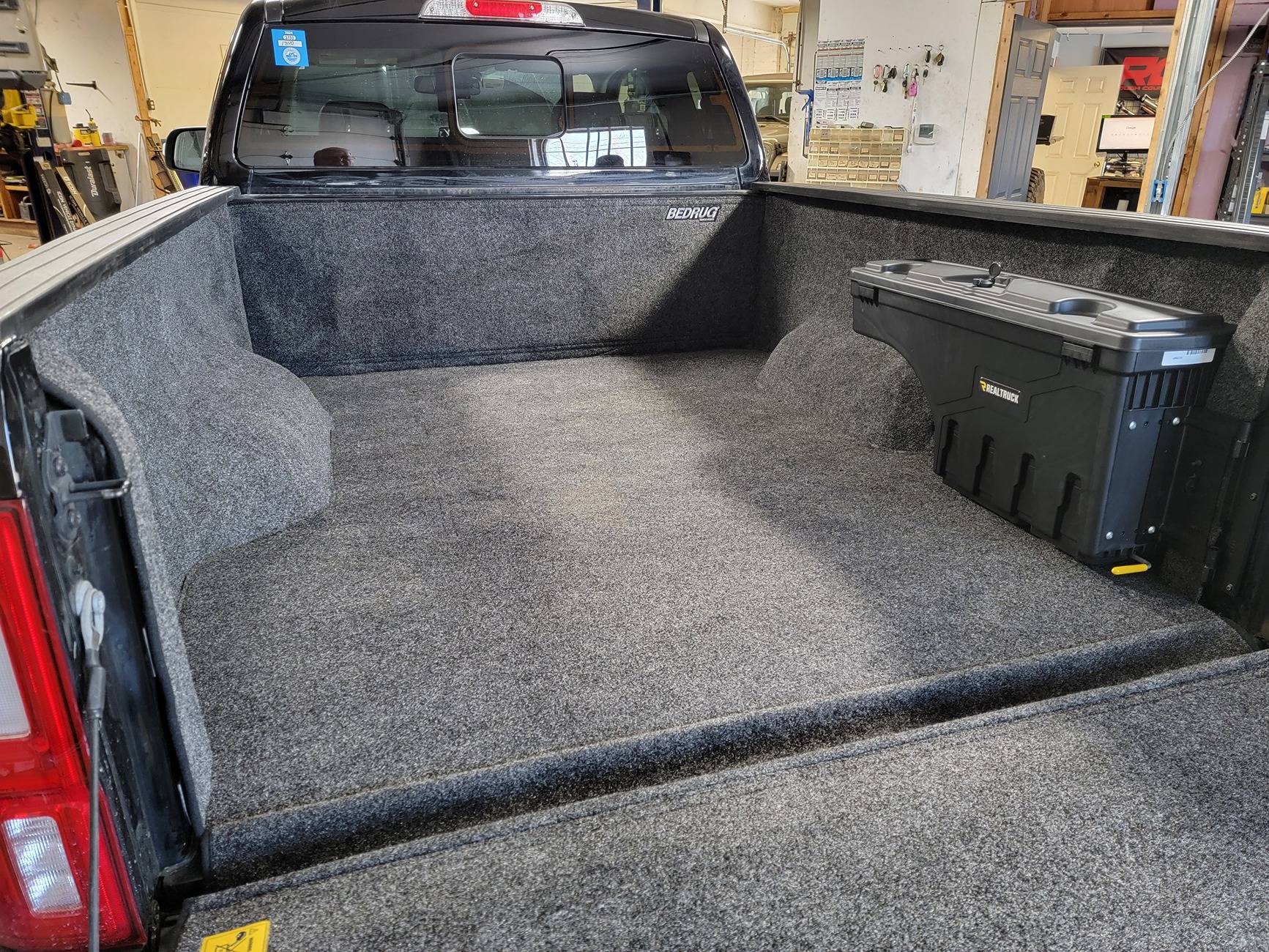

The first order of business was to install the BedRug replacement liner and the RealTruck swing case:

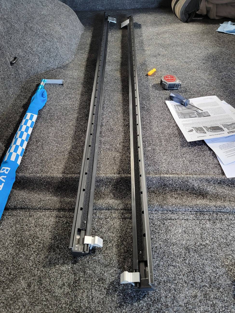

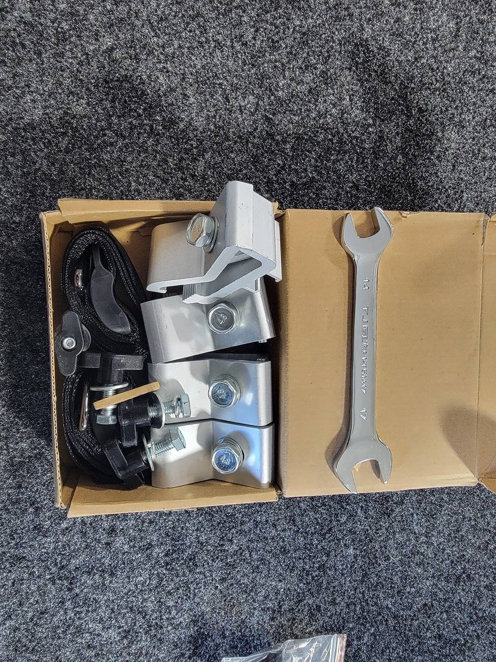

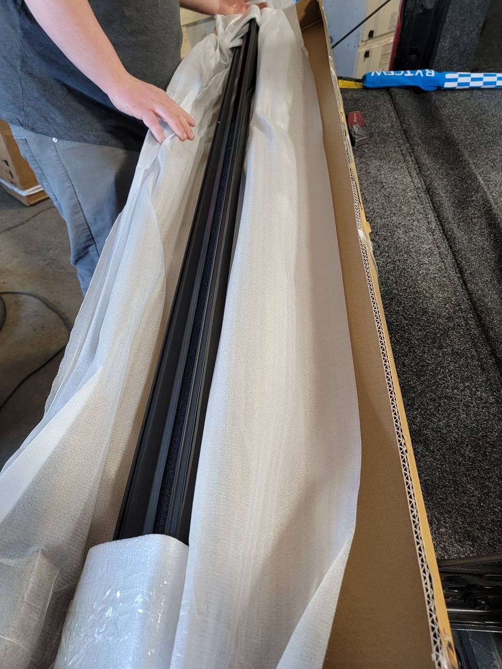

Next came the hard rollup tonneau cover from eBay. The following pictures show the components and packaging, which all looked like quality items. The contents even included a 14/17mm wrench that wasn't a throw-away tool as so many of these things are.

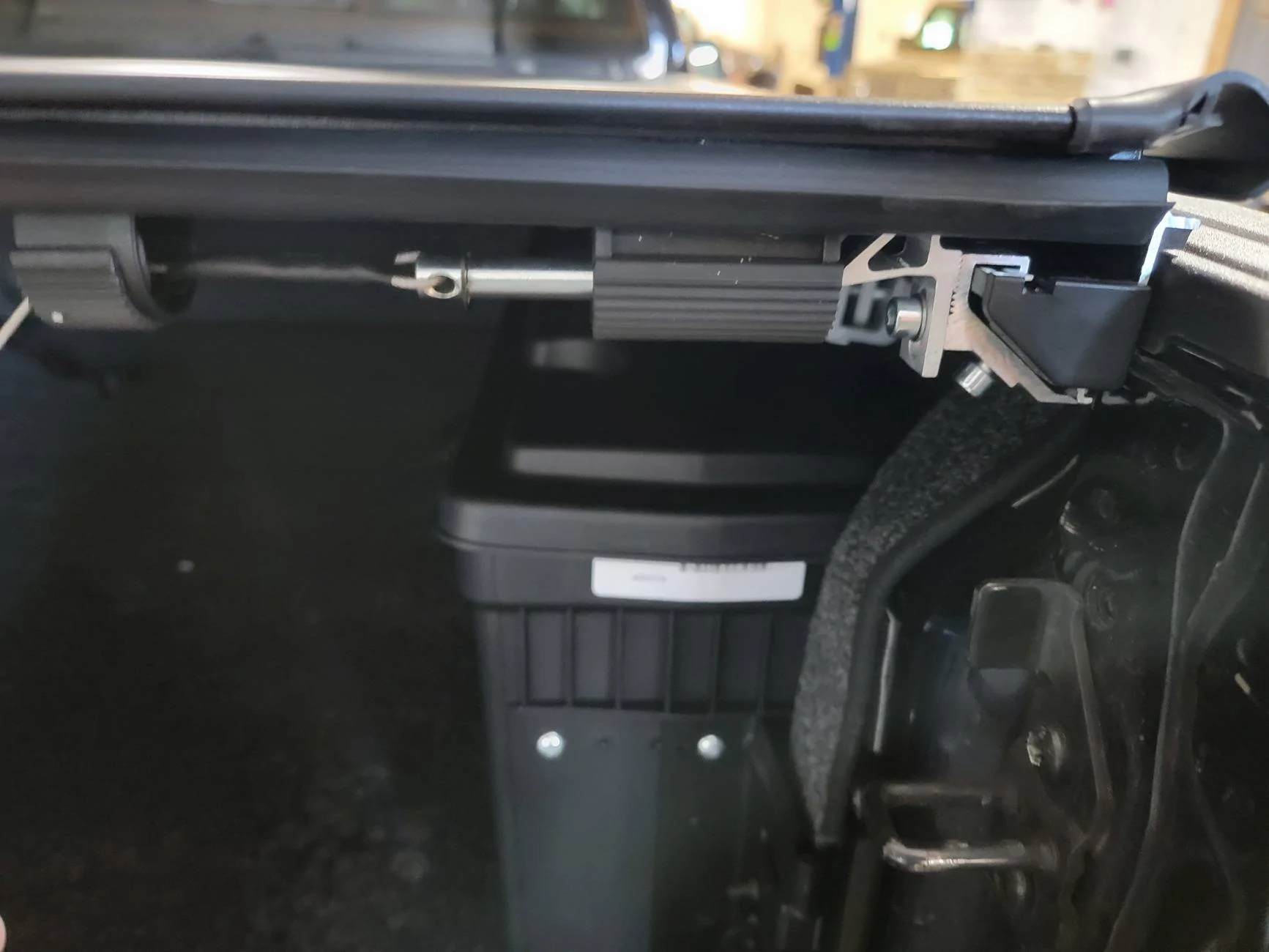

The picture below shows the latching system. The latch itself is adjustable and seems to be a quality component. My former techs were impressed with the overall quality and felt it exceeded both Truxedo and BAK Industries.

I paid $569.00 for this cover (it's now up to $642) on eBay and consider it equivalent in design and build quality to any of the major brand covers. Of course, time will tell as to durability but the prognosis is favorable.

After he reinstalled the cover, I couldn't get it to latch unless I pulled the wire down while closing the cover. I took the truck back over to Corey. We discovered that the latch rod, which is supposed to slide down the fixed piece attached to the rail, was now misaligned. Instead of sliding down the sloped portion o the latch and then popping back under it to complete the latch, it was hitting the top of the sloped section and stopping. Pulling the latch wire allowed it to slide down and complete the latch.
It looks like the sloped piece is soft metal and the attempts to latch it without pulling the wire may have bent the sloped piece, causing further misalignment.
We fixed it basically by shimming the latch rod with a zip tie on the rod between the wire attachment and the black sleeve it moves through. That keeps the rod far enough back to hit the slope and slide down it with enough movement still available to pop out underneath and latch securely.
