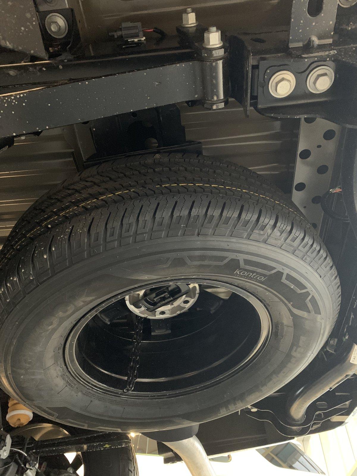

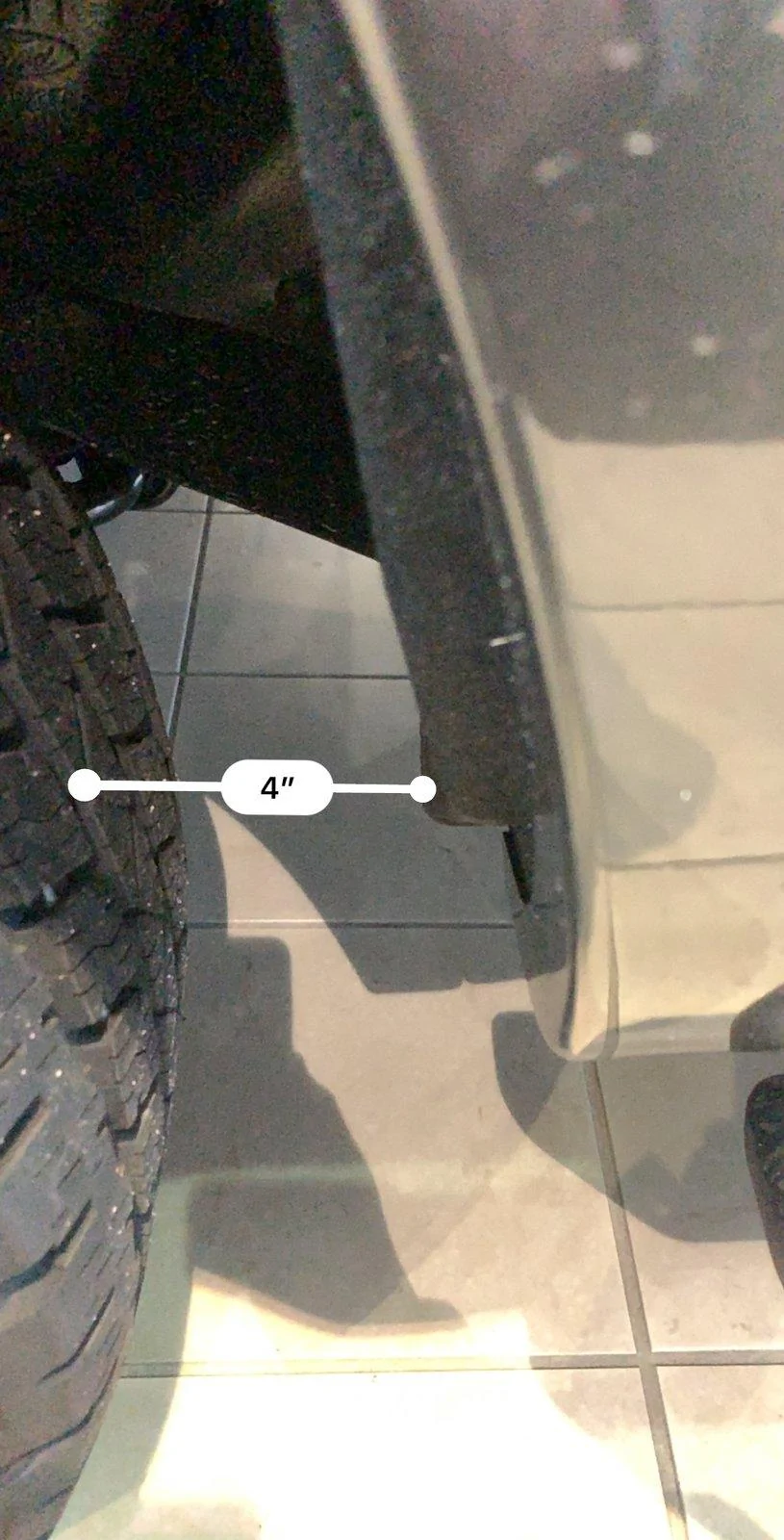

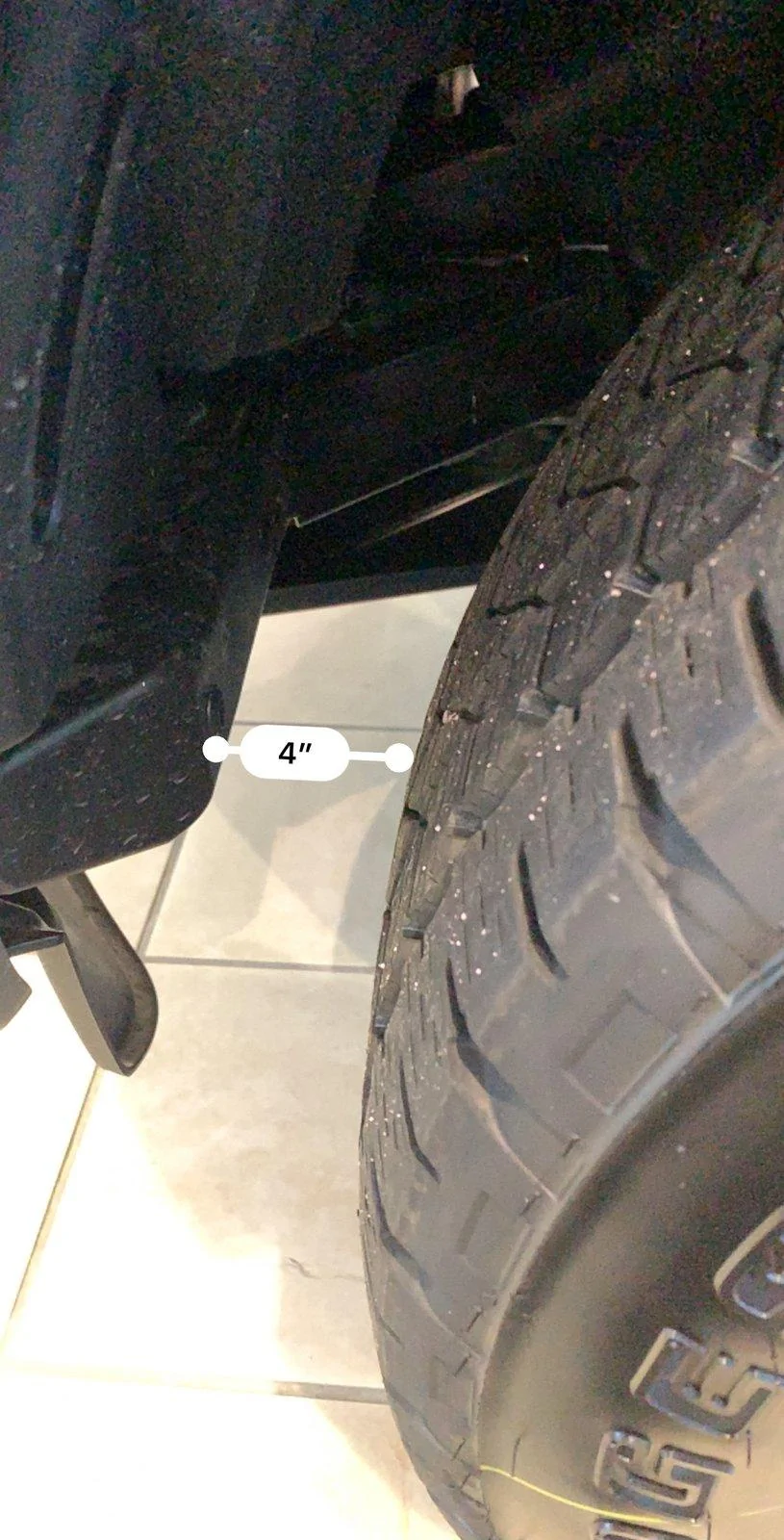

I’m not sure if this helps but I took a photo using the measurement app! Looks like a bunch of space from tire to wheel well, also plenty of space for a larger spare
Good pics - the big concern is @ full lock that clearance goes way down.
I think up one size from 65 to 70 is doable, I'd be hesitant to go much beyond that with stock setup but I think it would work.
