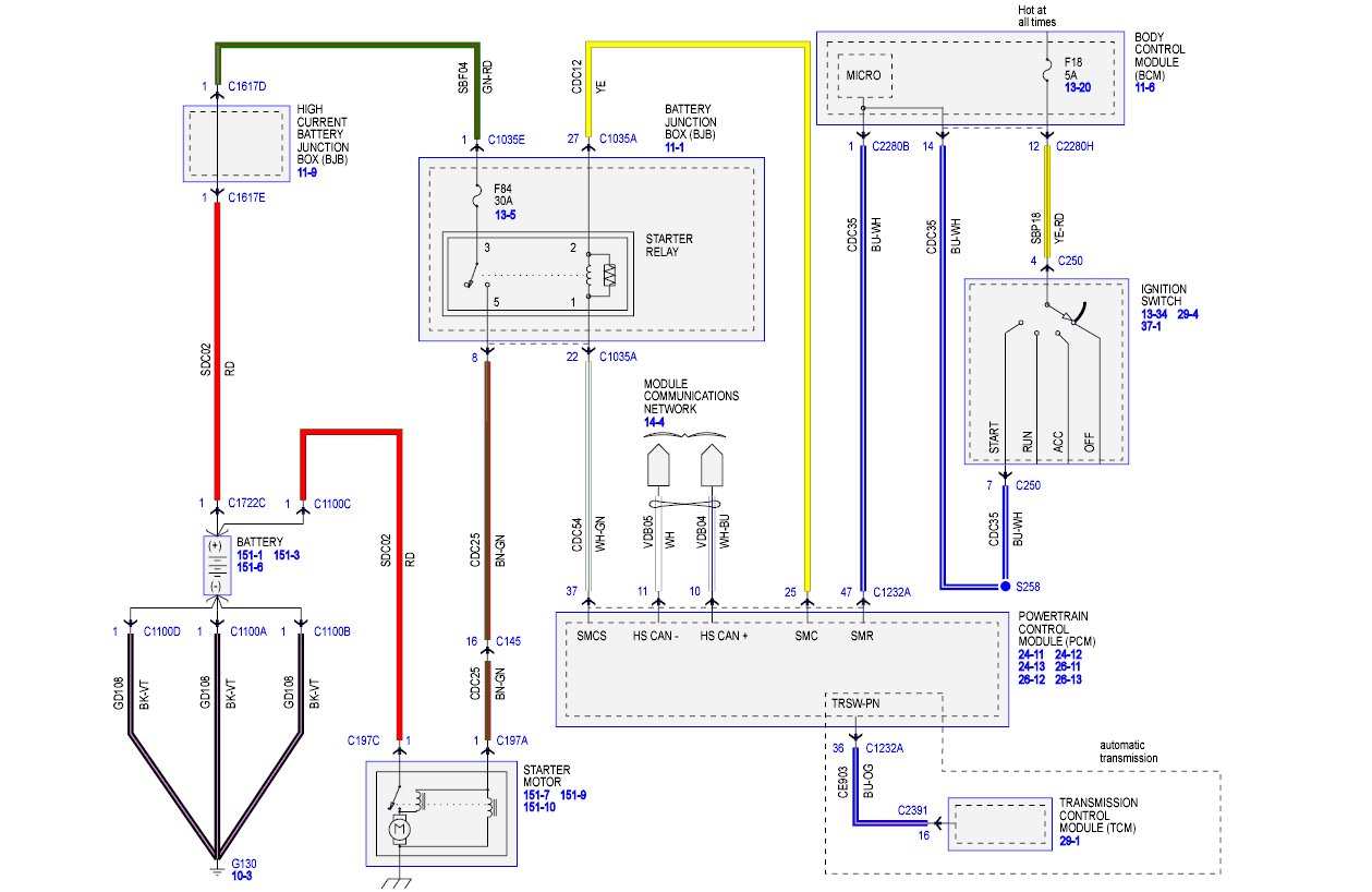

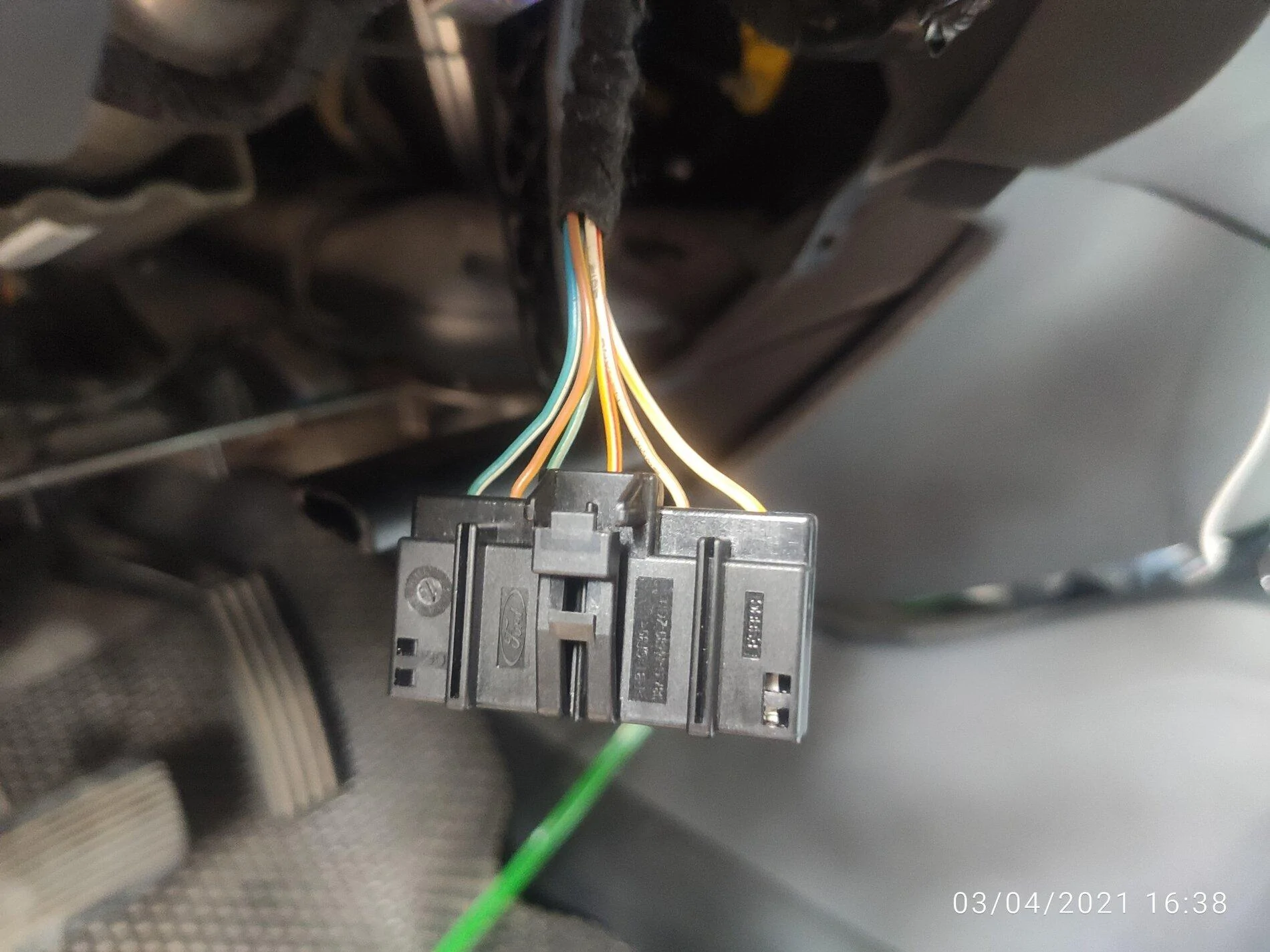

Dear Bro, please help me the wiring diagram of Ford Ranger Wildtrak 3.2L 2016, i need to replace the original key to the smart key, special is starting system, i had tried to find out but have only "Ford Ranger PX Mk II Workshop Manual & Wiring Diagrams cardiagn.com". This is not same. in this, the cosse has 6 wire, but in wiring diagram has 4 only. Please help me to clear my brain of obstruction. Thank you so much!
